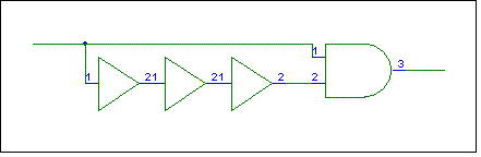

I am testing my Prototype using 100nS deadtime , IR2110 , IRF540N with Full Bridge-Class-BD Trilevel modulation and i will post the photos too. Besides this i also want to look at PABO's amp also.

Hi Charles Nice to see u too.
So whats ur suggestion on implementing the deadtime circuit choices. Secondly u mentioned about the reactive loads which are easily driven by class-D amps than class-AB.PLZ CommenT

The following is easily done in CMOS but a little unpredictable.
Regards
Charles
...hm, during my last examination I came to the conclusion that adjusting the dead time with an RC-RD circuit for the gate drive is pretty fine. This allows to adjust the dead time with quite acceptable thermal drift and further on the external gate-source capacitor allows to control the dead time and also di/dt commutation speed as well. Furtheron it is providing a low hf gate drive impedance, which is reducing trouble from the MosFet's parasitic drain-gate-capacity.
