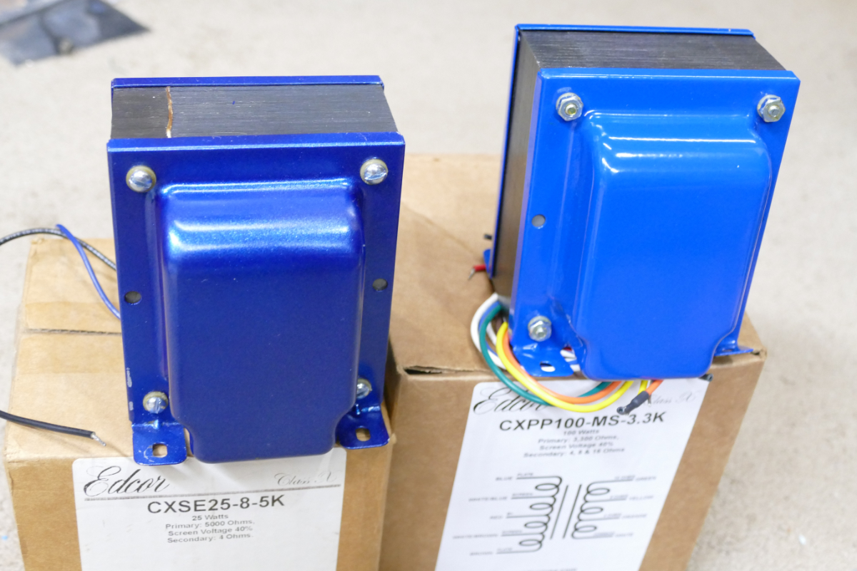

The current Edcor blue is the second edition. Here are two Edcor Blue transformers. One is a couple years old. The other is from 2006. Back then I stated that it was a near match for the "pimp my ride" Cadillac that boomed, rattled and bounced its way through our neighborhood at the time. Apparently other customers had the same reaction so the glowing metallic blue was turned down a bit.
Note that my 2006 vintage transformers spent several years on the chassis of a TSE based 307A amp. The original sparkle and shine has faded a bit. Perhaps some car polish and wax could restore the brilliance. Boom - Bumpa - Bumpa - Boom - Bumpa - Bumpa - Boom......

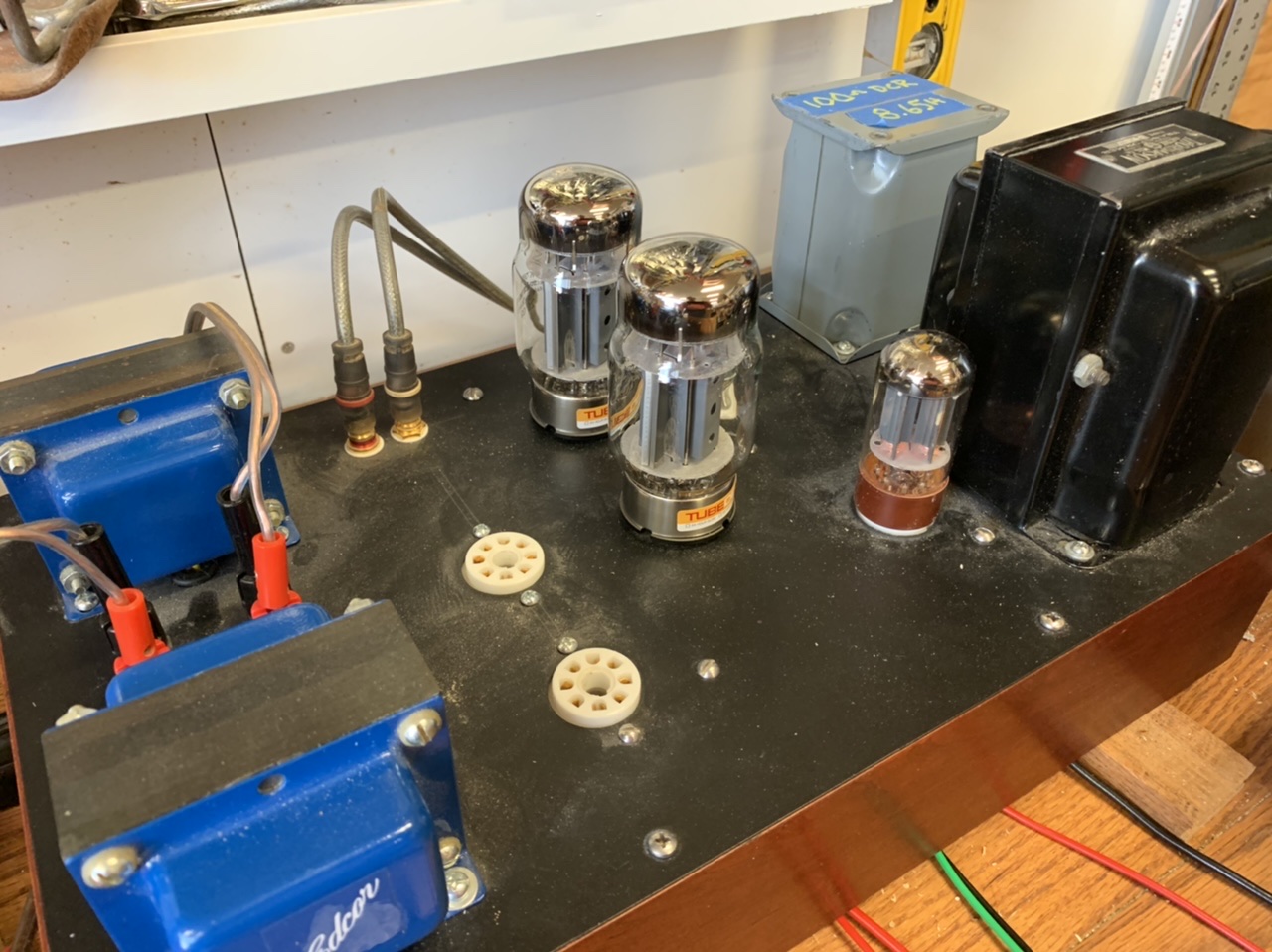

Electro Harmonix KT88s at 111.111mA bias
The EH KT88s arrived with a couple of 5AR4s from behind the Iron Curtain. Slapped some UF4077s on the RED HT leads (the “Dynaco” mod; this old SSE board doesn’t have it), changed the Rk to 360 ohms, and plopped all the new thermionics in there.
I had forgotten the nice (indirect heater) slow voltage ramp of the 5AR4/GZ34s.
That’s nice. Plus no arcing, knock wood.
KT88s biased-up right on target: 111.111...milliamperes at 38W dissipation.
Sounds pretty good; the clarity of the lower registers is something I hadn’t heard from this SSE before. Pretty nice for a shop amp, and this with 5K EDCOR “G” opts (the mid-sized ones, ~$45 ea. now IIRC) running in Uktra-Linear. I like me some Ultra Linear; it’s just my thing...
Might swap-in some 5K Transcendars (although they’re in same weight class, so I don’t expect much change) or 3K Transcendars or HANDWOUNDS (!). Generally, I prefer the clarity (ie lower distortion) of the higher load...
What’s the prevailing preference on OPT loading for the KT88s in SE?
I have Joni “Blue” on there now (my reference “girl with guitar” tracks); for GWG music, anyway, I doubt that 3K could sound better.
Mind you, the source is Spotify Premium at 32bit/384K thru an outboard DAC (iFi Zen), which is likely overkill, but eliminates any doubts about the quality and consistency of the source.
Curiously, the ancient Thordarson 390-0-390 200mA PST is running pretty COOL with this set-up, that is, just warm, not hot.
6L6s (~80mA) or 6AV5s (~70mA) with 5U4GYBs would turn the PST into a pizza oven.
Also, the massive KT88 bottles seem to run pretty cool, too.
Maybe I’ll scrounge up the pyrometer and see what’s actually going-on.
