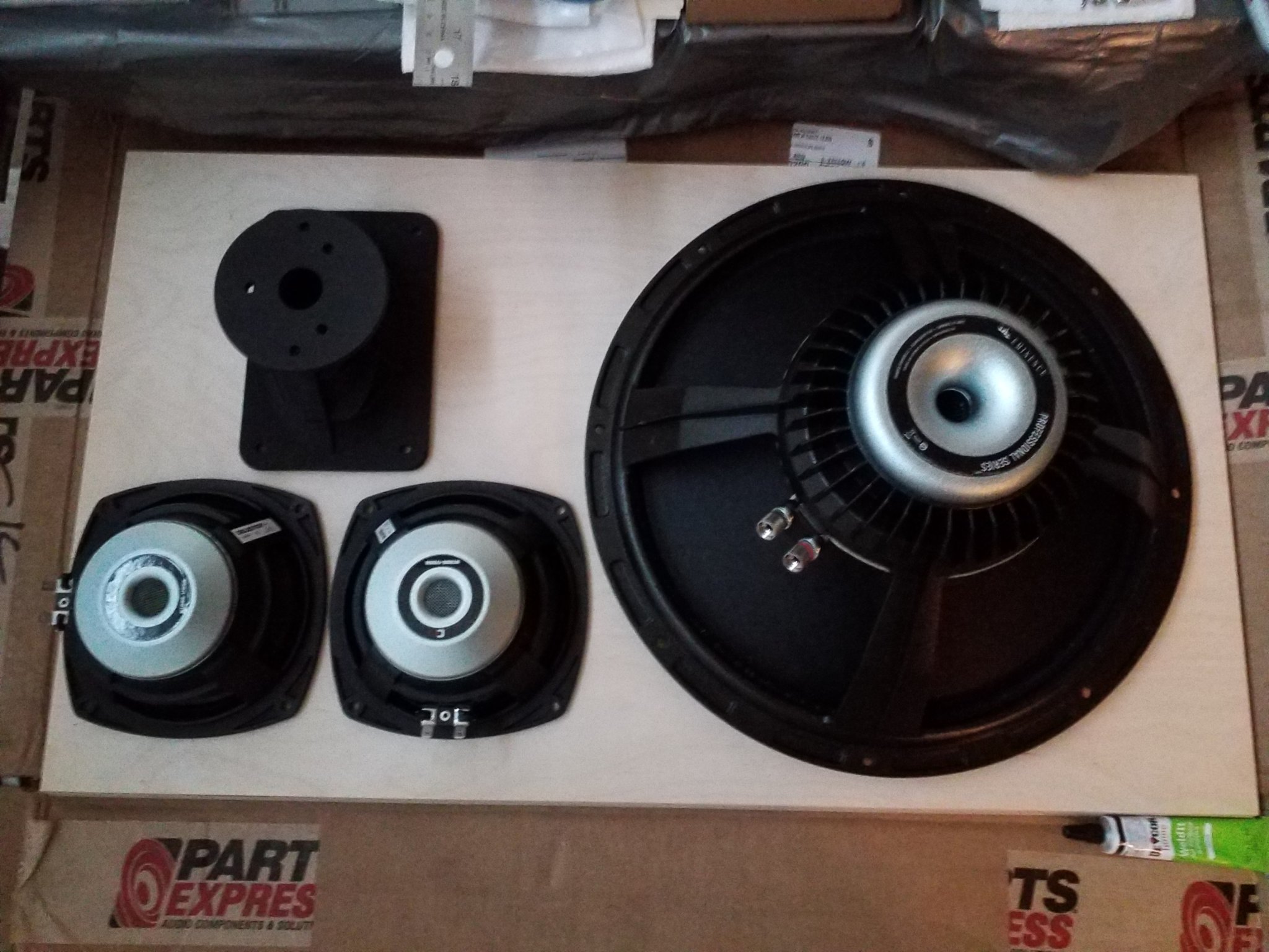

Working on my son's PA cabs. The design is a 15" Eminence KL3015HO, 2× 6" Celestion NTR06-1705B and CDX1-1430 CD on Faital STH100 WG. Mids and HF will be arranged in MTM. Xover is passive at 350 / 2.5 - 3k 2nd / 3rd order. Cab is vented, Fb tuned to 45 hz. I'm using a pair of the Parts Express 15" trap cab flat packs I had left over. They have a good size baffle and decent volume for good low end extension.
My issue here is insufficient baffle height to place the WG between both mids, so I have to compromise by offsetting the WG to the side and place mids right underneath each other. In the past, that's what yielded the best off axis response and performance but I'm wondering if there's a better way to improve off axis behavior.

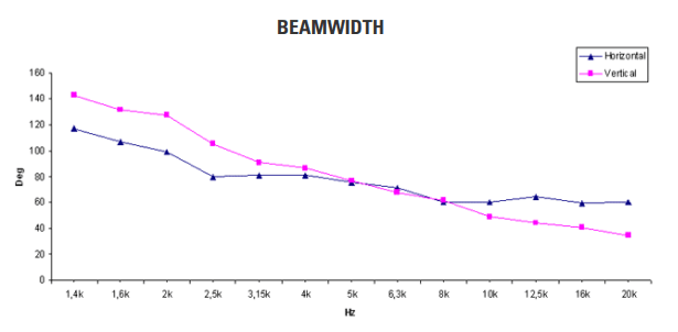

I'm using two mids to allow for a lower mid xover and more lower mid sensitivity. I also want to keep as much of the lower mids away from the 15" as possible. I intended to have a more narrow vertical directivity similar from MF to HF via the mid driver spacing. The WG only does about 50 degrees vertical, so by simming the mid driver spacing and xover, there won't be such a big shift in vertical directivity at xover.

I see that the waveguide pattern has flipped by 2.5k The horizontal is waistbanding and the vertical is losing control. I'm not suggesting it isn't usable. Perhaps it would be a better match to two mids side by side rather than vertical, if they were just the correct size for the cross. Just saying.. there may be more to it than meets the eye.

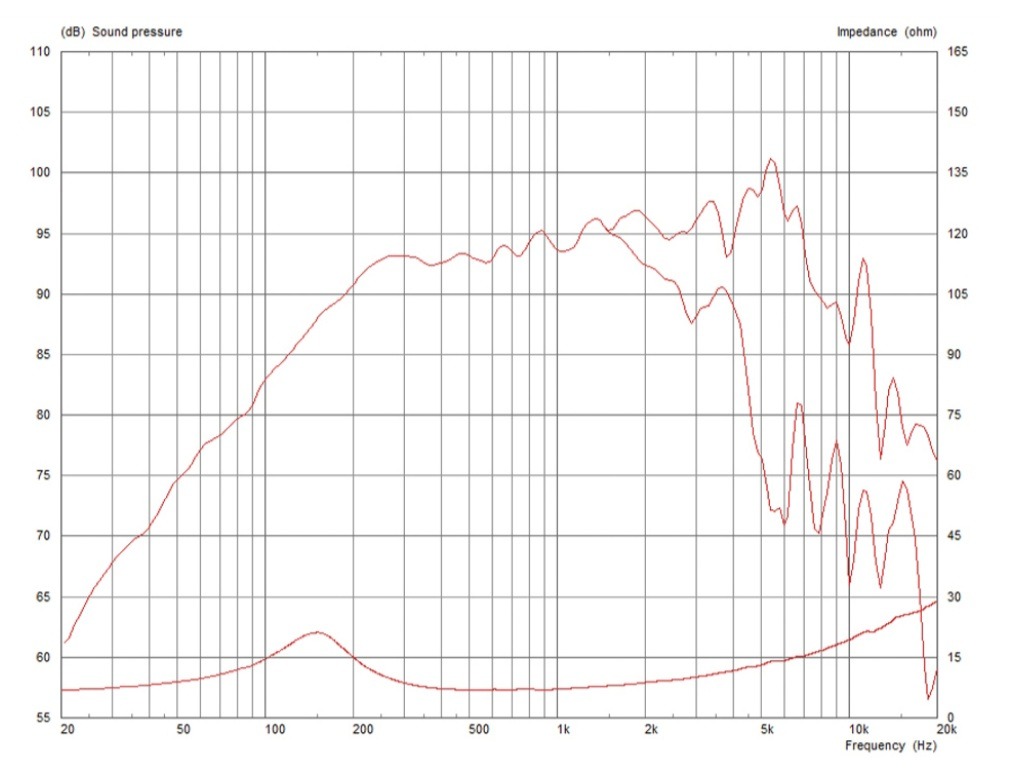

@AllenB This is the FR on and off axis of the Celestion NTR06-1705B mids. They get pretty narrow despite what the shallow cone profile may suggest. They just sound very nice, but wide coverage isn't their strong suit.
I really can't afford other drivers at this point so I'm stuck with the handicap of using these mids. I thought their narrow off axis behavior would be a benefit also having the narrow WG performance around the xover.

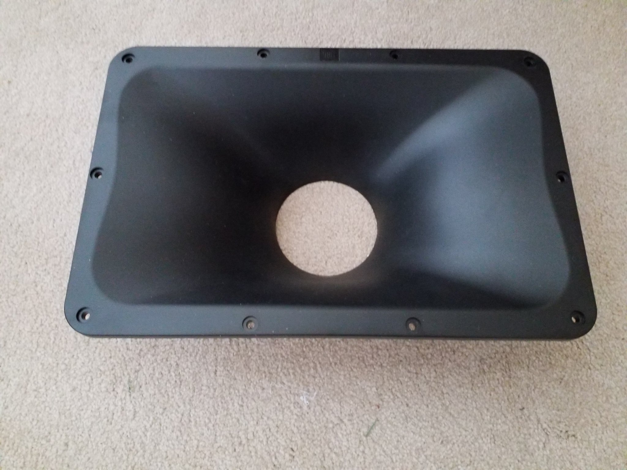

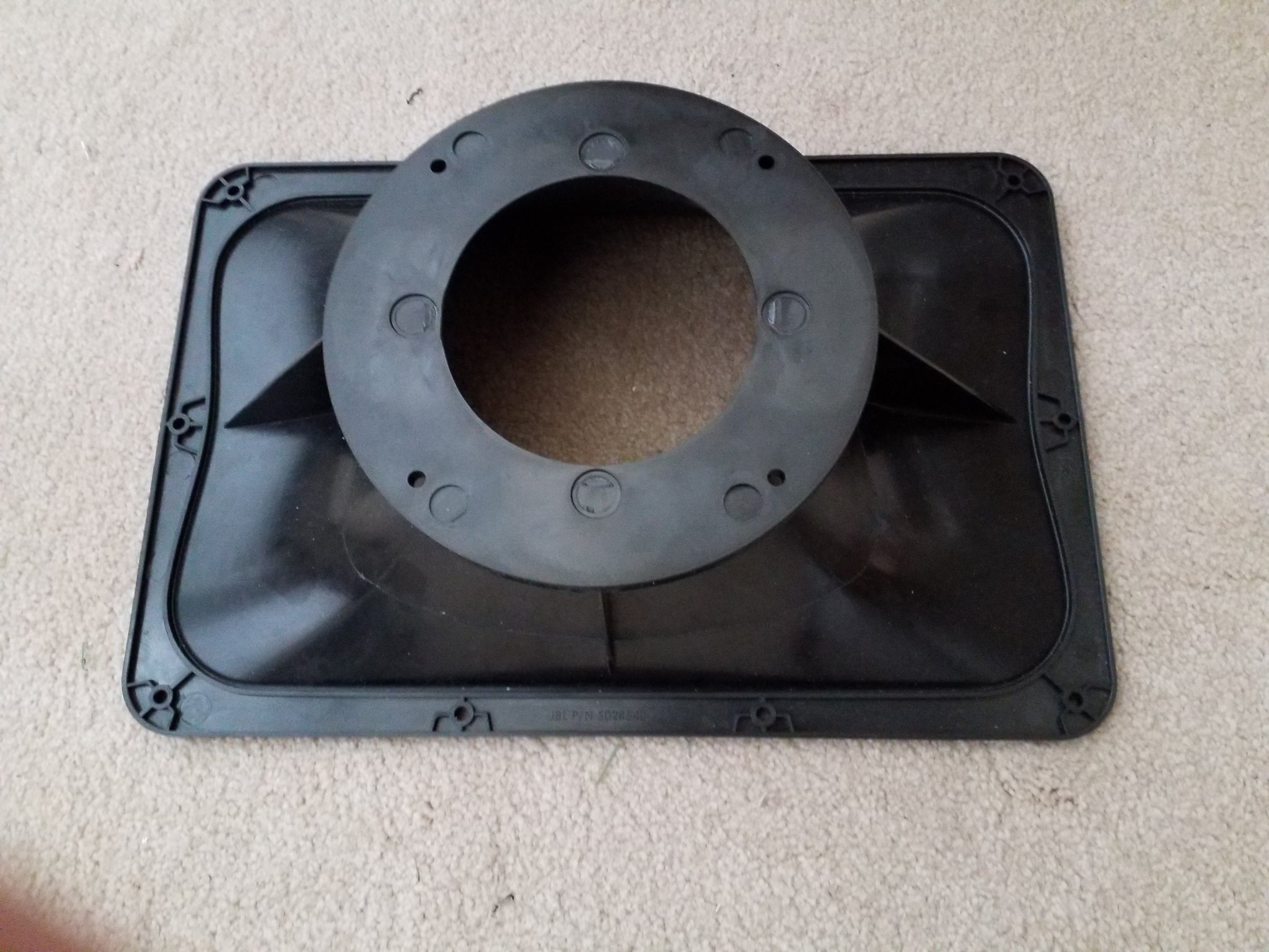

I also have these mid WGs from JBL MRX series. They're designed for an Eminence 6" cone, but could be adapted to my Celestions. I just dont know if it would be a waste of time and the bandwidth wouldn't be there to cross higher.
