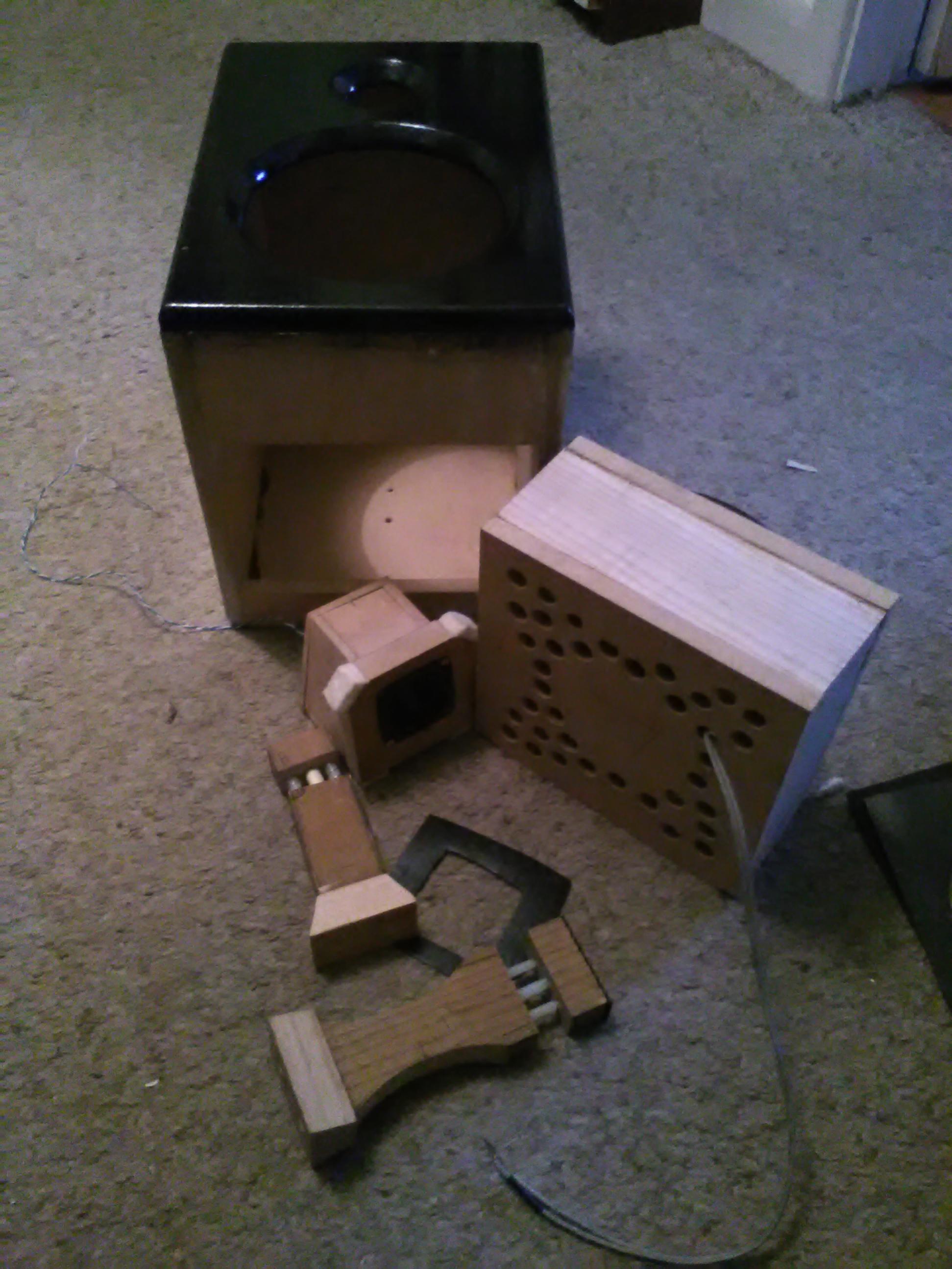

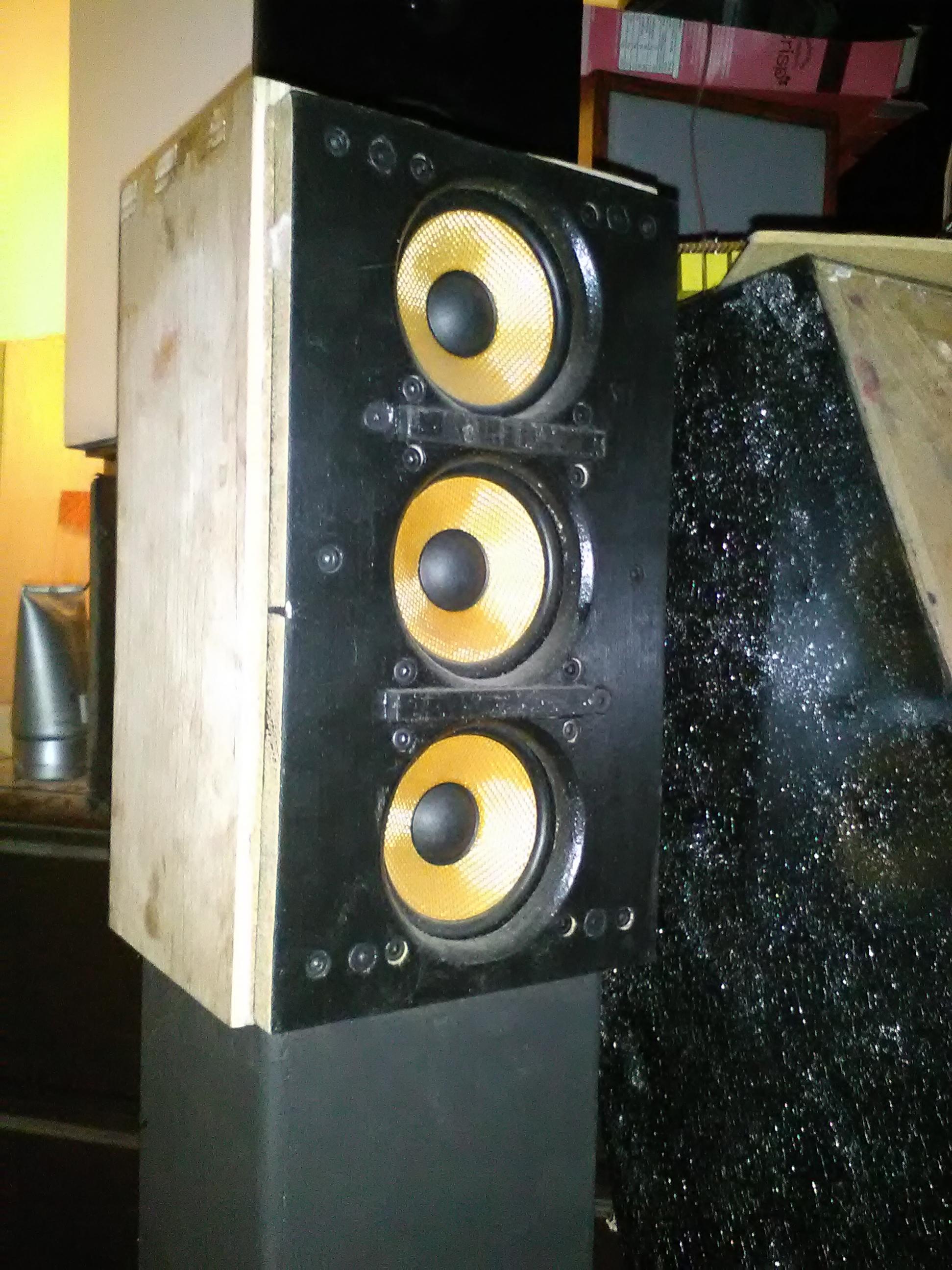

On my traffic light speakers I bolted the three front ( there's also on in the rear) drivers directly to the front baffle, however there are two square steel bars going from top to bottom on each side of the drivers ( for both weight and stiffness ) and the front baffle is held on by three tension springs against a cork gasket, which is also between the steel bars and front baffle for a damping effect. The stands are hollow to increase the volume.
Some cheap Aiyima drivers from Amazon, glass fibre I think. The unconventional crossover is work in progress; I'm tempted to have some out of phase treble coming out the rear, and increasing the bass. I originally ran them all full range as a mini line array, but not for long...
HiVi Kevlar? i imagine cork would work well as a decoupler. Where are you low passing them at?

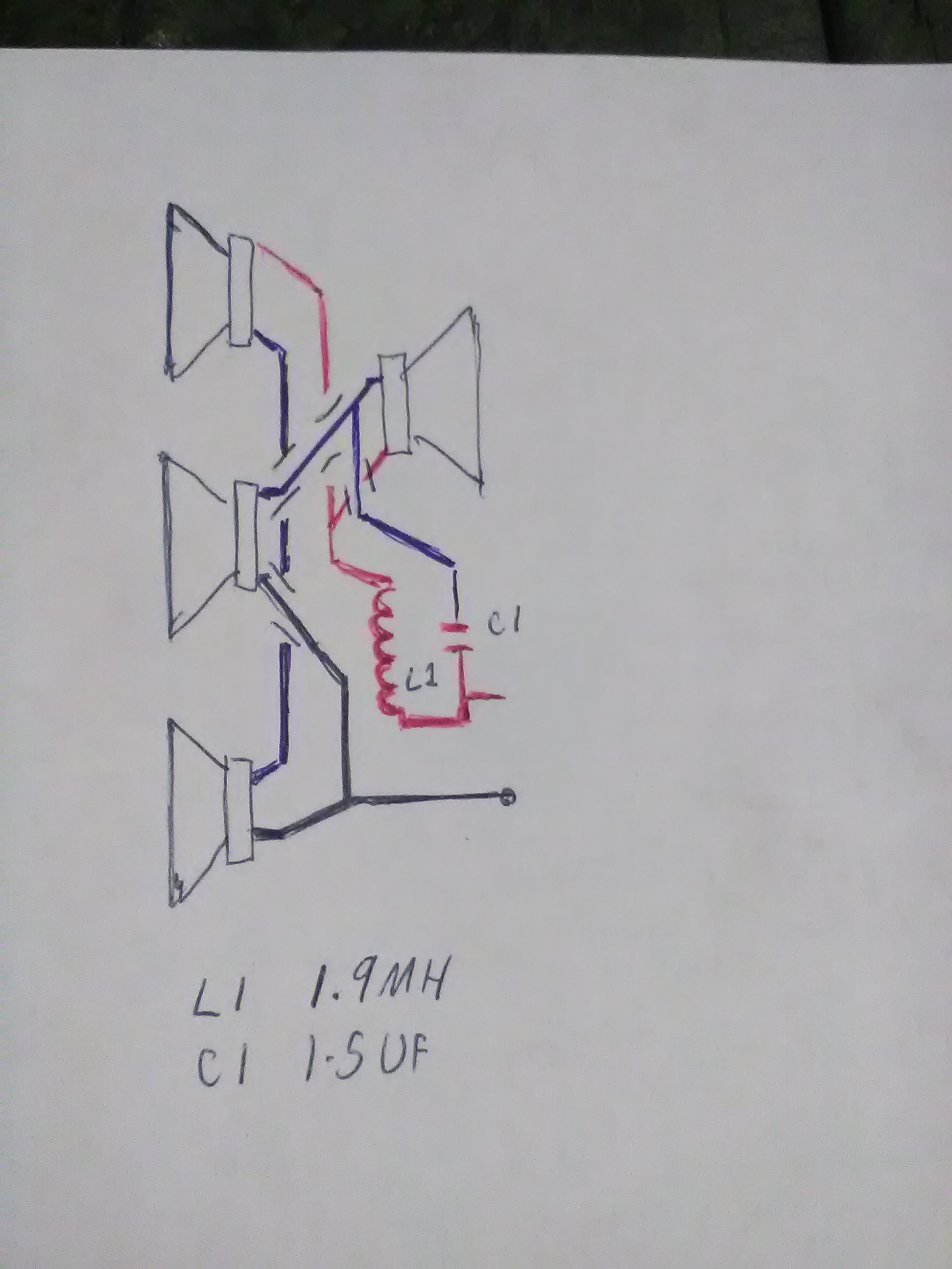

Sorry for the delay in response, the above image is the " crossover ", I think that the 1.9 mh choke has too much resistance because they sound a bit soft, unfortunately because the speaker is crammed full of drivers it would be impossible to have an iron core away from the magnets, I may have to have a choke in the stand. All four drivers are the same, with 6 ohm dc impedance, if I remember correctly. The values were just tuned by ear.
