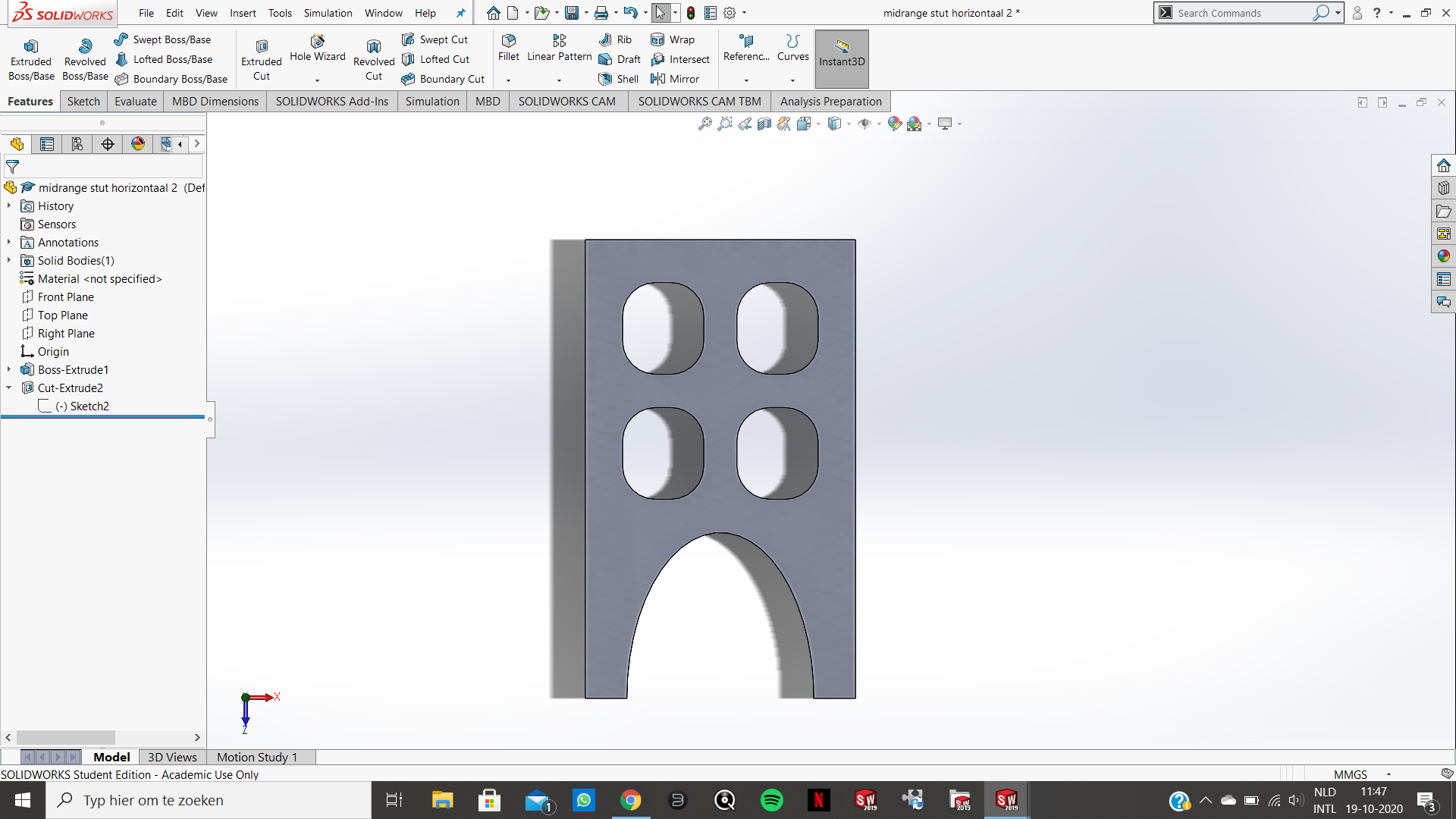

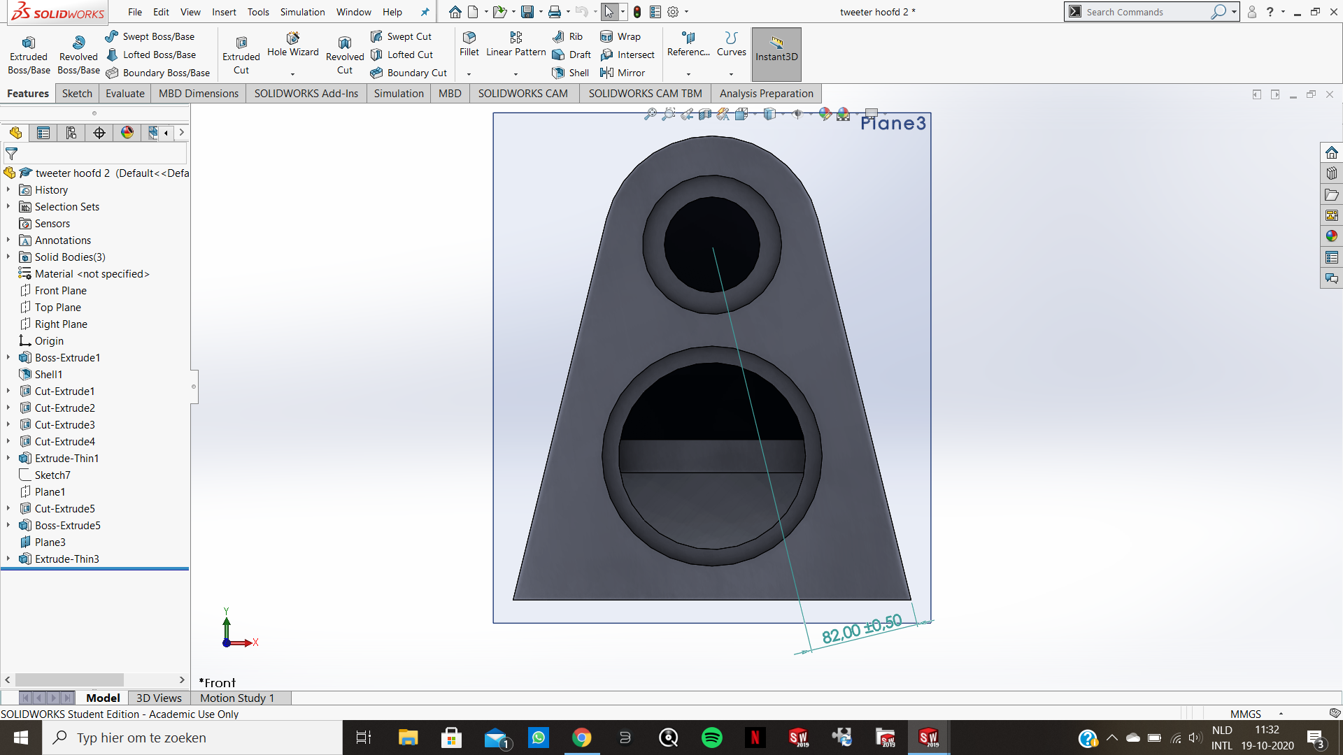

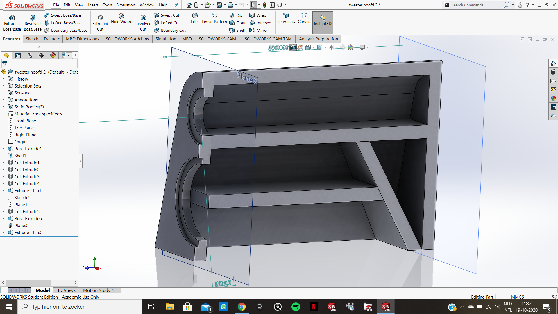

I'm primarilly looking to dampen all the walls of the midrange chamber. Everything is constructed out of 25 mm HDF. There is a horizontal brace to reinforce the side walls. Of course there will be cutouts, it's just very simplified in the picture. It is shown with the cutouts on another picture. There will also be a vertical brace to reinforce the top and bottom walls, which isn't shown on the picture. So together they will form a cross in the middle of the chamber. The side walls are about 210 mm high, the bottom wall is 250 mm wide and the top wall is 147 mm wide.
So it's really quite well braced and rigid though it still sounds kinda hollow when giving it a knock, which I'd like to dampen.

The subject has been researched thoroughly, so I'll keetp it short. Mass, elasticity, boundary conditions and internal loss determine panel movement and amplitude of movement, panel size and shape determine acoustic radiation.
25mm HDF is not very well damped. The ratio mass/elasticity isn't really high either. It is quite heavy though, so any panel damping measurement has to be quite substantial. That is why I advised to decouple drivers. It can be really effective.
Well CLD with a box within the box is quite difficult and uses a lot of volume. An idea I have. Instead of the butyl damping, stick some very heavy plates to the walls with a very soft foam inbetween. Seems to me like this should dampen the walls very wel. Kind of the same as CLD. Except it's not a sealed box in side a box. PMC did the same with the outer panels on their flagship Fenestria speaker.
Decoupling the driver could also work very well though I'm afraid of doing it in practice on my speakers. I can imagine mounting the midrange on a soft damping material could compromise it's transient response. Also, such a system would have to be tuned very well to make it work in your favor and not against you. I can imagine that such a system could also make the midrange lose transient impact/attack and make it sloppy. So I'm kind of scared to put this in my own speakers where I only have one shot at it.

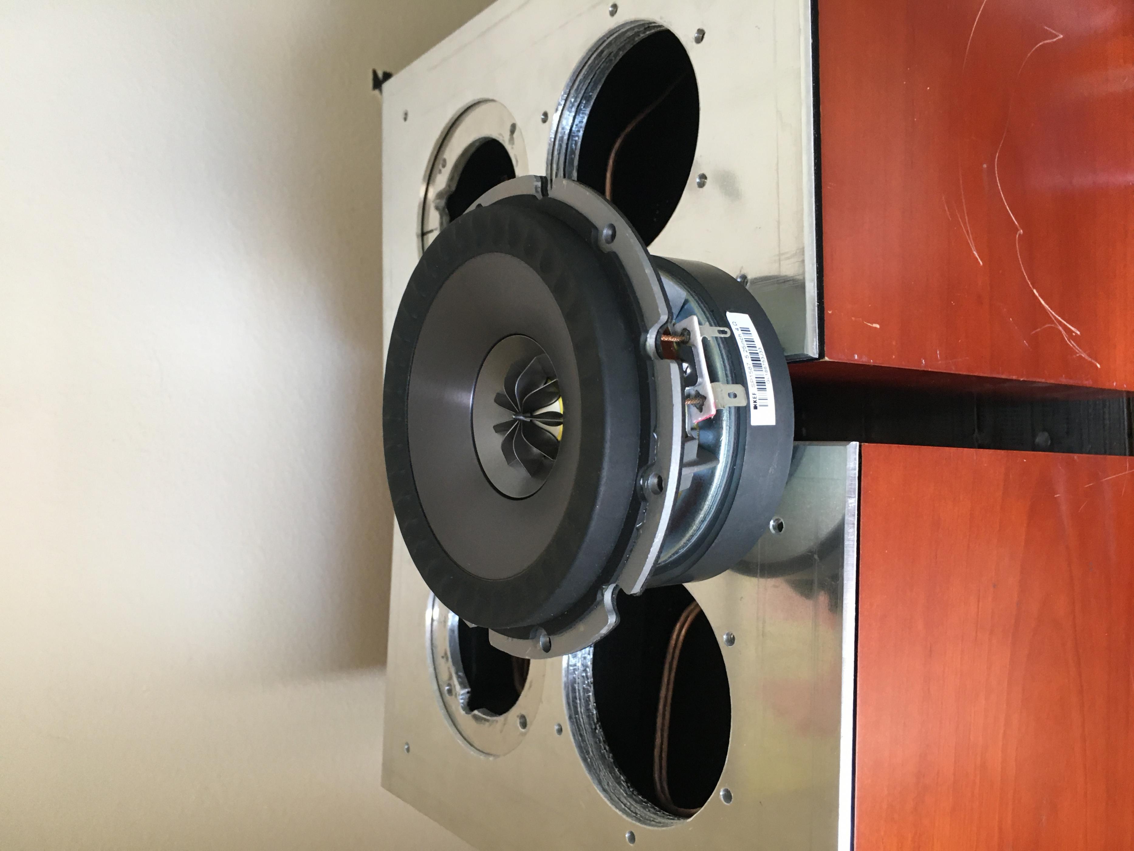

Maybe the way Linkwitz describe to mount the drivers ( by attaching them by the magnet, like you discovered by yourself when you prototyped your first box) is worth investigating too. It should help with damping of your box as a side effect too). It could be easier to implement than with a gasket for decoupling too.
