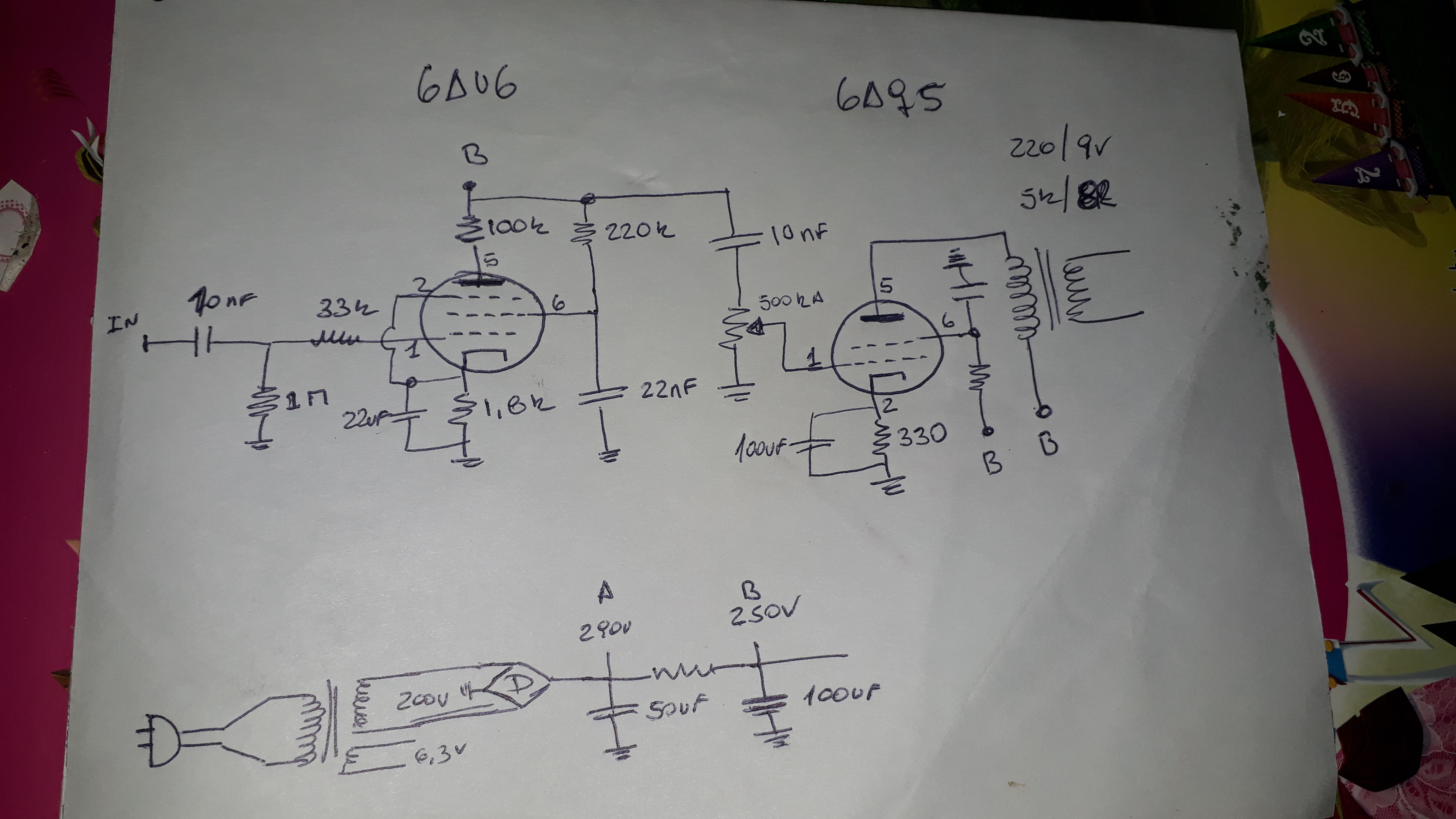

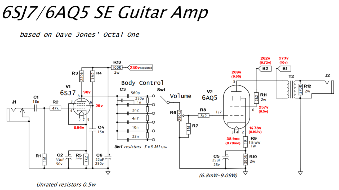

the 6AQ5 should draw about 50 mA in class A single ended operation. The 6AU6 will eat about 3 to 5 mA, so you want to lose 20 volts with 55 mA flowing, that's 363 ohms. Anything from 330 to 390 will probably work. If that's not handy stick in the closest resistor you have and tweak from there. It will burn a bit over 1 watt, so use a 2 watt or bigger resistor.
The common connection in a tube guitar amp puts the opt primary directly on the first filter cap feeding the maximum voltage to the output tube's plate. Everything else gets wired to the second cap. If you try this the load on the dropping resistor will be much less, so a larger resistor will be needed, something in the 2.2 to 4.7K range.
PRR

The choice of where to connect the B+ to the OPT has a lot to do with the "tone" of the amp, as do the resistor values around the 6AU6. I could reach the word limit for a single post and not explain it all.....
The short story on the B+. Hanging everything on the second cap could result in less hum. All of the amp's current must flow through the dropping resistor, so the resistor must be relatively small. The B+ voltage will sag somewhat when the amp clips hard, but not that much. Many players prefer this.
Hanging the plate of the output tube on the first cap, and everything else on the second cap allows for a much larger dropping resistor since it only carries 5 to 10 mA.....until the amp hits clipping, then the screen current goes up quickly, dragging its voltage, AND the preamp's B+ down with it. You can play this against some of the resistor values in the first stage to make for some creamy sounding long decaying notes which can be modulated with the guitar's volume knob or playing style. There are many variables, and my amp has 3 stages with a tone control, so it took my about 3 weeks of tweaking with 4 or 5 pots wired into the amp to get right, but I have played that amp for nearly 3 years now, and never had to mess with it.

You will have to experiment with the value of the plate load resistor. 22K is too small. I would try something around 100K, then increase the screen grid resistor to bring the plate voltage back up to around 150 volts.
These two resistors and the cathode resistor all interact to set the gain and sound quality of the amp. As I stated earlier I had pots in place of them and turned knobs for several days to get what I wanted.
Raise the 330K question mark resistor to 1 meg, and try a 1 meg volume pot if you have one.

> How can i get more gain from the 6au6?
Datasheet, page 2.
22K is off-the-table, in the direction of low gain.
For the proposed 500K next-stage load (omitting the 330K), G.E. liked 240K-510K plate resistor, gain 240-280. And G.E. tells you some suitable values for RK and RG2, which can be tedious to cut/try find on a pentode.
However anything much over George's 100K will give more gain below 1KHz and less gain beyond 10KHz. For Guitar, Fender did OK with a million 100K resistors; some other brands did higher values. I would not go over 250K for plate resistor unless I was willing to shave the highs.
You do understand that two stages makes a LOT more gain than any one stage hot-rodded? One 6AU6 = 160-"350", both halves of 12AX7 = 2,500.

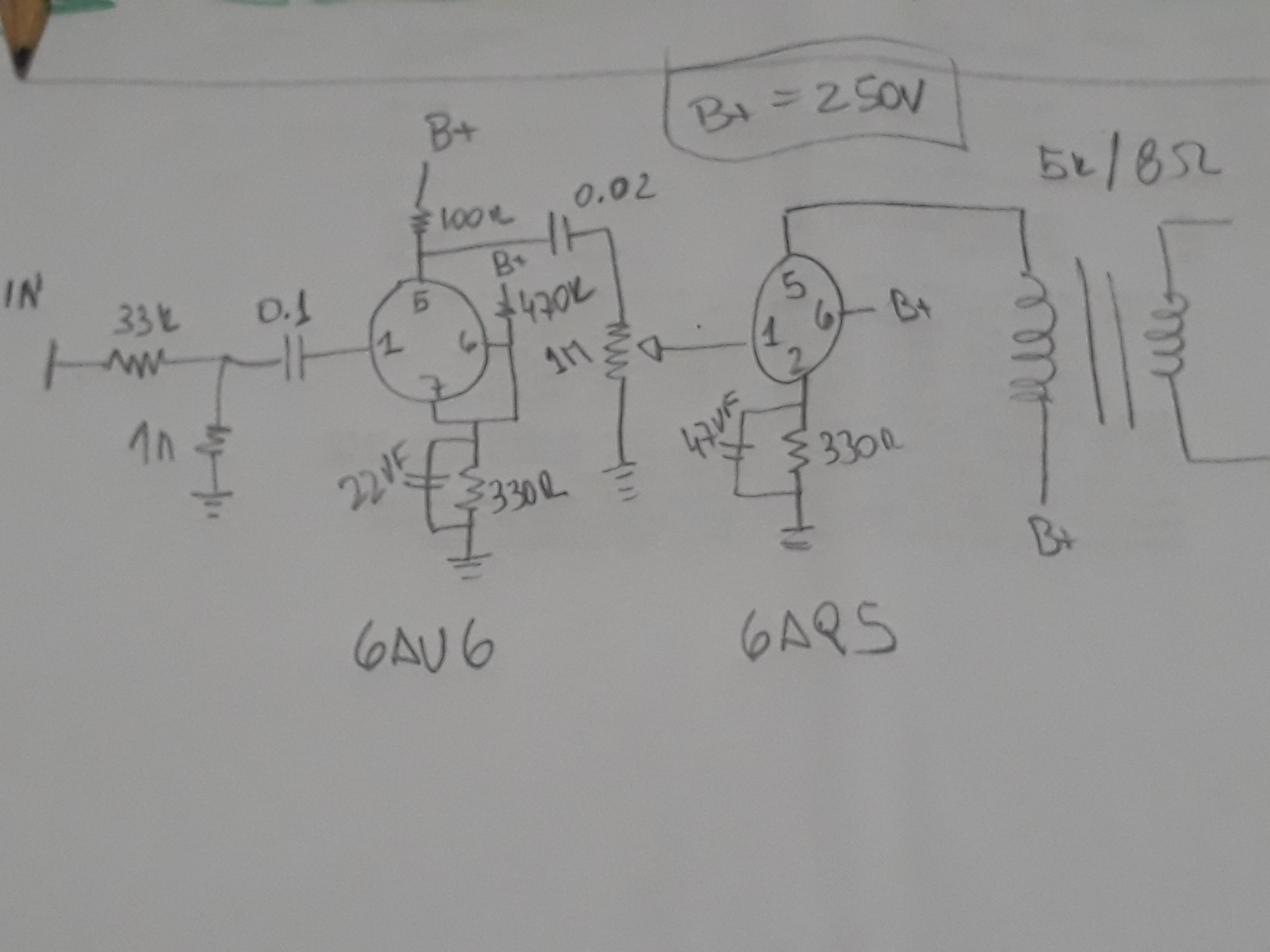

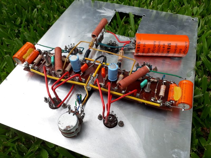

thank to everyone for their answers and their help with the theory.
At the end I tried the 6gk5 tube in the pre and the final result was great. I leave you the circuit with the values ​​i used and the tensions. According to my calculations in the tube 6aq5 I have a plate dissipation of 11w approx.
