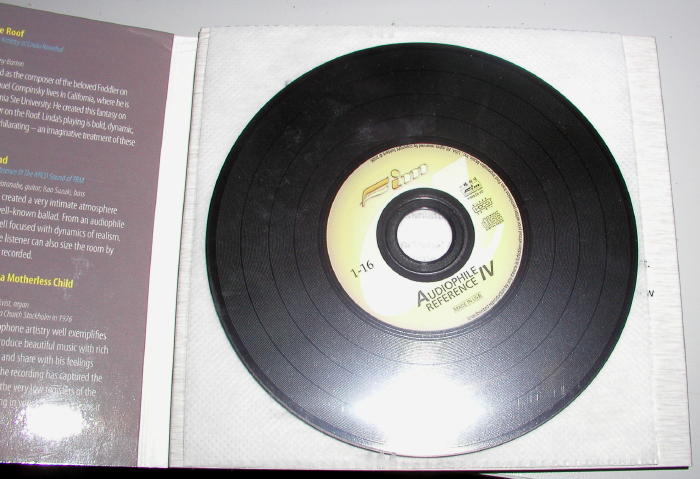

Pjotr said:Have tried several “black” CD-R’s. They play fine on my PC drive, as the others do. But my CD player don’t like them: Rattling/distorted sound because the player cannot cope with that much read errors.
Sure that it is disk related read errors or is it a cd player that is old enough that it does not always read CD- R correctly? Or is it with just that particular type of CD-R that you encountered the issue? My first Philips Magnavox player (14 bit, ouch) basically wouldn't read most CD-R due to the difference of reflectivity between CD-R disks and standard CD's, and I seem to recollect that my long departed PSA Lambda Drive did not like certain colors either.. (Black comes to mind)
My player is a 10 years old Sony 920 QS with stationary laser head. It plays normal CD-R from TDK and Verbatim without any problem as well as the older dark coloured CD-R 650 ones. The laser head is replaced some 2 years ago for a new one but the old one didn’t like the black CD’s either.
I tried the FUJI CD-R 700 PRO BLACK and the DataTrack Professional CD-R80 (a German brand which is advertised as the best for archival purposes). They don’t work on my audio CD player.
So I have serious doubts if the black CD-R’s are any good for audio. IMO the light is too much attenuated to be played on a regular player.

Pjotr said:So I have serious doubts if the black CD-R’s are any good for audio. IMO the light is too much attenuated to be played on a regular player.
FIM has one of the samplers made on black CD. Plays exeptionally well 😉
