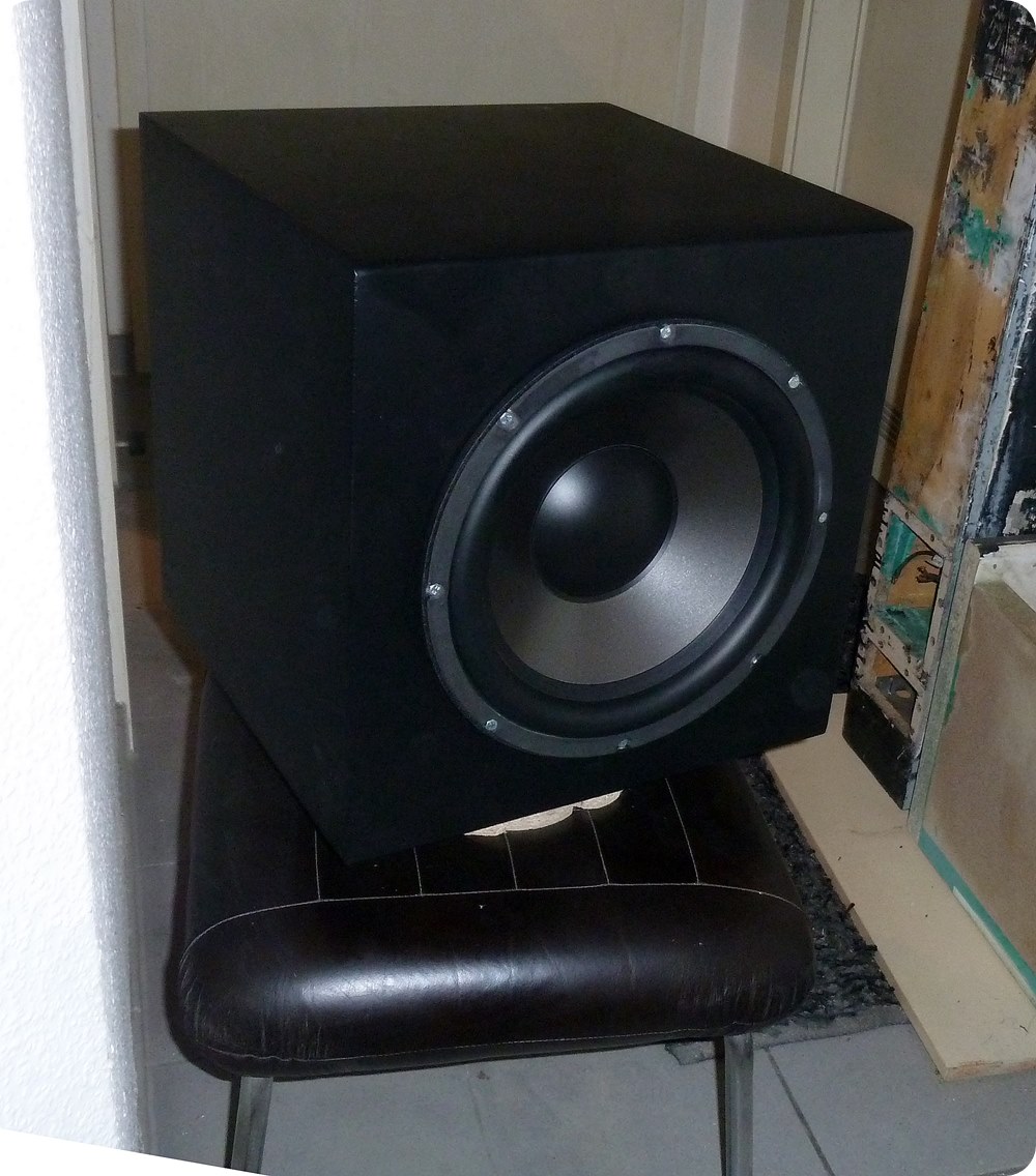

Your speaker sounds interesting. Did you post a picture of it somewhere?

I have not posted a pic of them yet, but I will soon. They are obviously still a work in progress.

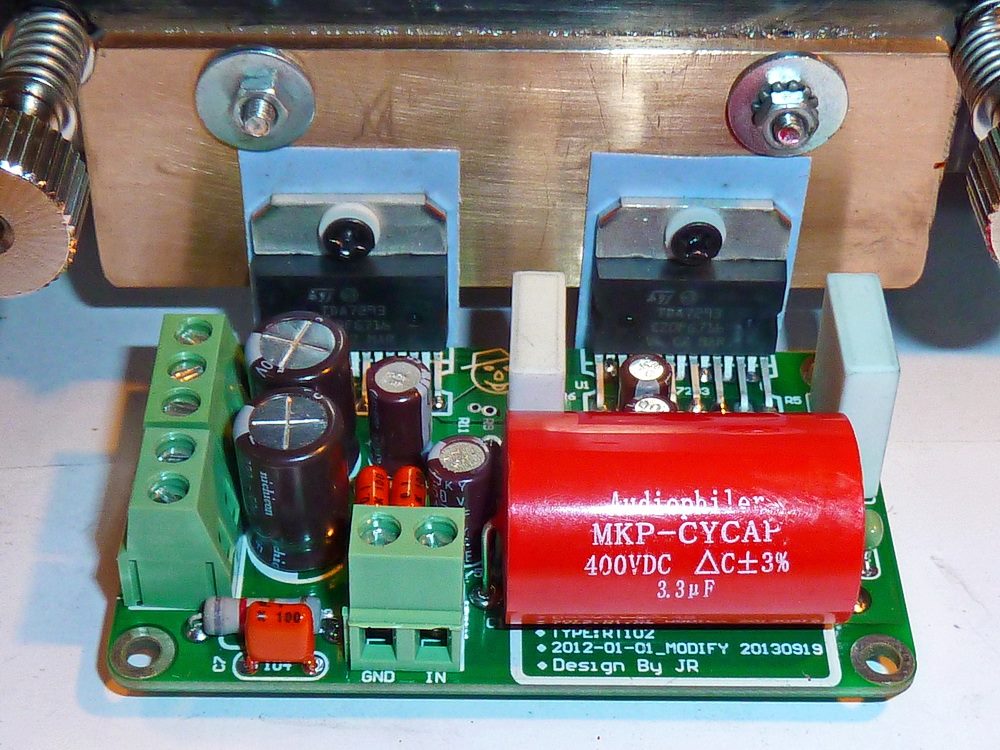

Better late than never 😉. It's a simple China Kit and I'm driving a Mivoc AW 3000 in 50 Liters sealed with it. I'm pretty happy with the Performance, but I'll try a triple TDA7293 just because of "why not?" 😉.
Those boards actually look good for being from china. The little tda 8932 boards I got surprised the hell out of me. The amount of bass for the size is quite impressive. I may do some mods at some point. I,d really like to hear what they are like when better implemented. I finally finished the myref c amps. just working on getting it all in some proper cases.
