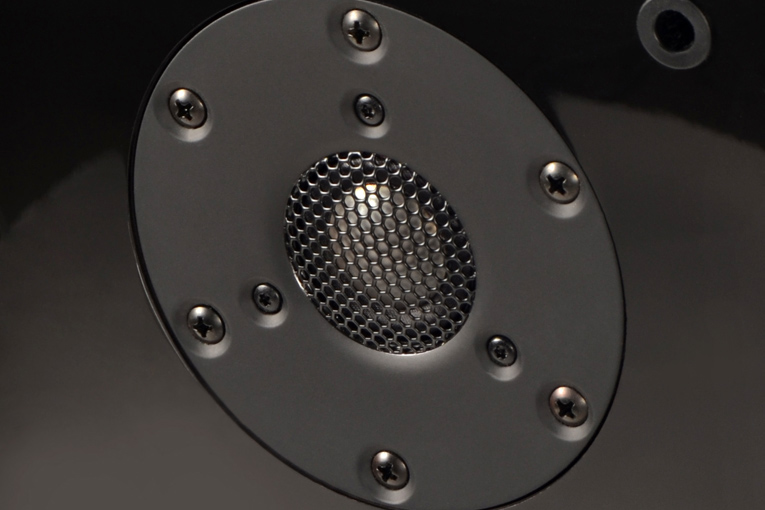

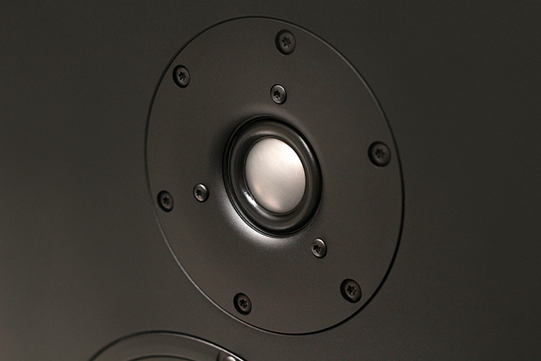

IMO, the real problem is diffraction near the driver - specifically grouped "sources" with phase problems creating a slight pressure reduction as amplitude increases. This effect is perhaps enhanced visually because of the 2 meter testing (..and also a bit "smoothed").
Note that Be Scan Speak tweeter in the Magico S5 has this problem:
SoundStageNetwork.com | SoundStage.com | NRC Measurements: Magico S5 Loudspeakers
Is this likely a thermal effect? (Hint: I know what Scan Speak engineers would tell you what to do to yourself if you think it's either thermal or physical compression.) 😀
So why is it happening? (..and remember that this one doesn't have a grill when tested.)
-Because those particular $30,000 loudspeakers have a tweeter that's set to far into the baffle. 😉

Magico's Be tweeter looks like it's heavily based on the scanspeak Be dome. It's certainly surprising considering Scans heritage etc, but the standard Be dome does not use ferrofluid in the gap and this could be what happens without it. The Focus Audio Prestige FP90 BE Loudspeakers also exhibit a similar issue with compression and they too use a version of the scan Be tweeter.
I do not know what Scott is talking about with regards to the recessed baffle as the tweeter in the S5 is simply flush mounted on an ordinary flat baffle.
..Magico's Be tweeter looks like it's heavily based on the scanspeak Be dome. It's certainly surprising considering Scans heritage etc, but the standard Be dome does not use ferrofluid in the gap and this could be what happens without it. The Focus Audio Prestige FP90 BE Loudspeakers also exhibit a similar issue with compression and they too use a version of the scan Be tweeter.
The tweeter is sourced from Scan Speak, as is the mid-range I believe (..though using Magico's diaphragm), as are the bass drivers. The drivers (not the tweeter) in their more expensive line are Morel - and actually are inferior. Only the mid-range is really "custom".
My guess is the tweeter is recessed by about 2 mm's. (..again, the behavior is somewhat exaggerated due to the 2 meter measurement). The Focus Audio Prestige FP90 BE Loudspeakers have nearly the same problem - actually with a bit of a deeper recess.
Note: that the recessed tweeter may be on purpose - to achieve a certain measured response at the typical 1/watt 1 meter measurement (..neglecting the pressure loss at higher levels within a very limited "on-axis" range).
