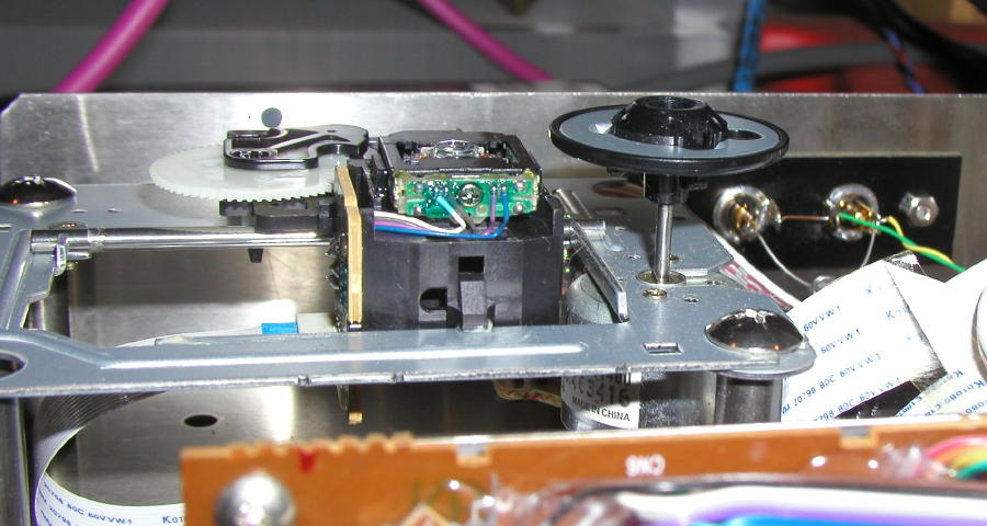

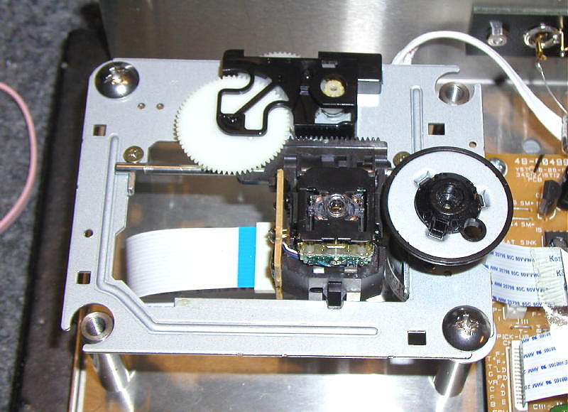

Peter Daniel said:CD drive mechanism that really impressed me recently is the one pictured below. It can be bought for $15, yet implemented in a CDP it rivals CEC TL0 and ML31.5 (in certain ways).
What's that model Peter?
IME mechanism is only part of the equation, how it is implemented in a solid chasis with proper vibration transfer makes another important part.
Will said:What's that model Peter?

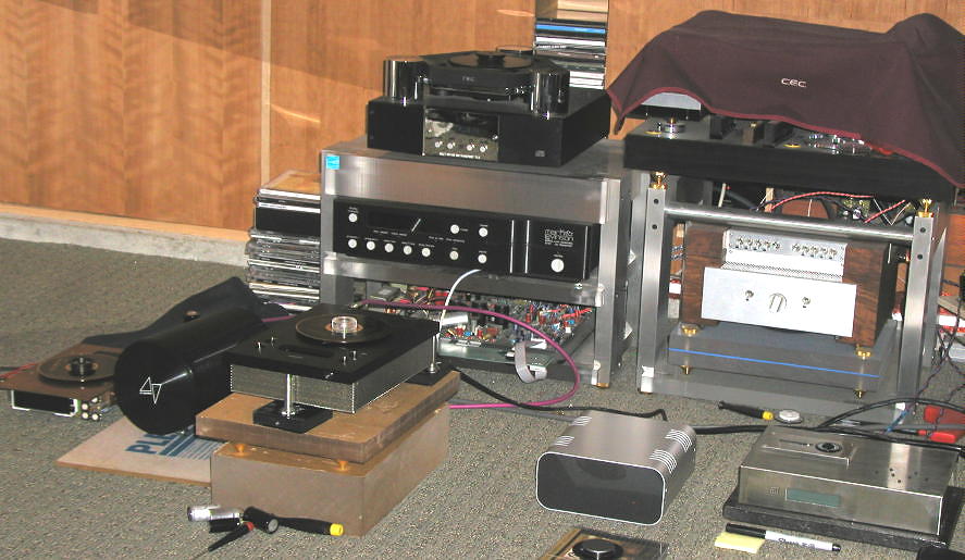

The mechanism is supposedly sourced from CEC and popular with cheap stereos. As to the player in a picture, where it's installed, I invite guesses 😉
Peter, do youbelive CEC is the manufacture or do you mean the one you have is from a CEC player?

hehe31 said:it's look like the SF-P101N 15 pin version
Yes, indeed. And this is what's inside Shigaraki and Flatfish.
Last weekend I was doing some comparisons, and those two players sounded surprisingly good. (Shigaraki actually sounded better with a custom PS that I've built than with a stock supply that Flatfish uses)
