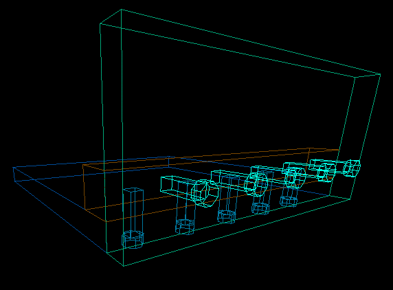

I used 12m plywood sheets fastened with wood screws through additional wooden bars laid along the inside corners, as shown on the picture. The bars were glued to the plywood. After all that I had to smear the inside corners with a sealing compound that has a good adhesion to wood and never fully hardens.
