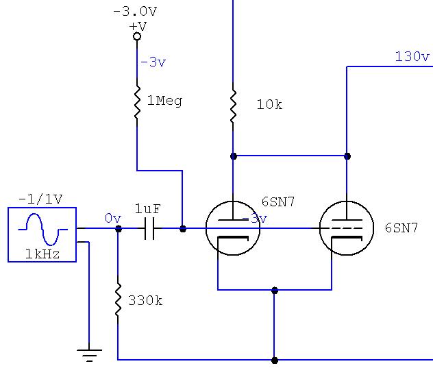

I've been considering using a negative supply to generate the bias voltage for a bass preamp I'm working on at the moment.
I'm trying to eliminate feedback and electrolytics entirely in my design for sonic reasons, and this is the solution I decided on.
The power supply could be very simple and clean (1 diode + RC filter) , because of the low currents involved.
Has anyone tried this method with preamp tubes?

It could be done with a battery. Then, instead of putting it in the grid circuit, you could put it in the cathode circuit. You could use a NiCad cell or two as required, and the cathode current will keep them charged.
As the cells are a short circuit (virtually) to AC, they behave as a well bypassed resistor.
Further, there is the LED, which I am choosing to use. It drops a voltage and is a short for AC. SY is leading a thread about it which may be of interest.
Hope this helps.
P.S. you may want to look again at the anode circuit in your schematic, is that what you wanted?

For many simple input circuits a cathode capacitor is a neccessary evil. If a negative voltage is available, I found a simple (but sandy) way to eliminate it and kill Miller effects at the same time. It doesn't work with all tubes though. I can't post a schematic from work, I will post it this weekend from home.
