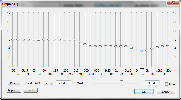

IMO, the FE126s are only usable with the application of a graphic eq.
I used Foobar2000 to do this (see attached).
This provides BSC and a smoother mid-high range that's otherwise very forward.
Again IMO, the only way to get satisfying sound from a small enclosure and these drivers is to go sealed, and use the graphic eq again to do a Linkwitz Transform, providing boost to around 70Hz before cutting down around 45Hz.
You lose a lot of SPL capability, but with their tiny Xmax they'll never do much bass. For nearfield I'd expect this to be okay, having used it myself before now. Just be careful with the cone excursion - once they sound like they're struggling, start cutting off more of the bass if its not loud enough.. These are small speakers.

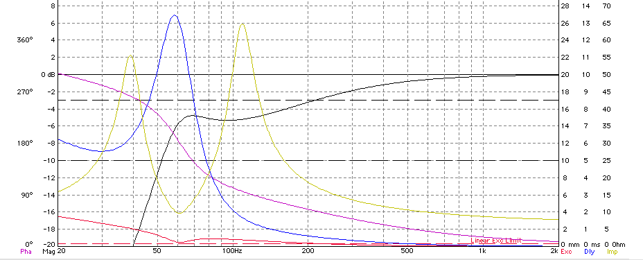

FE126En is not really suited to a small box.
The 10 litre factory box has been descibed as a "crual joke". The attached sim is half-space so does not consider BS Loss.

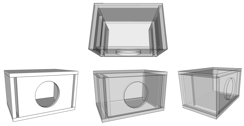

For those needing a centre channel to "match" FH3/FE126 mains i did up what i consider a lesss compromised alignment, 4 litres with a nice roll-off just above 100 Hz.

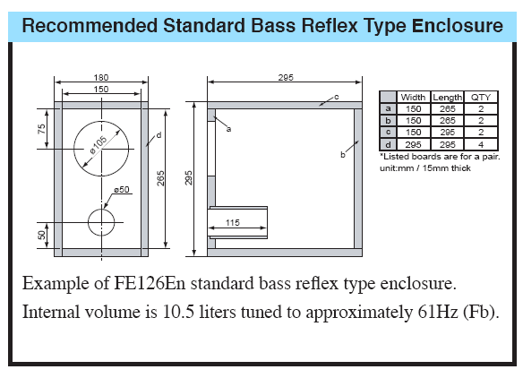

This enclosure ? I will have mine a little further ...maybe 10'. They are cheap enough to build 😉
Those are the ones. Just make sure everything is sealed properly and that you chamfer the woofer hole. It's an easy build and cheap too. I believe I have around $100 in them including the drivers.
