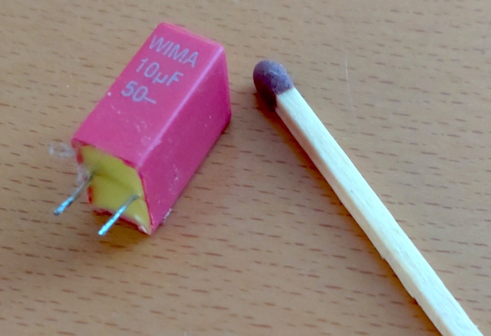

Wima if you can find something that fits is a safe and high quality bet.
https://www.tme.eu/se/details/mks2-10u_50v-5%-r/tht-film-capacitors/wima/mks2b051001n00jo00/

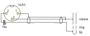

here is schematic. The idea is to plug dynamic mikes on wireless body transmitter.
I may be wrong but I think dynamic mike have lower impedance than electret ?

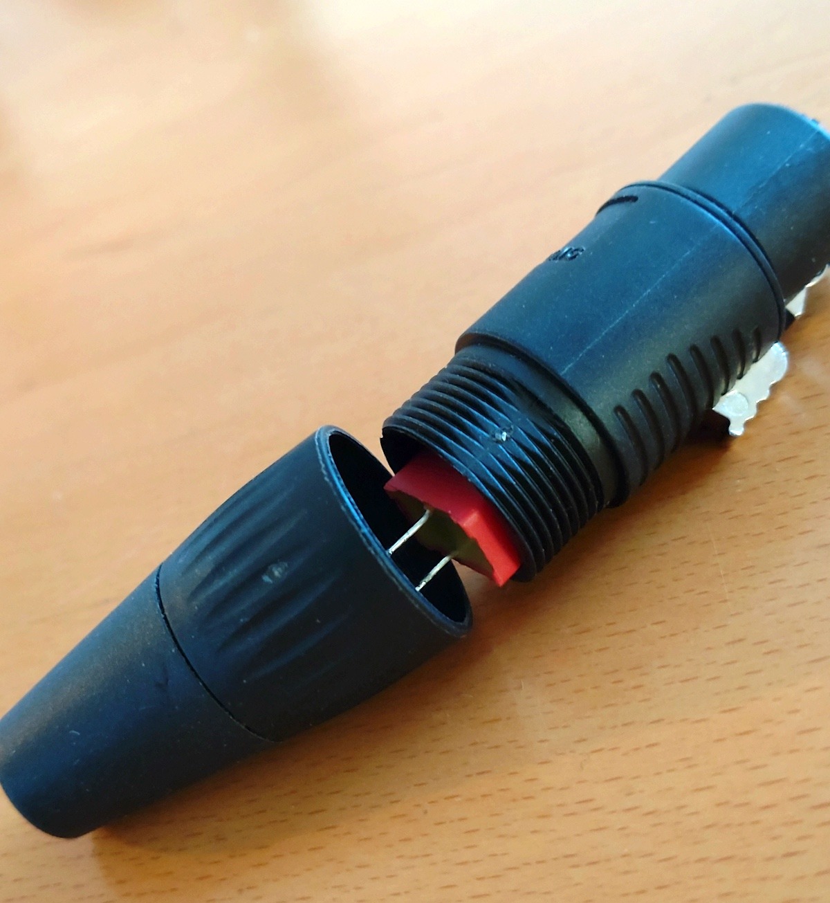

I left film caps due to size but link to wima is unexpected solution 😉
good axial electrolytics (nichicon) may also do the job...
