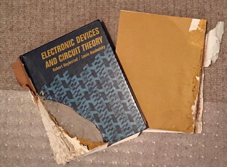

Funny you should mention that. I like Boyl[e]stads text on
Electronic Devices Circuit theory too. But don't take our word for it, check out the pic attached as even the late Wanda loved it as well.
R.I.P. Wanda K. Blues Dog (aka gargoyle) 14.7 years living a chocolate labs dream life. Sadly she was ill and ate the spine off the book (horse glue I think). She passed away in my arms at the Vets this last May. Poor gal, had to be carried in. She passed on looking right into my eyes, thanking me for the relief and letting me know that she loved me, her family, my little girl and that she'd be waiting for me on the other
side.
She's in a better place chasing squirrels and retrieving ducks and dummies.
Cheers
Post Script - If anyone has a replacement copy they'd like to donate to the cause, please PM me for address.

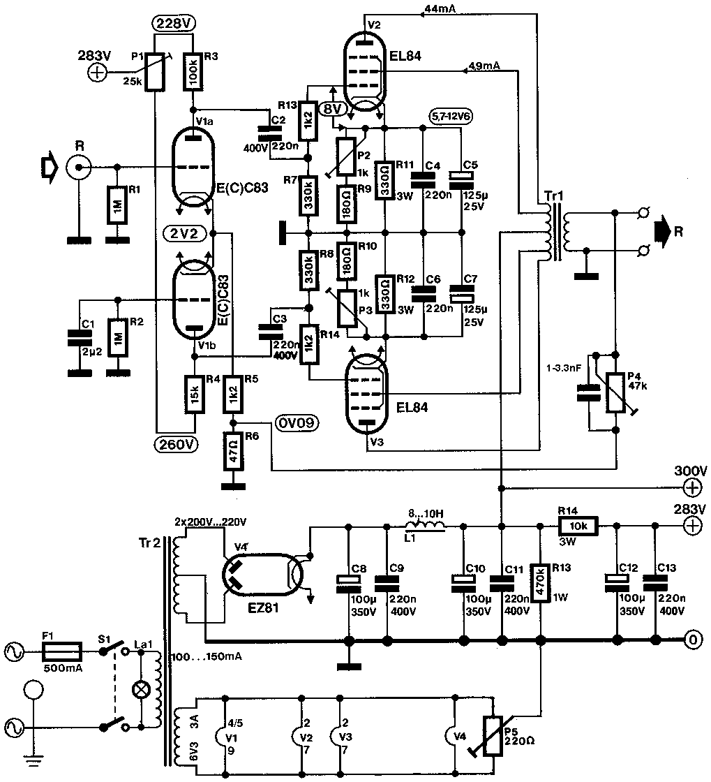

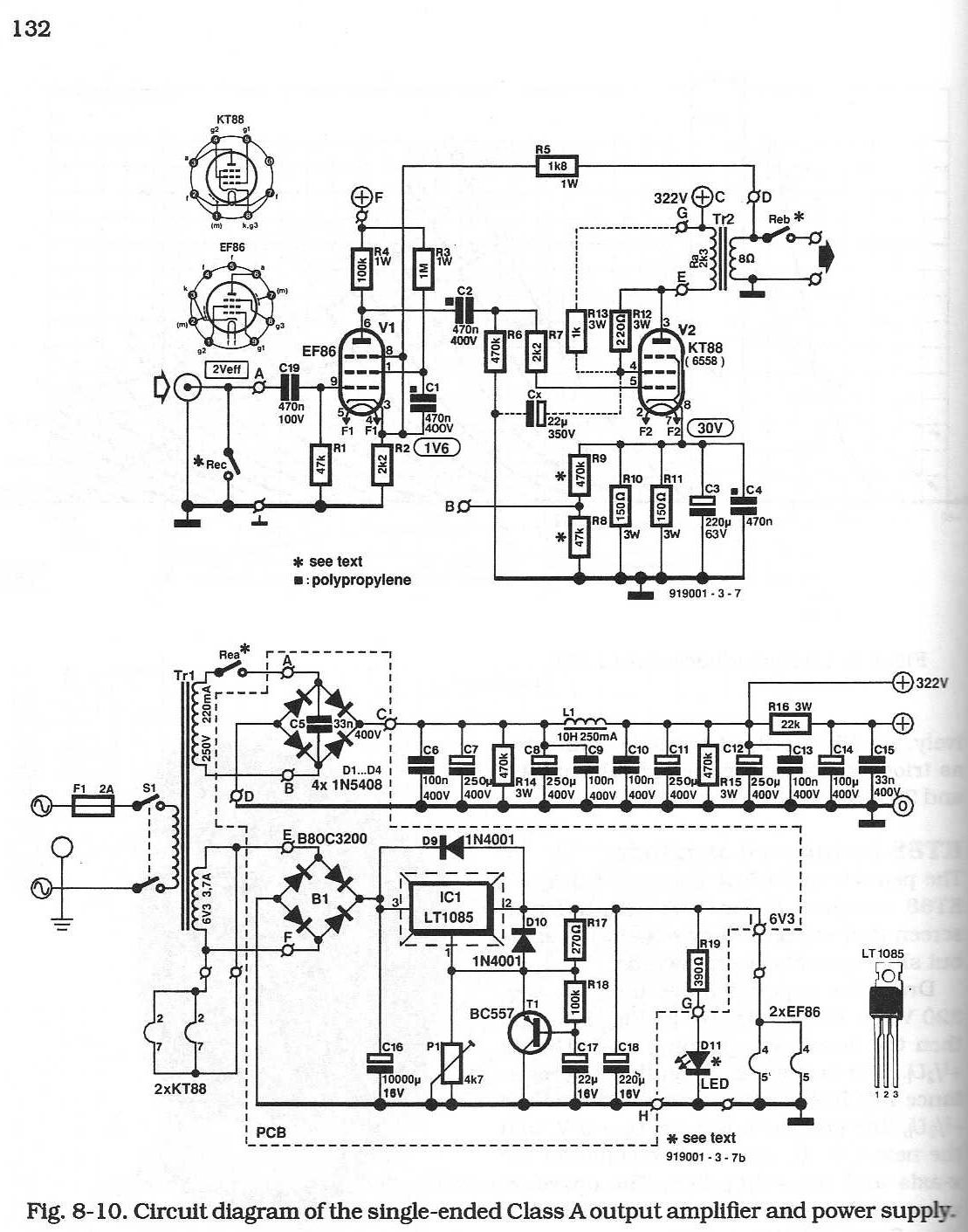

Old thread, but here are three examples of those mistakes (btw: I got the book as a present...):
1) The two cathode resistors of 150 Ohm each for the KT88 are connected parallel (also on the design of the circuit board!) giving 75 Ohm, while they should be series connected to give 300 Ohm. Not good for the KT88 at all (and OPT? and power transformer? there's only a fuse on the primary side). It will start to pass way too much current...
2) The cathode of the upper half of the ECC81 sits at 232V, while the filament supply for the tubes is earthed, so sits at 0V (not shown in the schematic but it does). The maximum cathode to heater voltage of the ECC81 is 90V. Not good for the cathode/filament isolation; very high risk on it failing...
3) The reservoir capacitor of 100 uF is connected straight to the EZ81, without even any protecting resistors in the anode leads and/or in the cathode lead. The maximum value of this reservoir capacitor is 50 uF in the datasheets of the EZ81. Not good for the cathode of the EZ81...
Addition: I did write to the publisher (in 2010) about these mistakes, and they aknowledged them. But as far as I know, they still sell this book without warning buyers for the mistakes it contains.

Pre-stage/phase splitter:
What are we looking at? At first glance it looks like a long-tail pair but the ‘tail’ is very short and the values of the anode resistors (100K and 15K) differ enormously. The resistor of 15K is at the anode of the triode with the grounded grid (well, grounded through a 1M resistor bypassed by a 2.2 uF capacitor...), while normaly you see the higher valued anode resistor at this side.
I do not see how this design can produce output voltages of the same amplitude but with opposite phase. I think that the side with 15K will produce way less amplitude than the side with 100K.
The feedback looks strange to me since it is applied to the common ‘tail’. A member of an other forum wrote this about it: "Effectively the feedback signal modulates the Gm the forwards path experiences.... it's a frequency mixer! Should help make even order distortion quite nicely. If only the author had known it could have been patented as a "valve sound enhancer"
Between B = 283 V and the top of R3 the voltage difference is 55 V. Even with the slider of P1 turned fully downwards (which by the way would be impossible because there has to be only 260 V at R4) you would still need a current of: I = V / R = 55 / 25000 = 2.2 mA.
But there is no 2.2 mA to start with when looking at the cathode voltage and cathode resistors. I = V / R = 2.2 / 1247 = 1.76 mA.
So however this stage is supposed to work, it can surely not work with the given values/voltages.
Output stage:
In the schematic (and in the text) it says that you have to adjust the cathode resistance so that the anode current per EL84 is 44 mA. The cathode voltage would than be about 8 V.
Let's suppose that the dc resistance per half of the primary is about 200 Ohm (wich is rather high for an output transformer of quality). Than the voltage loss in one half of the primary would be about 10 V. So the voltage between cathode and anode of the EL84’s is 300 – (8 + 10) = 282 V. The voltage between the cathode and screen grid will be slightly higher, lets say 285 V.
Looking in the datasheets for the EL84 you will see that it is impossible that the anode current is only 44 mA at Vg1 = -8 V and Vg2 = 285 V. I think something between 60 and 65 mA is right. But than the anode dissipation per EL84 would be between 17 and 18.4 Watt, which ofcourse is way over the limit of 12 Watt.
Power supply:
It is impossible to get 300 Vdc from 2 x 200…220 Vac and an EZ81 at about 100 mA like this amplifier is supposed to draw. I do not think you will even reach 250 Vdc.
The value of C8 right after the EZ81 is 100 uF. The datasheets give 50 uF as maximum. Higher values at least shorten lifespan.
The cathode of the EZ81 is connected to its filament, which in turn is connected to the filaments of the other tubes. The filaments are grounded through anti-hum pot P5, so B+ is practically shorted to ground.
