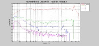

Are there (better small semi full-range drivers)? Better in what respect?
All of the 3” could be classed as semi-FR.
The FE88ex has audible issues up top (they do not show on your graph). I prefer the FF85wk but it has issues as well (which mostly go away once i am done with them [but at that point they are quite a bit pricier]). Probably the best out of the box is the Mark Audio Alpair 5.2/3. A cheaper alternative migh tbe the CHN-50 but i have yet to hear mine.

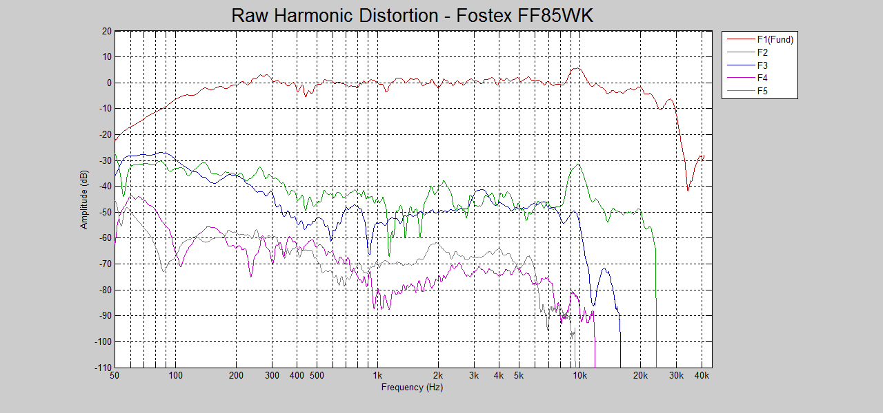

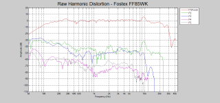

Here is the FF85wk non-linear (another driver I've recommended where greater eff. was required along with being less directive off-axis).
It's overall more linear on and off axis, at least on an "infinite" baffle. The higher order distortion is however quite a bit worse, especially with increased output - so it needs more(steeper) filter or a much higher freq. for it's high-pass.
From what I've seen of Mark Audio drivers, they aren't as linear while also having higher high order non-linear distortion. Of course that's not saying they don't sound better for a given spl and design - but that what I've seen doesn't seem to match objectively.
That FR is smoother than i would expect for a stock driver, but the FF85wk is probably the least problematic of all the Fostex drivers.
