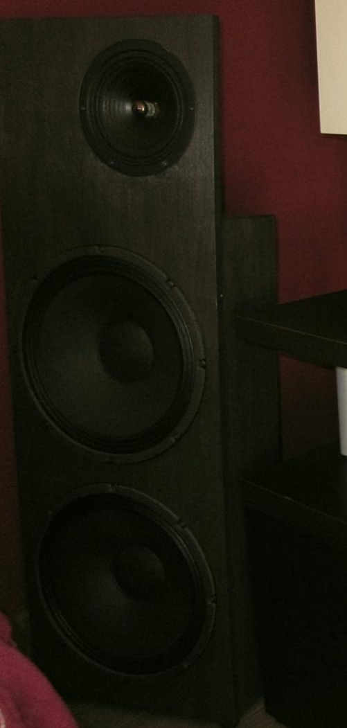

How much is gained by using two of the Eminence Alpha 15s per side as opposed to one? Will their be a noticeable improvement in bass quality? I'm not a bass head but I like quality bass, tight, with no distortion. If I could achieve the same results using one Alpha 15 or two 12 or 10 in woofers, per side, that would be great. From and aesthetic point of view it would surely look better, at least, to my eye. Thoughts?

My experience has been that doubling drivers reduces harmonic distortion for same SPL. Also you have higher ultimate SPL capability. If you have the room two 15 in woofers - go for it.
My family room is 20x30. Also, I have a very understanding wife.My experience has been that doubling drivers reduces harmonic distortion for same SPL. Also you have higher ultimate SPL capability. If you have the room two 15 in woofers - go for it.

It adds 6 dB of dynamic headroom, equivalent to halving the excursion required and since if you can see a driver moving from the listening position [Lp], it's already distorting [usually audibly].............
Overall bass quality is mostly a function of proper blending to the mids/HF where its harmonic structure that defines its 'PRaT' [pace, rhythm & timing] are reproduced, so getting the phase matched close enough through the XO BW is essential to a high sound quality [SQ].

From this I infer two woofers properly integrated, via the crossover, can only improve the quality of the bass. Like I said my goal isn't loud, pounding bass but clean defined bass.It adds 6 dB of dynamic headroom, equivalent to halving the excursion required and since if you can see a driver moving from the listening position [Lp], it's already distorting [usually audibly].............

I'm curious if anyone feels, and why, using two woofer per side is a bad thing? I'm beginning to think, that with speaker design, tradeoffs are just part of the game.

Correct, though obviously if you only listen to highly compressed, BW limited music at Muzak level SPLs as some apt., condo dwellers are forced to do, then probably won’t be worth the extra cost and can probably get by with a single 12”/channel.
If you occasionally want to listen at piano bar levels as I do though, you’ll need at least dual 15”/channel and depending on in-room conditions could need four/channel with two rolled off in an OB app. At this point, mounting the ‘FR’ driver in the center of a four square layout to mimic a really large point source becomes desirable.
It only becomes a bad 'thing' when the acoustic centers are too far apart to sound as one at the LP. As the ‘FR’ driver shrinks in size then, the usable XO point rises and the acoustic c-t-c spacing shrinks with it.
Up to a point then, mounting dual woofers horizontally opposed is preferred since it both minimizes the c-t-c spacing plus increases horizontal directivity to a lower frequency same as a horn does with the trade-off being a taller vertical soundstage.
Correct, sound systems define design trade-offs and won’t be solved until we can figure out how to get a pinhead size point source to radiate into pi space [omni] at 1 acoustic watt [120 dB] at vanishingly low distortion, i.e. truly ‘magical’.
Folks often gravitate to OBs because they seem so simple and offer the least ‘colored’ presentation, but the reality is that they are the most complex to properly implement in a bounded space, especially if covering a recording’s entire signal BW is desired and why I long ago concluded that acoustically large, low tuned cabs with relatively wide baffles was the best way overall to ‘have my cake and eat it too’.

It can result in a decrease in "impact" or that tactile sensation, this is because excursion is lowered.
Most everything else is positive however, and particularly in a "simple" context - the combing from the two woofers (and listening at an angle well off of the center between the woofers vertically), can enhance the "roll-off" or "low-pass" nature of the higher freq.s (reducing them acoustically). This helps counter the "high-pass" nature of the open baffle loss at lower freq.s.
Additionally you'll get both acoustic and voltage gain with two woofers wired in parallel, PLUS the lower impedance by wiring in parallel (target 4 ohms) allows for a smaller series inductor for the low-pass section.
The ideal is to only use *one* inductor in series with the two woofers to form the eq. and low-pass filter of the woofers.
