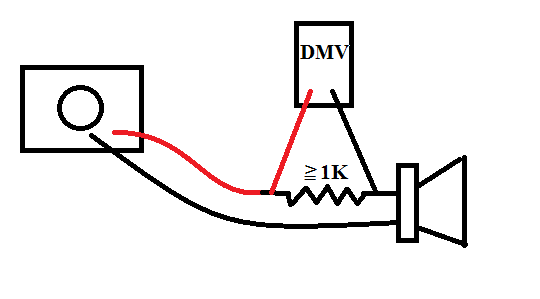

Well JLH, I'm still struggling to get useful resonance data out of my system .
I fitted and sculpted some closed-cell polystyrene to my box ( 5.2L empty ) last night , reckon I got below 2L of free space with the driver fitted .
Testing with my solid-state Pass F4 amp , and a 270R series resistor , meter across the speaker , I could get some sort of minor 'blip' around 200Hz, then nothing until a broad impedance peak around 55Hz , well below the horn's range.
If I then try the Romy trick of opening up a gap on one side of the enclosure , I can see the impedance peak move slowly to 65Hz, 70Hz and then back to 80Hz with it completely taken off . Nowhere do I see a peak in the 100-150Hz range. It's most peculiar .
I'm expecting the peak to be reasonably obvious, if it's there, right ?
Maybe the polystyrene isn't dense enough ?
What I will do at the weekend is get some of that hard-setting spray foam and try to get a really small volume and work from there .
The peak should be very obvious. Try using a 1K series resistor and place your voltmeter across the resistor. Slowly sweep up in frequency starting at something like 30Hz. Also, you don't need much voltage, something like 150mV AC will work just fine. If you are doing this with your tube amp, then I'd suggest just trying with your function generator directly or get a small solid state amp.

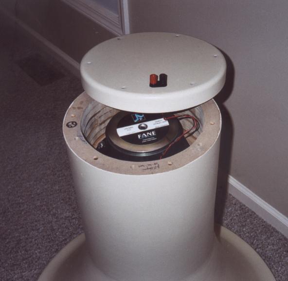

No luck
Tried everything I can think of so far.
Built a bigger back chamber ( 7L ) then filled it to create a really small back-chamber .
Cannot get a resonance peak to appear . Only way I've seen one so far is without a back-chamber .

Given up & waiting for the Fane drivers now. Hopefully with them something will start to make sense.

Hey Mark,
Haven´t followed this thread all the way. But I guess you measure the resonant peak without horn, only with box?
Lars
How am I going to measure the resonant peak without the horn ?
The box fits over the back of the driver, attaching to the horn rear flange.
We're looking for the resonance of the system, surely ?
There has to be something wrong. I just setup a quick measurement check with one of my 8PE21 woofers and it worked fine. I tested it in free air and unmounted. I set my function generator to 500Hz and adjusted the voltage output so that 2 VAC was accross the 1K resistor. I then slowly turned the frequency down while watching the voltmeter. You are looking for the lowest dip accross the resistor. For me it dipped the lowest at 97Hz. If I continue to reduce the frequency the voltage accross the resistor comes back up. Make sure you are going VERY, VERY slowly. The dip is very narrow.
You can do either. The goal is to get the resonance at the right place. But off course it must be the combined result that counts. The reactance annuling idea is to have the horn and driver-in-chamber resonace to coincidence. But I think JLH found the chamber should have a slightly lower resonance-point.
Yes
Yes, well I've measured as shown and with voltmeter across the driver. The dip becomes a peak when you measure across the driver, and is more obvious, as long as you feed enough volts into the combination. The high output impedance just means the voltage across the driver tracks the impedance - I understand this .
As I said earlier, I was able to easily measure the driver+horn resonance without the back-chamber - this was 80Hz . It was obvious and quite sharp . I can measure the driver alone at some stage just for completeness if you like . I can measure the other ( not run-in ) driver this evening .
Now the problem is that I lose any form of resonant peak in the expected area once a chamber of ANY size is attached over the driver. I've scanned widely and I've scanned slowly . It's not as if there's a 'bit of a ripple' or a small peak or dip or anything - there is NOTHING ...other than a broad peak lower down, around 50 or 60, which must be something else.
