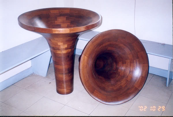

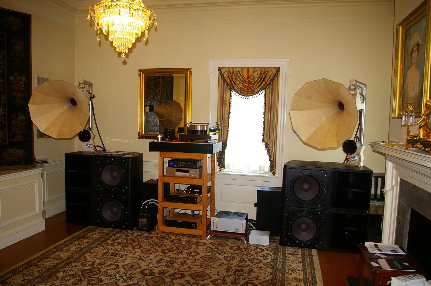

I'd love to buy the Eleven Horns 140Hz Mahogany horn.....90Kgs, 90cm diameter...!!!
Eleven Horns - lower midrange horn.... 140 Hertz Le Cleac'h...

The 130 to 150Hz horns around the 800/900mm diameter seems about right.
Could the 40" horn be 100Hz and not 200Hz?

Note this is Le´Cleach. 40" is exactly what you get when using Jean-Michels spreadsheet for Fcut=200Hz. Ie the Elevens are compromises.

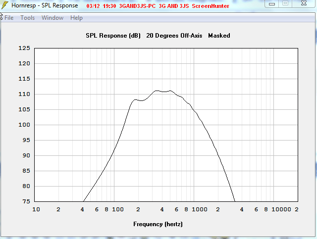

Hey 3GGG,
As I understand it you will use Hornresp for your design. Remember that "Constant Directivity" is useless(almost) except for basshorns, you should use "Directivity" at preferred angle instead.
I guess this is more of a midbass design for 2*Pi. A full 130Hz Tractrix has a min. length of 66cm2 and a max At of 130cm3.

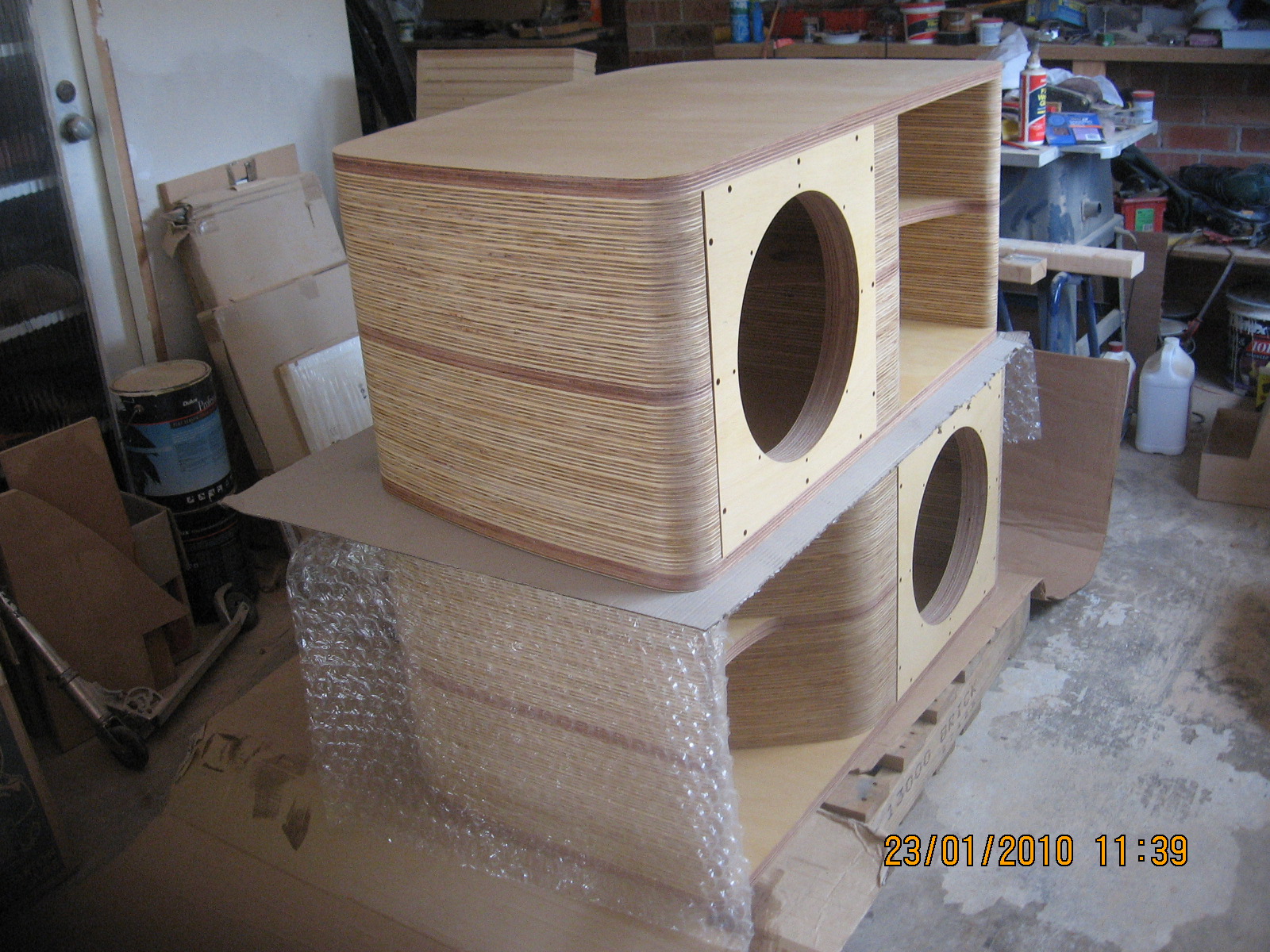

For under 150Hz, why not try the GOTO bass horn, which Ming Su and I developed. It's good for 300Hz, and you can run the Altec 416 driver. I could cobble together a flat-pack kit...
I've also developed a non CNC'd/sliced model...using traditional flat panels. Cheaper option in either MDF or 25mm ply.

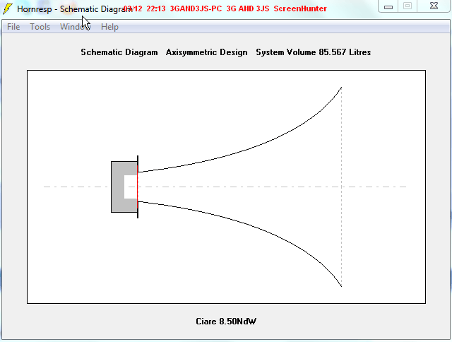

Is the driver going to be compression loaded? Or is it simply a speaker firing into a horn. IOW, is the throat area "smaller" than the driver's area?
416 specs here
http://www.greatplainsaudio.com/downloads/416_8C.pdf
Throat is 585cm2, or 90 square inch

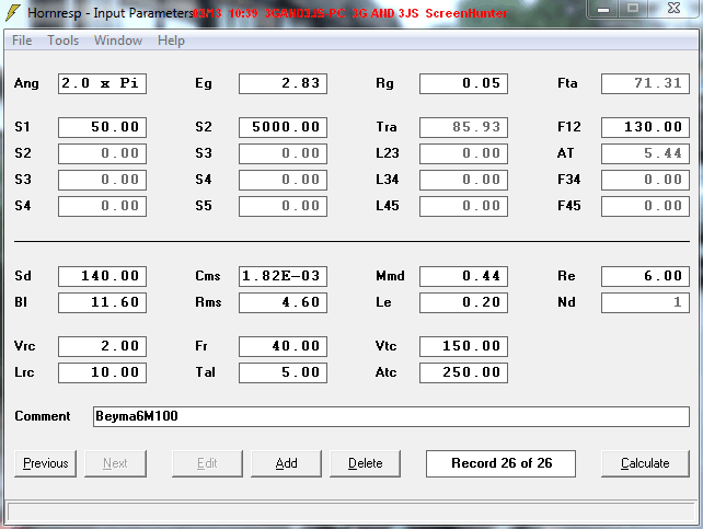

Withtarragon, most of the modeling i have been doing is with a smaller throat area and compression of around 2 to 2.5:1

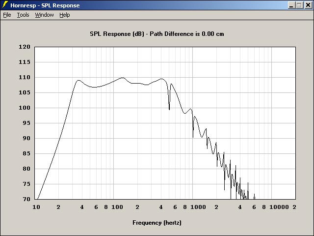

Here's Ming's plot of the GOTO bass unit....nice and flat from 30Hz to 300....at over 100dB....nice.

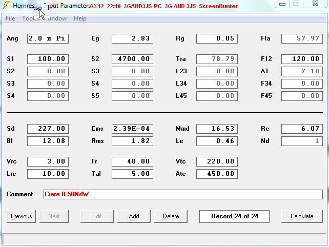

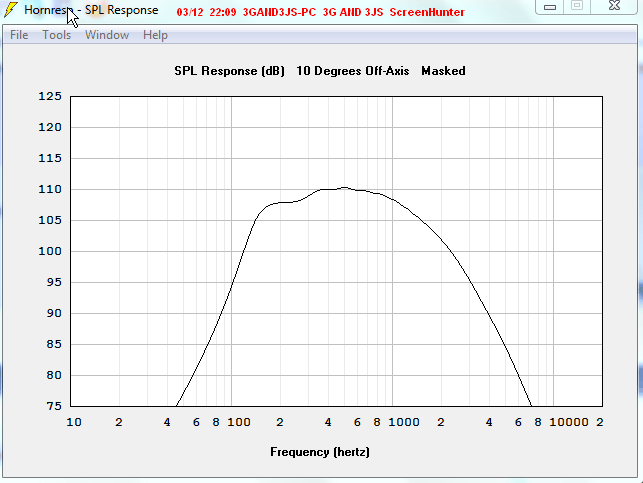

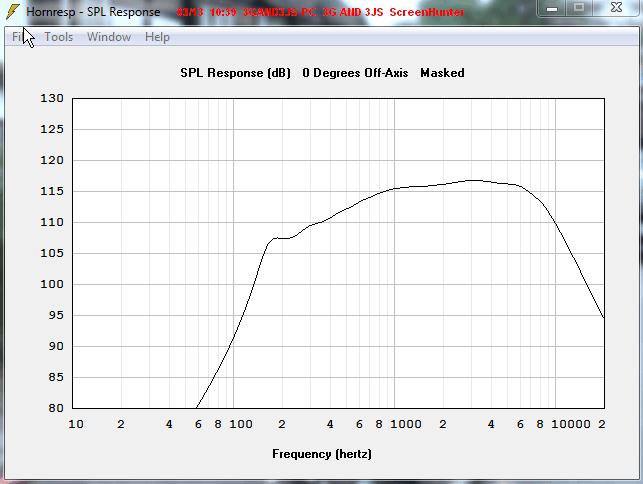

I'm currently designing something close - a 120-700Hz hyperbolic. You might want to consider the B&C 8PS21 , I can't comment on the sound yet as I haven't built it , but it models well for near-axis directivity unlike the 8PE21 which has a rather too rising response on my sims . The distortion curves on that (8PS21) driver look nice if you check on Zaphaudio .
I already have a pair of 8PE21 and will test them on the first build of this horn when I can .
JLH has much more experience of building & using this driver and others so perhaps he can comment on this .
I attach my current input file for info .
MJ
MJ

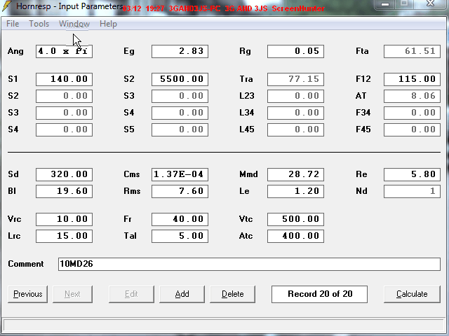

Hey 3GGG -
I notice you used 4-Pi space on your design there.
You are being pessimistic about the low-end in that case, since you are much more likely going to be 2Pi unless you put the horn on a pole in the middle of a field !!
Mark
Mark
Cheers Mark. I was wondering if 2PI may be more suitable. Thw horns will be large but they should atleast fit inside a room;-)
The Ciare 8.50NdW is a real bone crusher when pushed hard. It has a crazy mixture of sensitivity and Xmax. You'll be able to hit over 120dB easy without even getting close to Xmax. Tone wise, at low volume levels it can sound a little fat or dull. The most articulate of the drivers I listed is the Beyma 6MI100. The 6MI100 can approch high dollar GOTO drivers if it is equiped with a good phase plug. Good middle of the road drivers are 8PE21, M5N12-80, and 8M400. The 10MD26 has the most even tone balance and can play any music material well. It just depends on what you want from your system.
Thanks JLH, your inside knowledge will help alot in my decision making process.
I listen at low to moderate levels and am looking for quality over quantity. The Beyma 6MI100 will get a look in.
