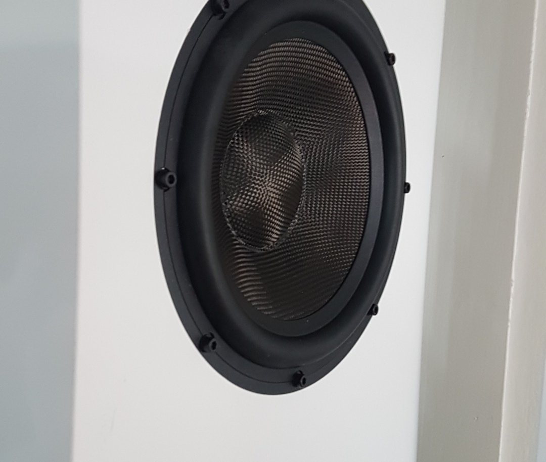

I am leaning toward the SB Acoustics SB23MFCL45-4 or the Peerless 830452 because they fit within that $600 budget (otherwise the SB34SWPL-76-4 12" or the SEAS L26RO4Y would likely be happening if I had $1K-$1200 to spend).

I've got a pair of the SB Acoustics SB23MFCL45-4. They model really well in a small box. I remember Rabbitz comments that they need some juice. I've got a couple 1000watt plate amps I need to try them with, might wake them up.

Very true. In fact, I was just about to post here some simple modeling from winISD comparing the drivers and my assumptions on filters, while having the U18 in there to show that versus the subs discussed. Please take no offense, I just do seek out numerous opinions, especially when learning.
From left to right is the following (all vented (all 120Hz LP filter except U18)):
Dayton RSS265HO-44 2.1ft^3 23.3Hz tuning freq. 1.5"x12"x38.87" port 174.06Hz 1st port resonance HP filter 15Hz LR
SB23MFCL45-8 1.2ft^3 25.8Hz tun. freq. 1.375"x8"x33.98" vent 199.09Hz 1st port resonance HP filter 22Hz butterworth 2
MX12-22 1.066ft^3 33.36Hz tun freq 1"x12"x24.29" vent 278.52Hz 1st port res. HP filter 10Hz LR
XLS-P830452 0.488ft^3 41.58 tun freq. 0.875"x10"x25.38" 266.56Hz 1st port HP filter 15Hz LR
U18RNX-P 0.644ft^3 48Hz Tun. Freq. 1.5"x7"x16.32" 414.5Hz 1st port res. HP butterworth 2 - 32Hz
So you are very much correct that the sub is not adding much to the depth of what the U18 is already capable of doing. Without a doubt I do believe you there (and did before my modeling). And I may go that way, still. The Dayton RSS HO takes a huge box volume compared to what I am looking for, although clearly adds deeper bass. The SB23 is a decent compromise, adding frequency range while being 1.2 cubic foot (still a decent size space). The MX12 is not that far behind on space or bass frequency. The peerless, as modeled, uses very little space (less than even the U18 with a vent), but does not add much with how it is modeled in winISD here (goal before filters added was try to make +-0.1dB from flat). I'm sure I could do all of these modded to get a little more depth and then use the DSP to correct and flatten the line.
That is why I haven't ruled out your suggestion at all. This modeling is also why I haven't fully ruled out the SB23, even though you mentioned people have had issues with it and others here have said they had issues with the model. Because if it could come out close to as modeled here, I would really enjoy adding it.
And it is still a good price. And it really looks like I would enjoy it. I just would not be able to swing it at this moment with how I envisioned the build (although if I change what I envisioned, then it is something I am considering).ajc9988, the seas l26 subs do really well down to 30hz in fact better than most 12s. Below that you might need the help of a port or a high pass filter. Yes, I do have mine on ebay. Not yet at a bargain price but it's hardly used.
