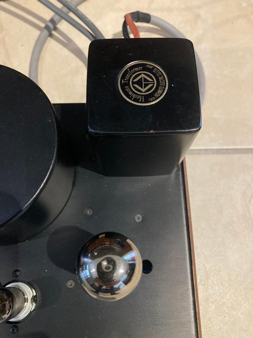

I also use the H203S for my 2A3 version of the 45 Monoblock referenced previously. Really great iron in general. I can say the same for their filter chokes and power transformers. For all of my current and future gear, all iron is Hashimoto.

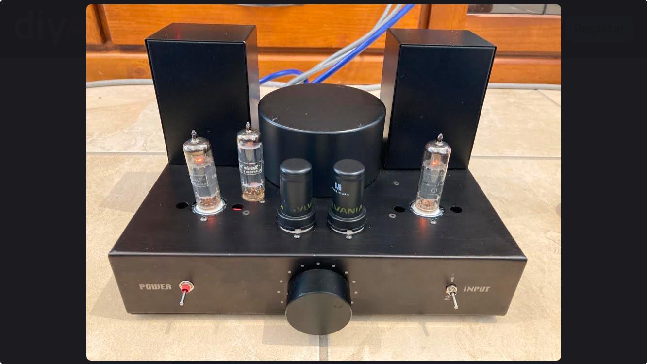

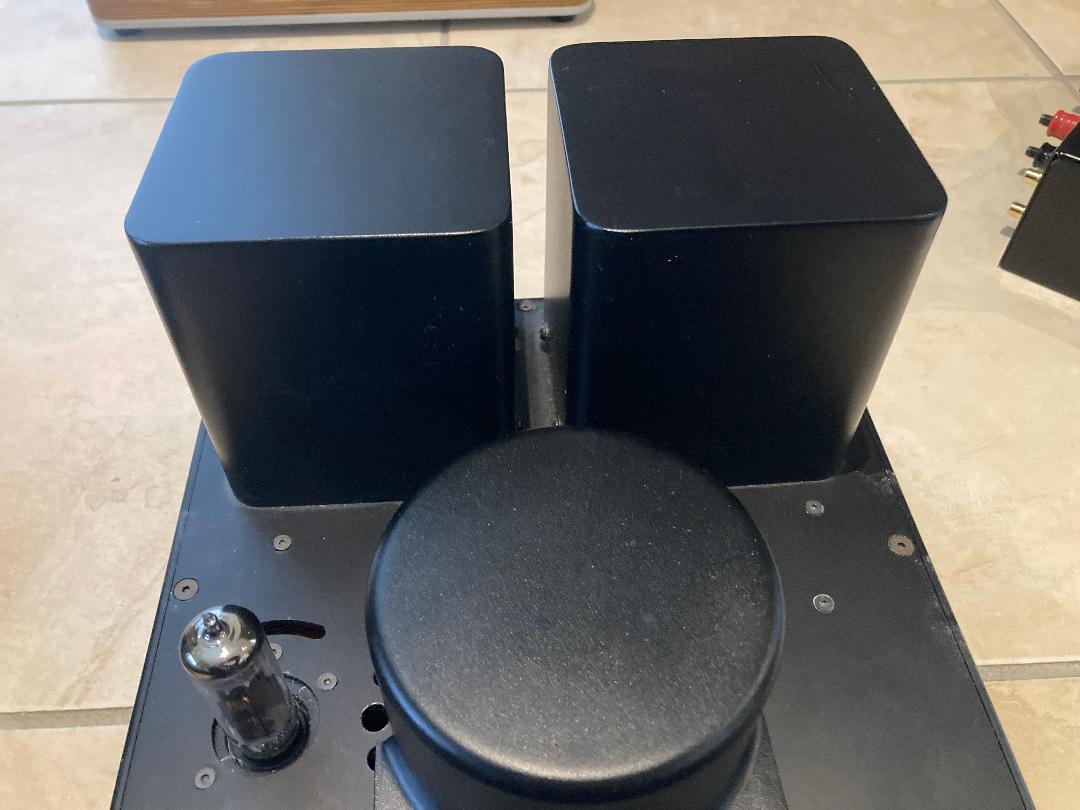

If I may add, I've used the H203U and H203S. The H203U may have better specs and look better on a scope. But driving real world speakers, the slight edge of the H203U (EI lams) in the bottom end is offset by a more vivid midrange and richer top end overtones from the smaller C-core H203S.
I chose the H203S over the H203U for my mono hifi which usually drives an Altec 756B + 32C/806 and don't find the bottom end lacking.
