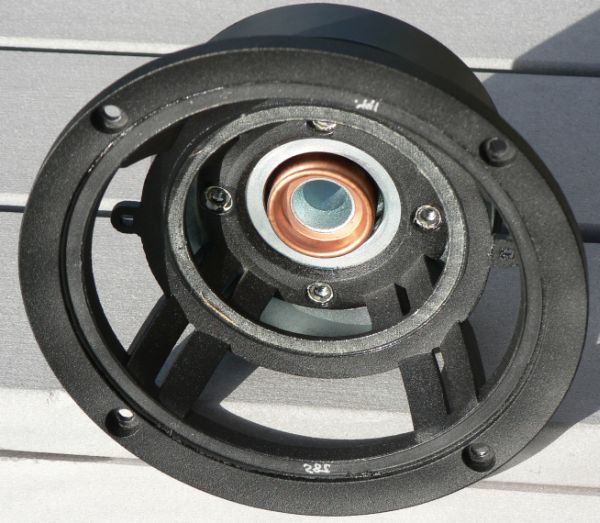

The SB15NRXC30-8 is a very well built driver and up there with Scan Speak on build but not quite there on sound. For most part it does very well, bass punches well above it's size, very clean and open, but there is an odd hollow quality in the mids. Doping the cone did improve it but some still remained.
Even though a nice driver with a great motor and look at the build and copper used on the pole piece, but for me the cone material let the side down. I think you can get an uncoated (non poly coated) version which may be different (better or worse?).
The Audio Technology stuff looks nice, but as you say very expensive. The 15H looks similar in size to the TB W5-1611SA, though maybe that's where the similarity ends.
As for cone material, I've generally been satisfied with the metal cone drivers for detail and transparency. Not entirely so with warmth. Rabbitz rates the cone material on the SB as disappointing, and I do believe you can "hear" cone material in the overall sound. I quite like the Bextrene of the Audax unit I have, and the B110 was popular enough especially when the 1.5k alleged resonance was flattened. I believe Bextrene was polystyrene and died out along with some other materials.

Zaphs site is a wealth of information. If you can get the c/o point
down to 1.7kHz (see some designs on his site) then its actually
fairly easy to deal with the SB drivers minor 1.7kHz dip as you
can adjust the c/o Q to compensate.
Just need the right tweeter to go that low.
See the SB29 here : Zaph|Audio - Design Contest Results
