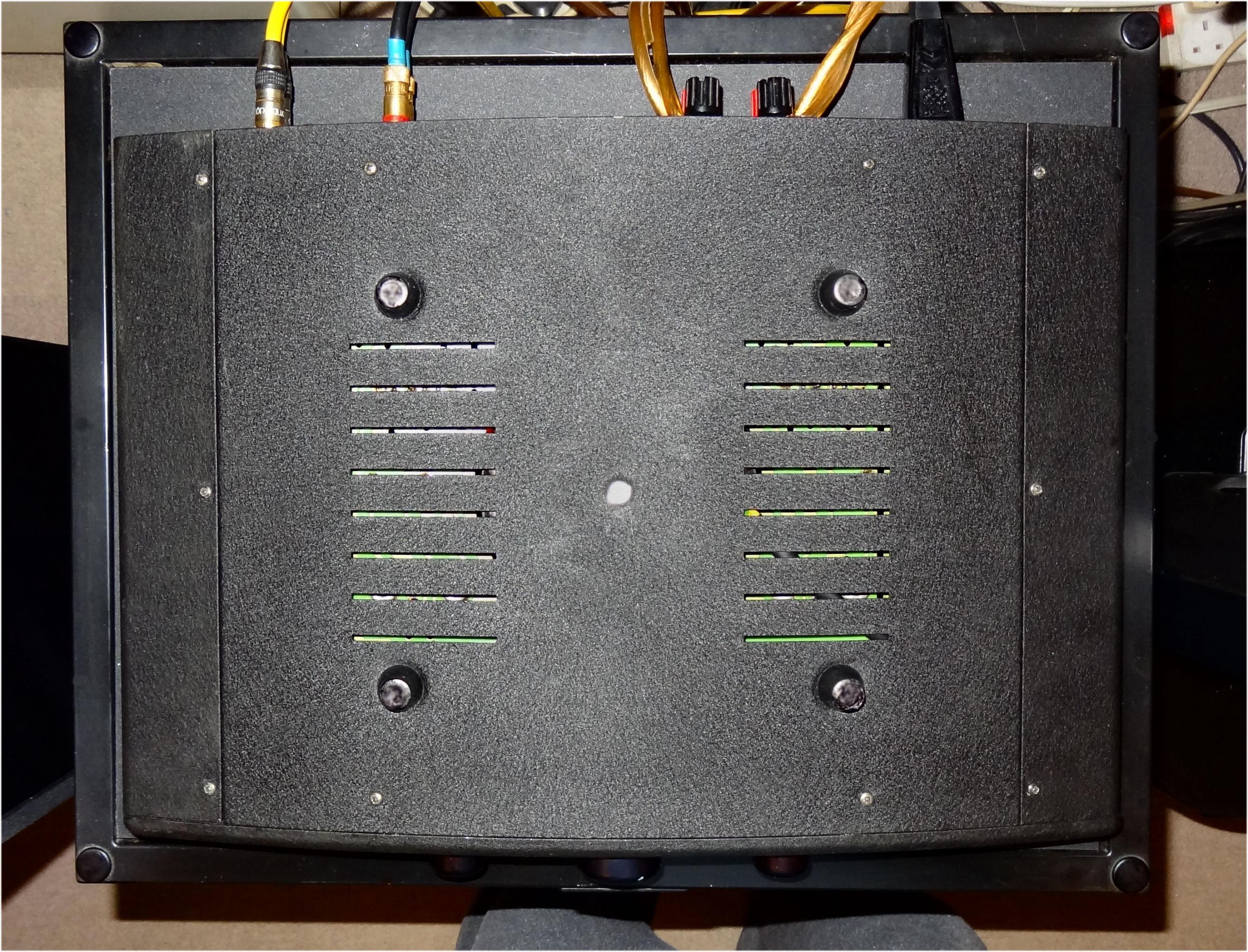

All of the amp looks as though it is made from metal and aluminium, there is no plastic anywhere in the construction that I can see. The top and bottom panels appear to be made from steel covered in a crinkle effect paint. There are 6 small Allen screws on the bottom of the case which once removed allows the top and side outer shell part to be slid off backwards over the rear panel.
This leaves the front, back and circuit boards as one piece. To get to the under side of the circuit board you then have to remove the thin center bolt that goes through the top of the toroid AND bottom of the remaining case, you then remove the four long black screws that hold the main circuit board via ceramic standoffs/spacers to the curved bottom, the same long screws also hold the feet on. Now the bottom panel comes off exposing the under side circuit board. Of course once you have done this you need to support the toroid with one hand to flip it over and work on it (as it is now free to float about attached by a few wires) and the main circuit still board attached to the front and back. This is a tricky procedure because now the main circuit board is quite bendy and the front and back panels are thick and heavy. There is no other panel/shield directly under the circuit boards.

Picture is of underside.

That means that the metal chassis (which has to be connected to AC mains ground to meet regulations) is only grounded to AC ground through the xformer bolt. I have to agree with others - I wouldn't do that, and would have taken it direct to chassis with a substantial fly-lead to the central ground or input grounds if they weren't already on the chassis.
As things are, it will mean that you will have a shorted "turn" on the xformer, but maybe as others on this thread have pointed out, that won't have a disastrous effect if the loop resistance (bolt connecting leads) isn't very low.
I have found that the effects of different grounding arrangements can be quite difficult to predict, even when you follow best practice. If that amp were mine, I would try it as it is (as the designer intended it), and see what it's like. If the designer tested it thoroughly, then the spec should be ok. Others on the thread are right - rerouting those bolt connections direct to the chassis somewhere shouldn't make things worse - but it may not make a difference either. But it remains a mystery to me why they decided to do things like that when it would have been relatively easy to ground direct to chassis. Perhaps the deigner was just so p------ off with the marketing people's curvy design by the time he got to that point, that he just said "sod it I'll make this bit easy" at least!
Yeah it doesn't really make any sense. In the picture though you can see there is another earth wire soldered to the same lug that I think goes to the chassis underneath, but then why even route it to the top of the transformer in the first place.
Do you think it would be better if I were to remove the earth lug/point with the 2 wires on from the bolt at the top of the toroid and solder/fix them straight to the chassis?
Don't mess with the grounding until you know where all the wires go. There are 3 wires on the transformer bolt: One to the IEC socket ground pin, one presumably to the ground bus on the circuit board, and one to ???. Provided that there is no other connection from the circuit board ground to the metal enclosure, there will be no shorted turn.
Don Hills 9.02am - I think you're technically right, but it would surely still leave you with a metal casing floating at slightly non-ground potential (measured against AC supply ground), which seems distinctly weird - and probably not allowed by international standards. It would be interesting to measure voltage between external metal case and the tags at top of the bolt - if there is anything measurable. I have been assuming that the two other connections to the bolt (apart from the IEC connection) are the grounding for the two channels on the pcb - good practice to separate these and run them separately to central ground point for minimisation of cross-talk - but not always done. But then, how is the ground for the DC supply connected in to all this?
