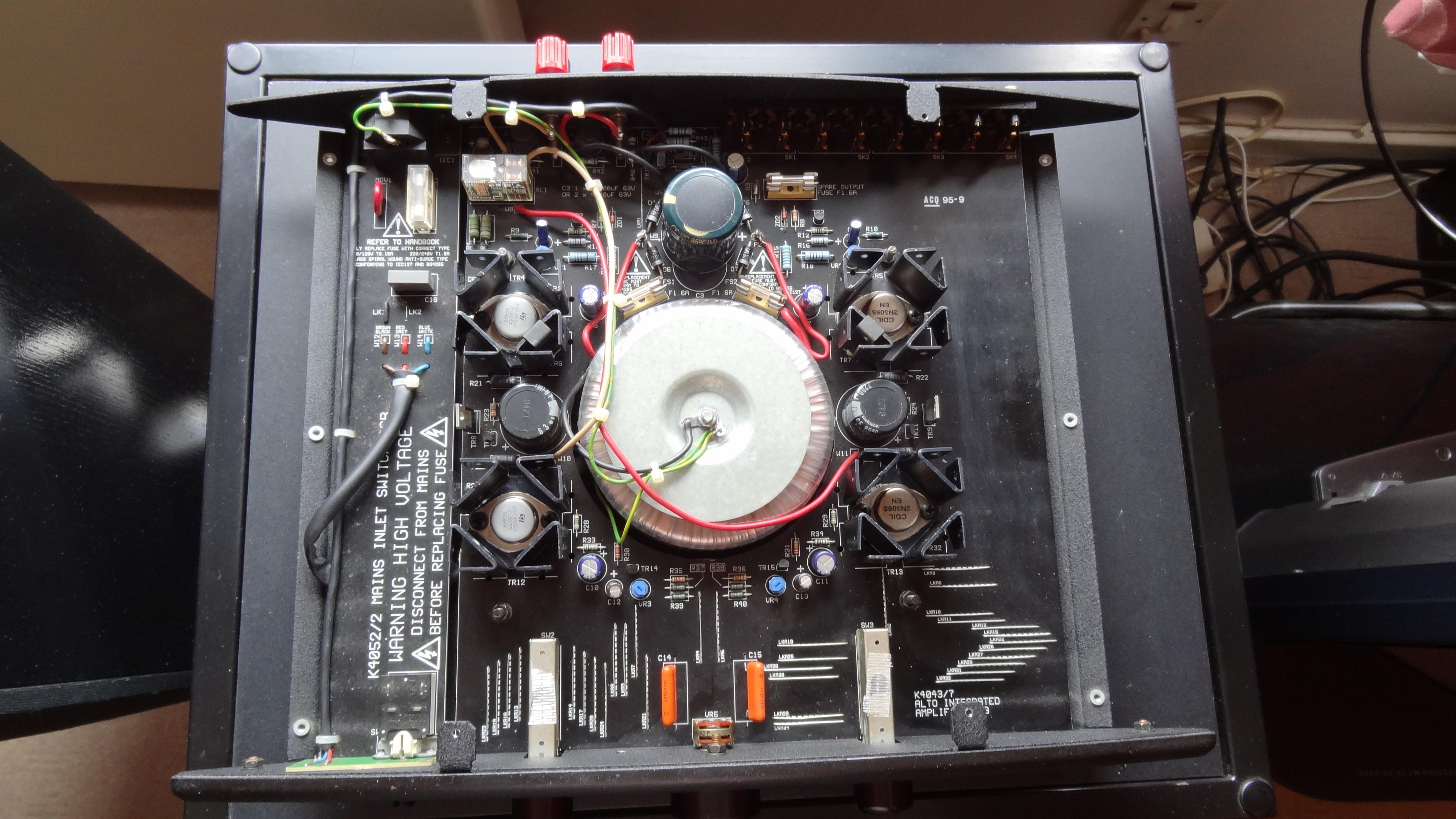

Hi I recently replaced a blown channel TR's on my Audio Innovations ALTO mk1 amp, the originals were ST 2n3055, I replaced the blown pair with CDIL 2n3055 which I don't think sound very nice compared to the ST2n3055. I did re-bias them as per the circuit diagram. Does this mean I have poor quality or fake transistors. I think the amp sounds really nice and would like to keep it, so (No jokes about the old design please)
I have also replaced the the output DC blocking caps and power cap.
I would like to replace all of the output transistors with better devices or at least keep them all the same like the ST brand. (Does anyone know where I could get some from in the in the UK) I have limited electronics knowledge unlike some of you fine chaps.
I would be grateful for any advice.

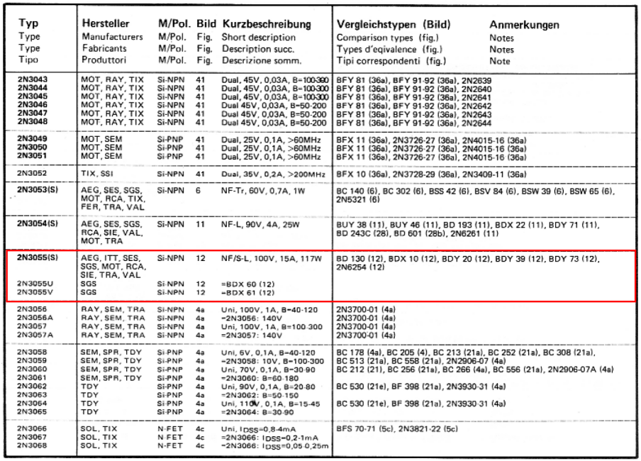

The problem with the 2N3055 is that it is such an old device (historically) that you find the offerings available today are somewhat different spec wise. The ST device (according to the ST data sheet) has for example an Ft of over 3Mhz (on a par with modern devices) whereas I think of the original 2N3055 as struggling to reach 600khz.
The CDIL spec shows an hfe of 5 (minimum) which strikes me as appaling tbh
I'm thinking something like the OnSemi MJ21194G might be a suitable replacement.
MJ21194G - ON SEMICONDUCTOR - TRANSISTOR, NPN, TO-3 | CPC From This Range

Thanks Mooly, So it looks like those CDIL trannys are pretty crap then, no wonder the right channel sounds terrible compared with the left (ST) I thought I had wax in my ear until I started mono comparisons with both ears.
So the ft is important like the hfe for good sound?

You will find some useful discussions on substituting 2N3055 in the Quad forums. I believe the Quad 303 used what were essentially 2N3055 equivalents, but individually selected for a wider SOA. The contributors to those forums have done a lot of thinking about and testing of substitutes.
They do give a caution though - watch out for stability issues. The original 2N3055s had a pretty limited frequency response (as you mention), which contributed to the 303's "bombproof" reputation. There is a risk that substituting higher fT types will turn a stable amplifier into an unstable one - either ruining sound quality or even causing OP stage to self-destruct. Those Quad forums are well worth looking at.
Two things:
First, you changed also many caps and not just the blown output transistors, so you cannot be sure that it's them making the sound worse.
Second, careful in replacing old trannies with much faster ones, you can get into oscillo-land.
Yeah, you may be hearing oscillations. You can't buy real 2n3055, everything is faster. On dynaco ST120 amps, we put ~22 pf between base and emitter of the driver transistors ahead of the output transistors. Faster output transistors should give better sound according to the simulations done by someone on the Leak Delta 70, but oscillations sound bad and consume the transistor doing the wrong thing. I've never heard my ST120 with the original 2n3772 or RCA 5 digit (high Vceo 2n3055), those were burnt up when I bought it, but with NTE60 (probably MJ15003 equivalents) it always sounded okay at decent volume. Not nearly as vile as the reviews in 1966 said it was. It did have a low volume distortion, that is another issue.
To detect oscillation without a scope, if you have an old fashioned VOM with a 2VAC and 20 VAC scales, put a .47 uf (microfarad in newspeak) capacitor in series with the input on VAC and measure the output with the input shorted. Any significant voltage you can't hear, could be RF oscillation. Then change the cap to 470 pf or something. Still have significant AC voltage on the output, for sure it is RF. This test won't work with DVM's, they just produce random numbers when subjected to RF oscillations.
Personally I like the MJ15015G as a sub for the 2n3055, they are about $3 cheaper than MJ15003 and about $2.50 cheaper than MJ21194G. They also have a higher Vceo which is important in my ST120, and they have a specified safe operating area, which hadn't been defined in 1966 IMHO. They are faster than 2n3055, however. Put the little caps in on the drivers, and if you don't have a zobel network on the output (12 turn inductor in series transistor collector junction to speaker hot, 1 k resistor and a cap in series between speaker hot and speaker ground) add one. See the "TIP mod" for the dynaco ST120 on greg dunn's website. This mod is probably a good idea for any original old PWB designed to drive 2n3055 or earlier that wasn't tested for parts faster than that. You can make the inductor by winding any old thin wire around a china marker or fat grade school pencil. Dynaco had you wind them around the output caps, rather quaint.
