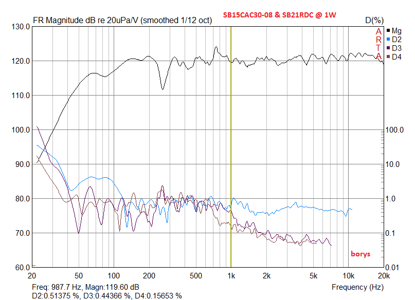

SB21RDC is a very good tweeter. I have used it couple of times with decent results. Very good dispersion, plenty of details. In its price range it is my favorite tweeter. I like it more than 26ADC (and I had good few of them).
The THD plot of sb21RDC is not properly scaled, it is around 1W. I will do some more measurements after I will finish up new calibrated measurement box.

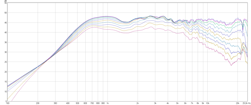

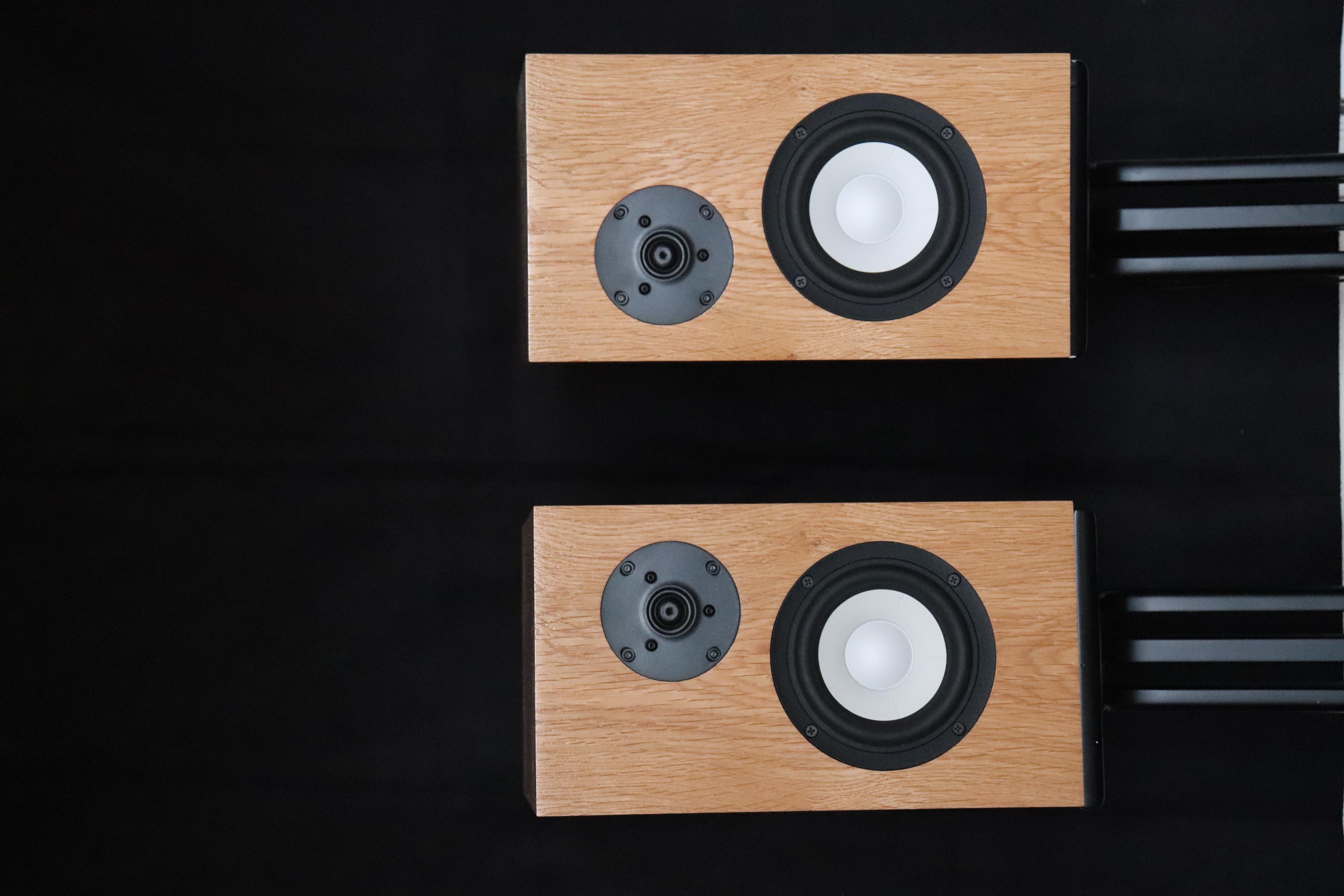

thank you, i will try upload some pictures. the problem i have is high in freq, above 5khz, there is a lack of dispersion, for 1 inch domes s-s "hds-tweeter" did best but not as good as the sb19. i am tempted to try a "small" ribbon after seened this
Even a 34mm tweeter can have dispersion that shows less beaming than this. I don't think your issue is related to dome diameter. I guess you need to look at the implementation of your speaker(s) as a whole. You might also look into waveguides in order to tweak the dispersion / beaming, considering the speaker system as a whole.
Yes, for R2004.

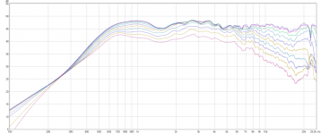

For D2004, horizontal dispersion is not bad at all. See my measurement in finished loudspeaker, tweeter only, no crossover.

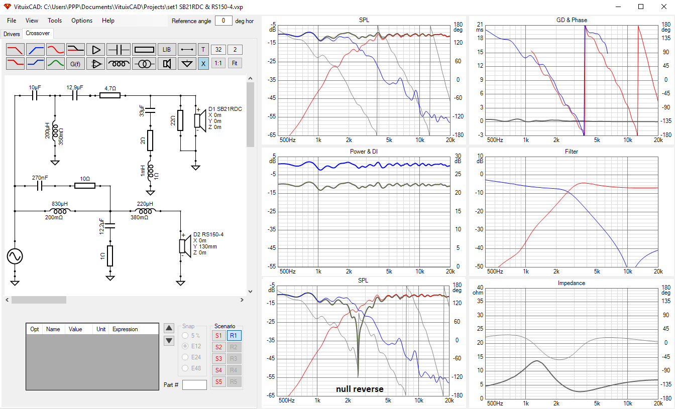

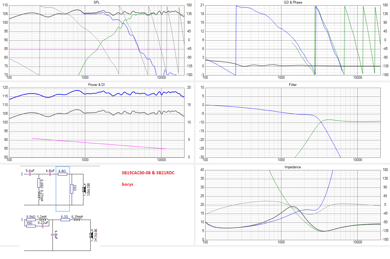

borys, can you tell me a bit about the SB15CAC and SB21RDC plan you have posted here?
