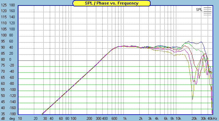

-Study the polar response of the midrange around the crossover frequency. If beaming is present, the soundstage will be unstable.
