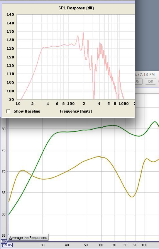

I found this statement to be extremely compelling so I did a quick sim using tb46's Hornresp inputs for the Keystone in post 96 of the Keystone thread compared to a ported box. Both sims use the B&C 18tbw100, both shown at xmax. The ported box is half the size of the Keystone. The ported box is obviously the light grey line.
Clearly the graphs don't tell the whole story, the ported box will suffer more from both power and port compression than the tapped horn but the answer doesn't look quite so simple to me. I know you've mentioned that you get different measured results than simulations predict but this simulation shows that either you are exaggerating a bit or Hornresp has no correlation to reality at all.
As David McBean has mentioned, he is a programmer, not a cabinet builder.Both sims use the B&C 18tbw100, both shown at xmax. The ported box is half the size of the Keystone. The ported box is obviously the light grey line.
He relies on builders to convey differences in the actual results to predicted.
Many builders have noted that Hornresp often exaggerates peaks and dips.
There is also the basic problem of Hornresp using a circular expansion, while very few bass horns are ever built in that fashion.
I find his program quite useful, though seldom find exact correlation to the actual builds.
The actual measurements and performance of a cabinet are more useful to me.

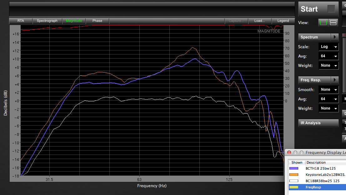

Of interest, the ported cabinet does suffer from "port compression" at high power levels, having less LF compared to upper output, while the tapped horn is the inverse, LF gains linearly, while upper output reduces.
The results below are the ported cabinet and the Keystone, both loaded with the BC18SW115-4, and a pair of Lab 12s, each measured in the same place outdoors, same amp, filters (25 &125Hz BW) same pink noise output.
I have no reason to lie about any test results, the only way to learn how (and how well) a design works is to measure, listen and compare. If the results are not good, change the box (or driver) until they are.
The Keystone design encompassed more than 100 separate cabinet changes and tests to determine the results of those changes.

I should not have posted any Hornresp simulations for the Keystone sub (even though I noted that they do not take the Keystone mouth into consideration) as these simulations only lead to confusion. Because of the Keystone exit (mouth) Hornresp will not arrive at a correct simulation. It really does take AkAbak to get close on this one. Djim tried different methods, e.g.: see Page 13: http://www.diyaudio.com/forums/subw...ng-18-15-12-inch-speakers-13.html#post2933411 . Even Tom Danley states that measurements beat simulations.
PASC build a Keystone sub and posted pictures and measurements in the Keystone thread. He seems to be very impressed with the results.

This matches my experience, my sims overlay my measurements almost exactly. I've had problems a couple of times with nulls in the 80 - 90 hz region which is most likely due to having multiple segments of the physical build having the same length and being long enough to cause nulls based on their physical dimensions.
I agree with your assessment that response can change with extremely high power level but I'm not seeing the large discrepancies that you are talking about.
In the simulation I provided the ported box needs quite a bit more power to hit xmax than the tapped horn, so I'm not sure this is a fair comparison. A more fair comparison would be to apply enough voltage to each box to get it to the point of onset of clearly audible distortion. And to be fair, to accurately compare there should be more details about the ported box. All I know about it is the driver used. No info about tuning frequency, volume, port size, etc etc etc.
Please understand that I'm not trying to give you a hard time but I'm not seeing the gross discrepancies that you are describing. I can see power and port compression accounting for maybe 3 db difference but not 6. And to be honest, I'm much more interested in the flh vs tapped horn discrepancies you mentioned earlier but that discussion didn't go anywhere. You didn't provide a simulation for the front loaded design.

Understood, but soho54 has shown over and over that accurate simulations match measurements very well, at least at small signal levels. Weltersys has claimed over and over that accurate simulations don't match measurements very well at all. I'm just trying to get to the bottom of this, I think it's in everyone's best interests to determine how much trust to place in our simulations.
I'm not trying to say the Keystone is a bad design, I just don't see it being 6db ahead of a similarly sized and tuned well designed ported box with the same driver when both are provided enough power to get them to the onset of audible distortion (not the same power applied to each).
You provided none of your simulations or measurements...And to be honest, I'm much more interested in the flh vs tapped horn discrepancies you mentioned earlier but that discussion didn't go anywhere. You didn't provide a simulation for the front loaded design.
I used a Hornresp FLH simulation that did not represent the actual results.
It would be of no use to post up a simulation that bears so little resemblance to the finished cabinet.

Looking at them it appears the low corner as measured is about 4 Hz higher than simmed, nearly 1/3 octave higher than the sim predicted.http://www.diyaudio.com/forums/subw...oop-folded-horn-subwoofers-3.html#post3409642
In the same thread you requested them.
To me, that is a fairly big difference, but close enough for rock and roll 😉.

In both this thread and that one I stated that I imported this design into Akabak to refine and also shorted the horn a bit to raise the tuning at that time for more max spl vs the shown lower tuning, but kept the response curve shape the same (only the lowest impedance peaks shifted up a bit as a result). Unfortunately I don't have the final Akabak sim anymore but the higher tuning was not a mistake, I did that on purpose in Akabak after this Hornresp data was captured but unfortunately this is all I have left to show.
I'd be more than happy to show you the final Akabak sim and the measurements that I took outside at 10m and well away from any boundaries but I don't have them anymore, I never posted them online anywhere and my old computer died.
In the absense of more accurate data on my part, I suggest we can look at Lilmike's data instead (if you are interested), he's got at least a few examples of very well documented sims and measurements done properly outdoors.
To attain accurate measurements one would need to measure the TS Parameters of the driver to confirm if indeed the TS Parameters are close to the manufactures stated TS Parameters. The majority of designers don't measure the TS Parameters of the actual driver. This is why many attain measured results differing from the simulation.
Further to OMNIFEX's comments -
In Hornresp, fs is taken to be the driver free-air resonance frequency. Manufacturers often don't state under what conditions their fs values are measured. If a given fs figure happens to be for a driver mounted in an infinite baffle, then the Hornresp predictions will be inaccurate. This is one reason why I prefer wherever possible to use the fundamental electro-mechanical parameters as primary inputs to specify the driver, rather being required to derive the values from perhaps questionable Thiele-Small equivalents.
