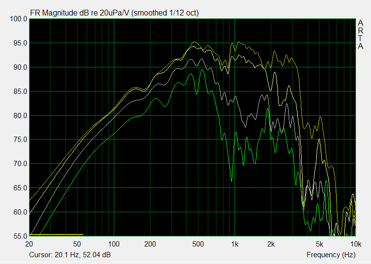

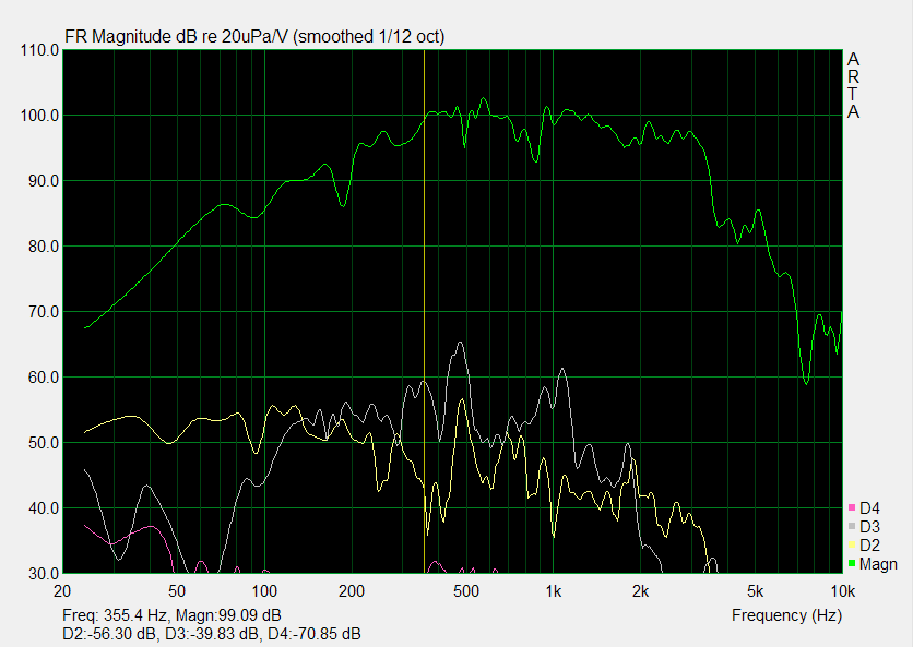

I have been mulling over this speaker build for awhile now. The general idea is that, in an attempt to make the speaker somewhat directional between 500Hz and 1kHz, I would like to mate a large format pro woofer to my SEOS-18 horn. The crossover point will be right around 1kHz or slightly below, and this horn with the right CD will do it.
I was previously planning to use the Selenium 18WS600. I bought a pair and did some ground plane measurements (driver alone, no baffle) on and off axis to get an idea of what I was up against. These are attached, below. This is a dipole-type response and in a box the frequency response will be different. Specifically, the drooping response region below 1kHz may be completely different. Distortion (See plot below) remains relatively low at this power level (1W ish) so this driver could work. I did not make any waterfall type measurements, which might be something to check first.
I've always wondered if there was a better choice in an 18" format out there, that would give me a little smoother response through 1kHz. So I thought I would throw this out for comment to the forum to see if anything new is out there that would work better than the Selenium drivers I already own. Is there anything?

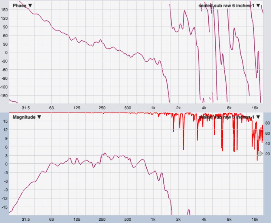

It's a bit pricey, but the bms 18n862 has worked very well for me sealed, single vented, and double PPSL vented. Josh Ricci describes the driver as a cross between hi-fi and pro-audio...
Below is a raw response in sealed box, mic about 6" from dustcap. 1/12 smooting mag and phase

Good morning Charlie! How are things in MI? The measurements you posted are pretty typical for a low - mid cost 18" designed for PA sound reinforcement applications. So, it comes down to the usual trade offs driven by cost, box size, efficiency, low end cut off and all the rest. I have used a few of the PE 460-8. The frequency plot is pretty close to what they publish. T/S specs have been consistently per published data also... not bad for a driver that can be had for $90 - $100 each including shipping. J
Hi John,
Great to hear from you. Moving to MI has really put a damper on my DIY efforts but I am starting to get up and running again now. I have the Selenium drivers already, and am trying to do a cost-benefit analysis before using them or buying a different set of woofers.
The low end performance is not important for this 2-way home audio PA-monitor-style design. There would be a separate sub or subs below 100-150Hz with the woofer+horn in a sealed box. OR at least that is the plan.
The use of the 18 is primarily for pattern control below 1kHz.
The BMS 18n862 is more of a subwoofer and the response barely makes it above 1kHz. I'm looking for an 18" driver with extended mid-frequency performance and low distortion. This is often an underhung v.c. type design like the Selenium.

The SEOS horn, from the measurements I have seen, loses pattern control (becomes more omni) below about 1kHz or so. So I if put the crossover point around there and combine that with a large driver that is starting to beam, my thought process is that the two will combine to create a smooth transition from the 18 below, to the horn above, 1kHz.

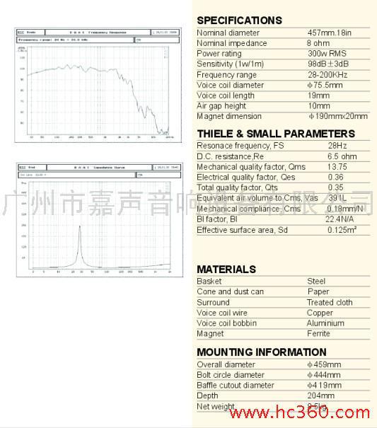

If I may, this is the info of the cheep driver.
Zomax PF-1875190K
same model rebranded is
Martin Wisman Kappa 18
Very good LF extension, reasonably extended highs regarding of the moving mass.
And ofcourse is not for the huge stated power but for home use is good.
I listened these drivers even in the OB cabinet 2xMartin Wisman Kappa 18 per chanel, and they performed very well.
