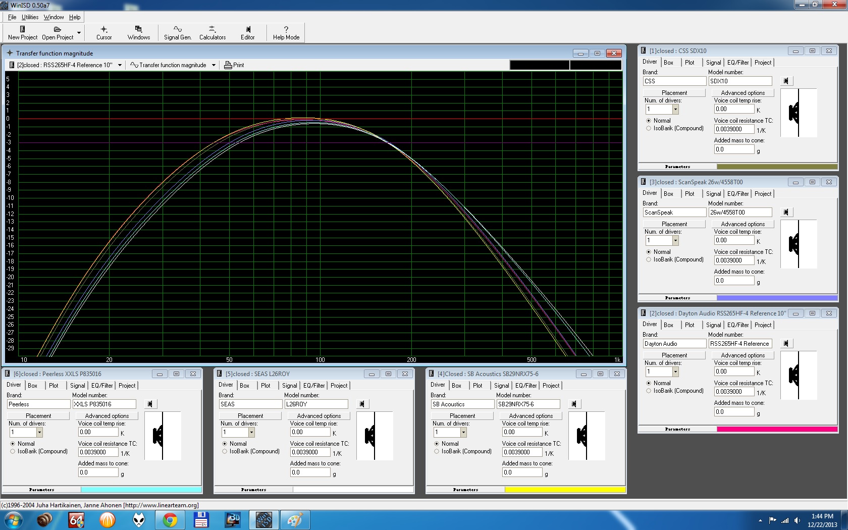

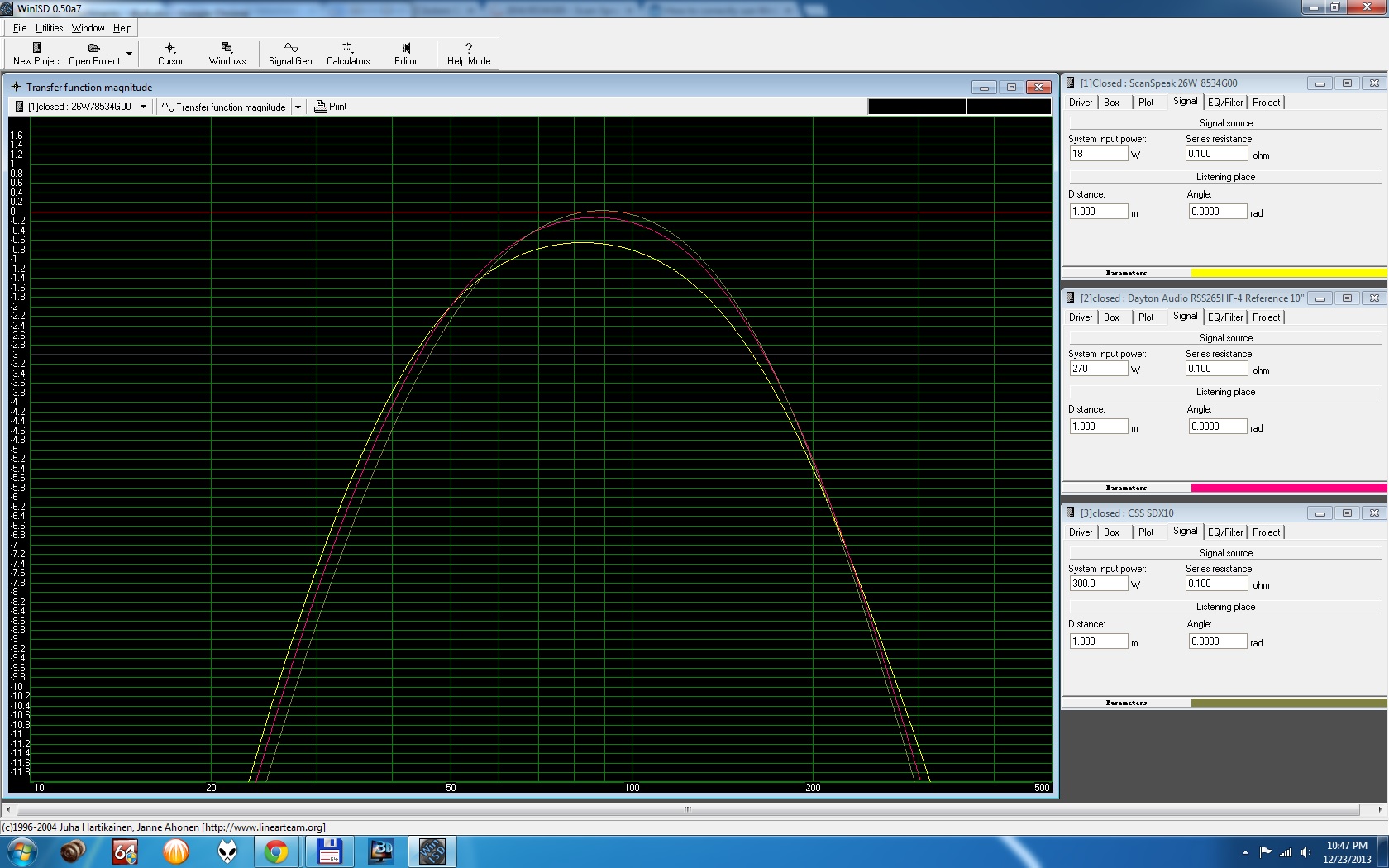

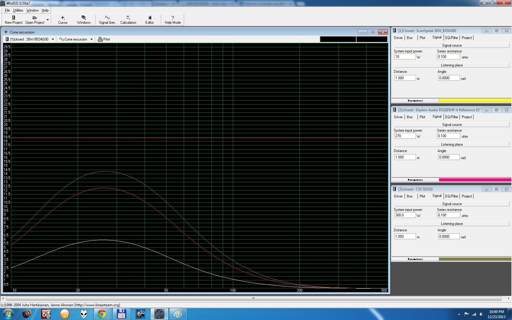

Starting from these inputs I have used WinISD to do some modeling.
Used parameters are:
Qtc=0.707
Ql=15
Qa=20
As filters I used (the frequencies are from Wyntek amplifier, I don't know the type and order from this amplifier so I considered Butterworth Order 2):
- Highpass Butterworth Order 2 with 16 Hz Cutoff
- Lowpass Butterworth Order 2 with 160 Hz Cutoff

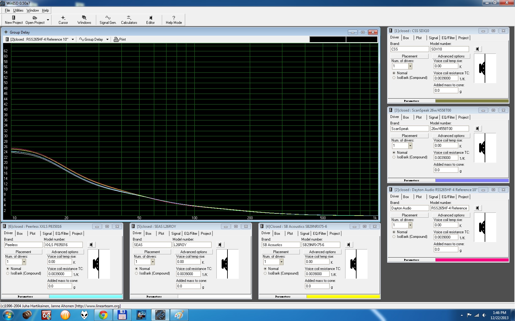

As you can see in the attachments the drivers with lowest F3 are:
1. SB Acoustics with 44.28 Hz
2. Dayton with 44.34 Hz
3. CSS with 46.10 Hz
As Group delay al 6 drivers are very close.

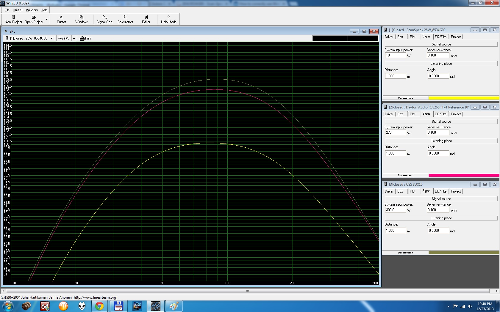

As SPL:
1. SEAS with 109.7 dB
2. CSS with 109.6 dB
3. Dayton with 108.1 dB

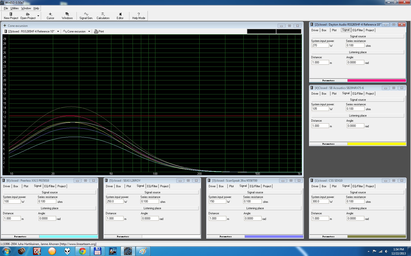

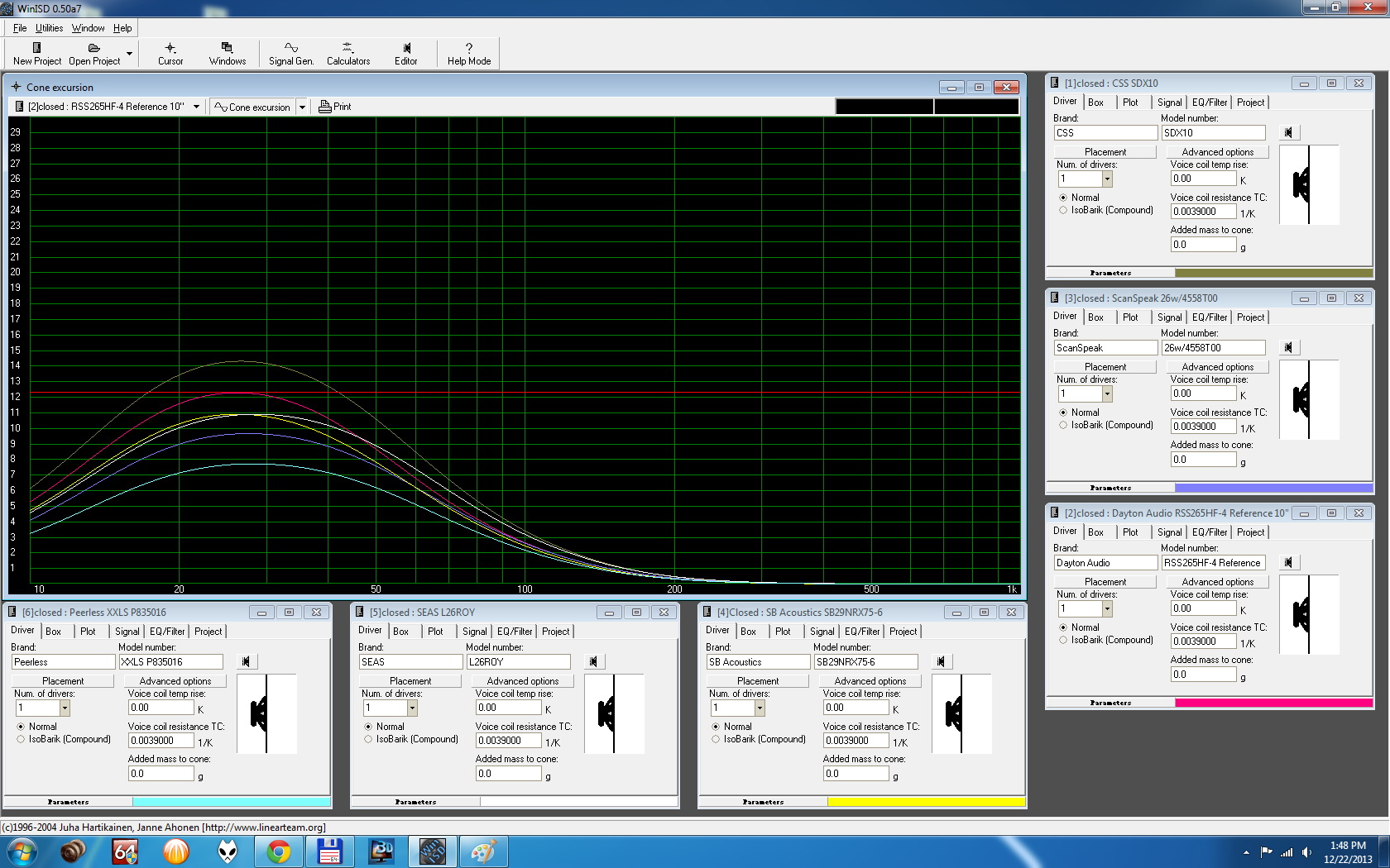

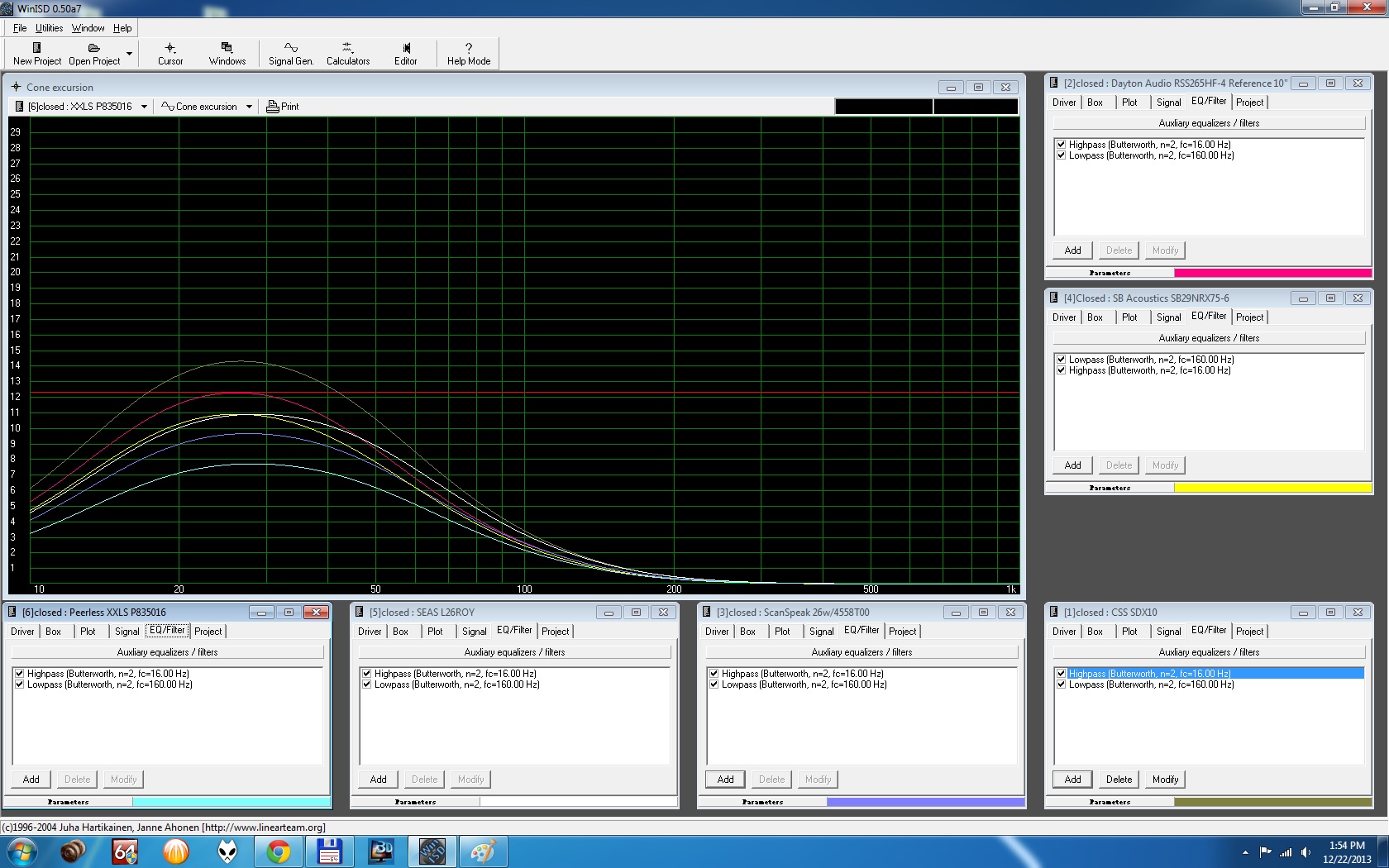

At Cone excursion I have used the power which will lead to maximum cone excursion where this power was smaller than rated power (Dayton and SB Acoustics) or the rated power in case that the power needed for Xmax was bigger than rated power. If I use the power for Xmax for some drives I will need more than 400W which is way beyond rated power and my price range and needs…

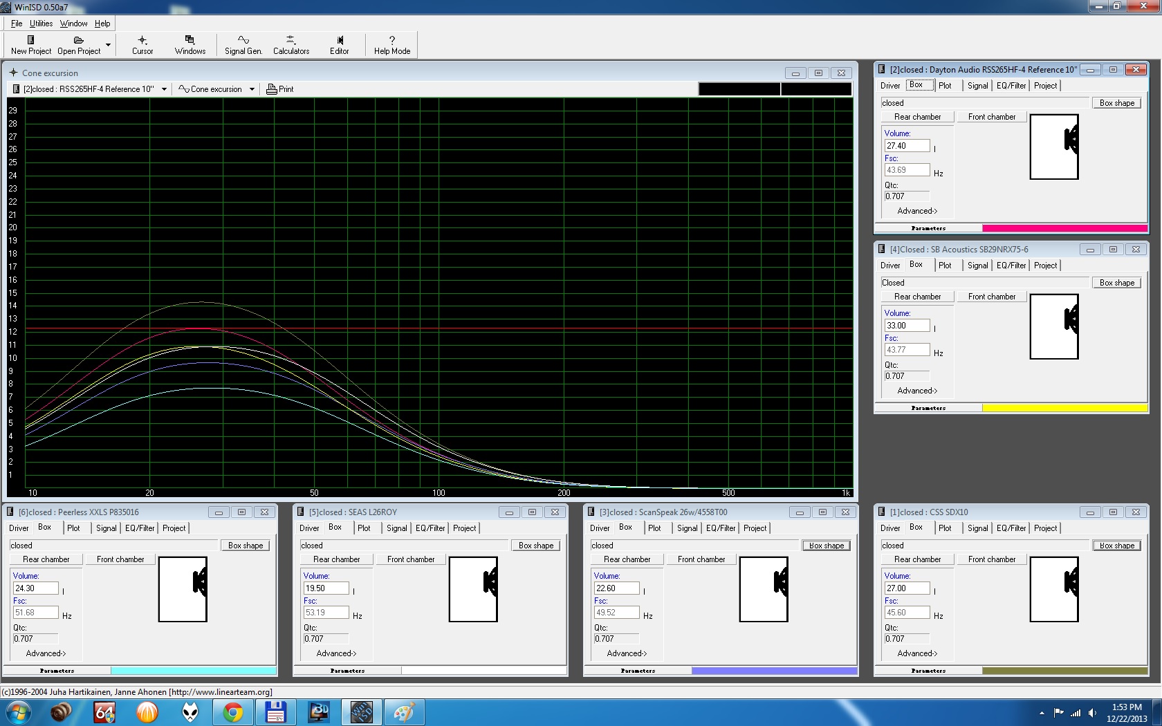

As box dimension what I could maximum afford is 35l net volume.
Now the questions:
1. Which driver should I use?
2. Which plate amplifier should I use?
3. It’s OK to use Qtc=0.707 or I should use other value?
4. It’s OK how I thought about power input (depending on which one is bigger rated or the one which gives Xmax)?
5. What is the difference between SPL and Maximum SPL in WinISD?
6. The used filters and parameters are OK?
Thanks.

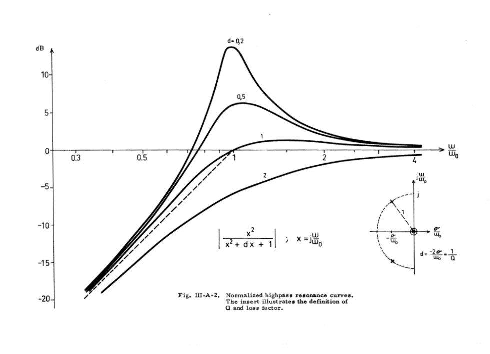

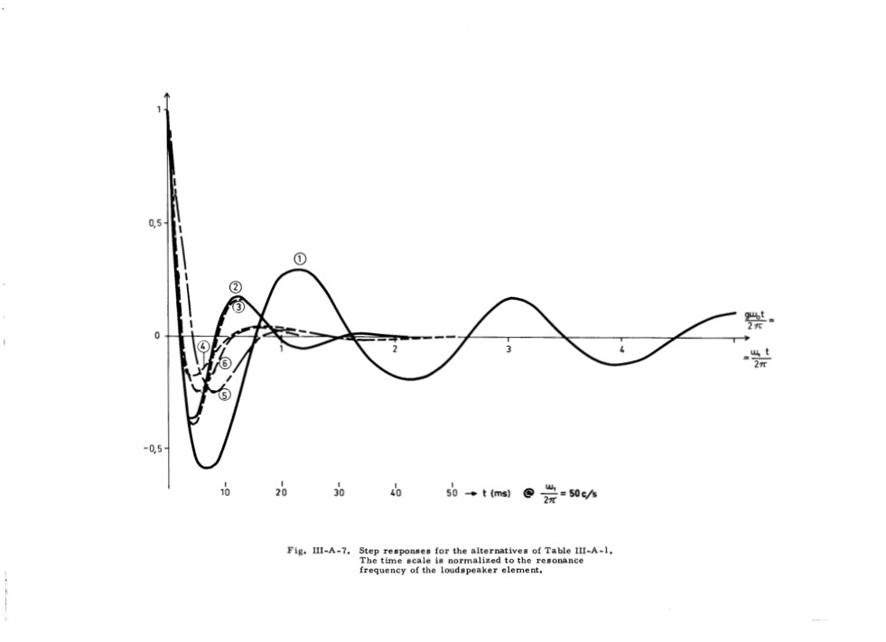

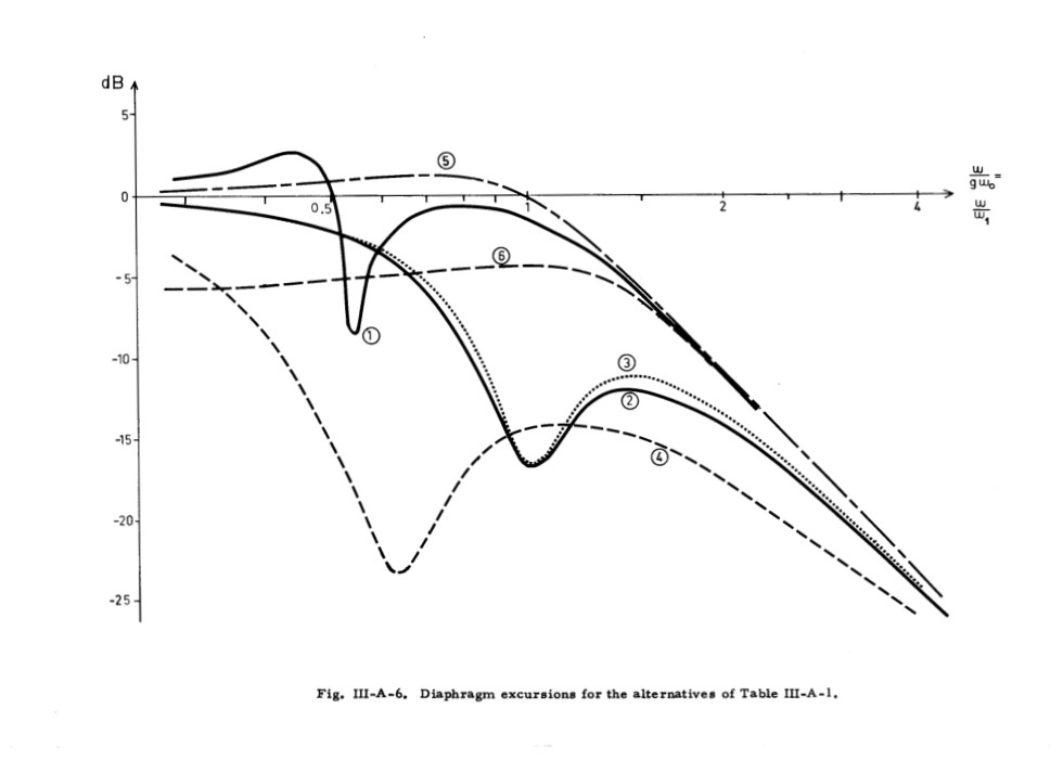

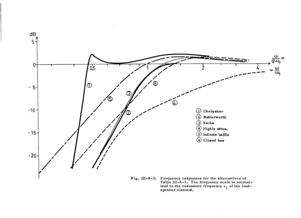

Seems to me that you have all under control. Small details/definition you can look in the tutorials. Power is usually RMS power (standard). Qtc being close to .7 gives you a good Q for the speaker close to optimal, not high not low meaning a good balance between extension, roll-off and output amplitude. Sensitivity is used for 1W or 2.83v output and max. SPL is used for max. output at max. power. The amp you use depends of the woofer you choose usually 4 or 8 ohms and adequate power (RMS).
http://www.diyaudio.com/forums/subwoofers/148729-how-correctly-use-winisd.html
http://www.speech.kth.se/prod/publications/files/qpsr/1966/1966_7_3_007-022.pdf

This vented/Alu cone woofer you mention (SCANSPEAK 26W/8534G00 v2011, Sensitivity (2.83V/1m) 89 dB) is nuts, very good LF extension and very flexible working well from a minimal 55/65L (QTC = 0.8/0.76, F3/41 Hz) enclosure to a 80L sealed (QTC = 0.7, F3/42 Hz), or 120L/127L BR with infrasound response in this case. It only needs an amp for sealed of Pmin 12 W/8 Ohms (@max excursion) .
You are right that this Scan Speak 26W/8534G00 is good (it can go at very low frequencys), but unfortunately I do not have so much space for it... Also the SPL is very low because of the very small power needed for Xmax.
Using the same conditions like for the previous speakers it seems that I need a 66.5l enclouser for a Qtc=0.707 and a much smaller amplifier (18 W for Xmax). The price is also very good (under 100 EURO).
I think I will go with Dayton Audio RSS265HF-4 or CSS SDX10... and I believe it will be Wyntek plate amplifier...

Someone in the industry can give you a better answer, but it's my understanding that using more power for Xmax or parameters like voice coil length, air gap, top plate distance are more forgiving in the case of a pro use like Xlim or extreme limit to that the cone can travel (mechanically) before getting destroyed or being stuck.
Thermal might be related to thickness of the wire and components (glue) melting points, and former materials (paper in the old drivers).
And what you do if the max excursion (@Xmax or approximate 1/2 Xmech) is achieved at 12W (with a well-sized box) and the driver mentions in it's specs 80/150W like the driver from post #3?!
Linear excursion ± 6 mm
Max mech. excursion ± 12 mm

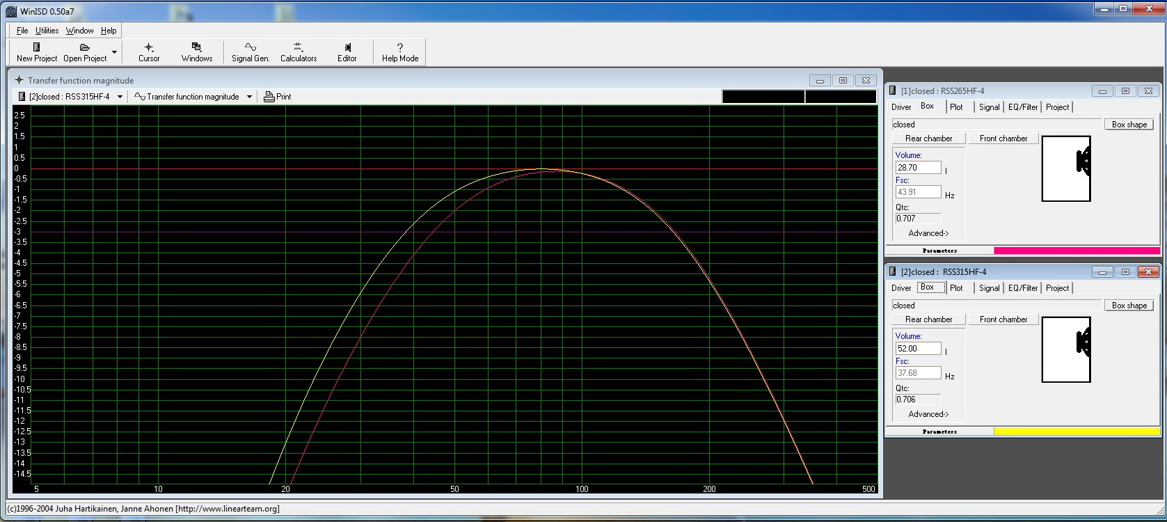

Hi, after a lot of research I finally chose the driver and the amplifier: DAYTON RSS265HF-4 with Wintek WAM300-Dsp.
For a while I also considered DAYTON RSS315HF-4 together with Hypex DS4.0 The graph is looking very good for the 12" driver but I had 2 major problems:
- the volume of the box (52l for 12" versus 28.7l for 10")
- the bigger price (600 including shipping for 12" driver and amp versus 450 euro including shipping for 10" driver and amp). Additional to this I needed a box which cost I estimated at 120 euro (wood + execution + sound absorbing material + different other materials) so in the end it's 570 euro 10" versus 720 euro 12" => 150 euro difference.

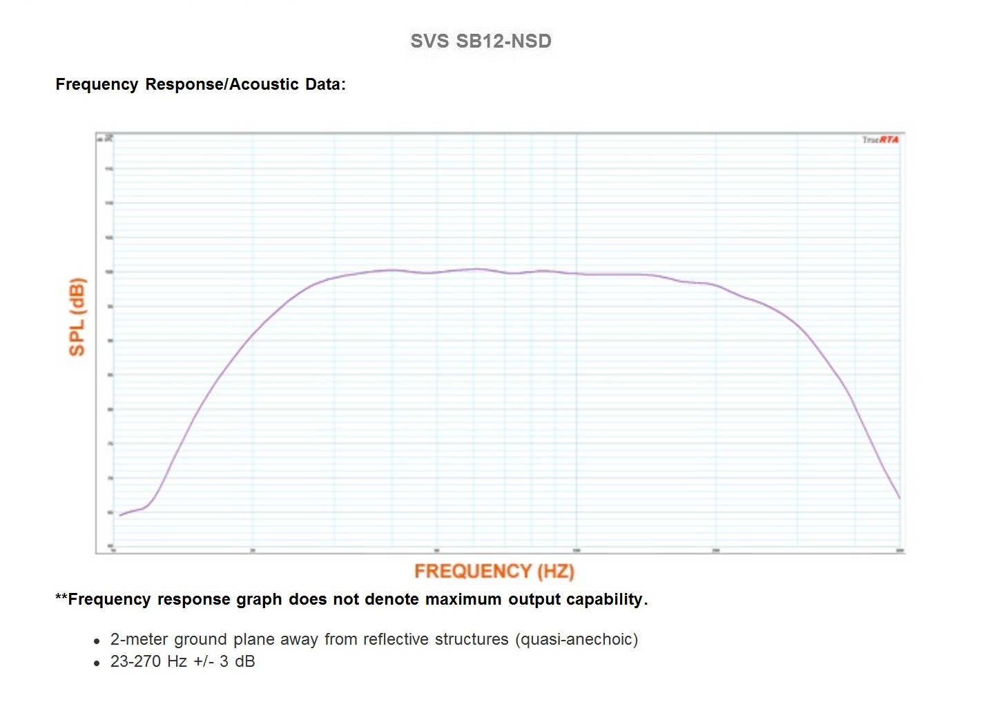

Searching on the market I found a sub-woofer which has a lot of good reviews: SVS SB-12 NSD at 549 euro and free shipping.
Unfortunately I decided to gave up to the DYI project because of lack of time, smaller price and less effort to get it.
Probably the sound quality of the 10" DIY sub-woofer is better than the SVS product but I will never know... 🙁
I will never give up to the DIY sub-woofer but this was not the moment for it.
Good point. (and don't feel sorry, time is money)
The SVS is/are a good product.
SVS 12” NSD driver: 25Hz F3 (approx.), cast aluminum basket, 400 watts RMS, Customized EQ and DSP 🙂
