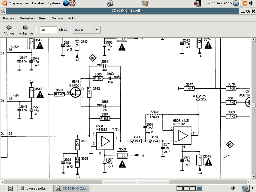

I modified a Philips CDP304mk2 with Kwak clock, OPA2132 opamps and a lot more. Sounds good, but the treble has sometimes a sharp edge. I wondered if it is possible to exchange the standard (butterworth?) filter around opamps to a more phase-lineair Bessel type.
The original Philips schematic shows a 2N cap paralleled with 1k8 in first feedback loop/opamp. Two 2k4 resistors to non-inverting input with inbetween 2.2N and 470uH in 2nd feedback loop of 2nd opamp.

Keep in mind a Bessel filter is not as efficient as a Butterworth. You will need more stages of filtering to accomplish the same task. Bessel will give better phase response... there is much debate as to whether this can be heard though.

Whether you can change to Bessel may depend on how your filter is layed out now. Can you post the schem of your Butterworth?

The schematic, yes ehm, threw away the scanner, so have to find a way to show.
Filtering is standard like most 16bit 1541 players with a dual opamp.
