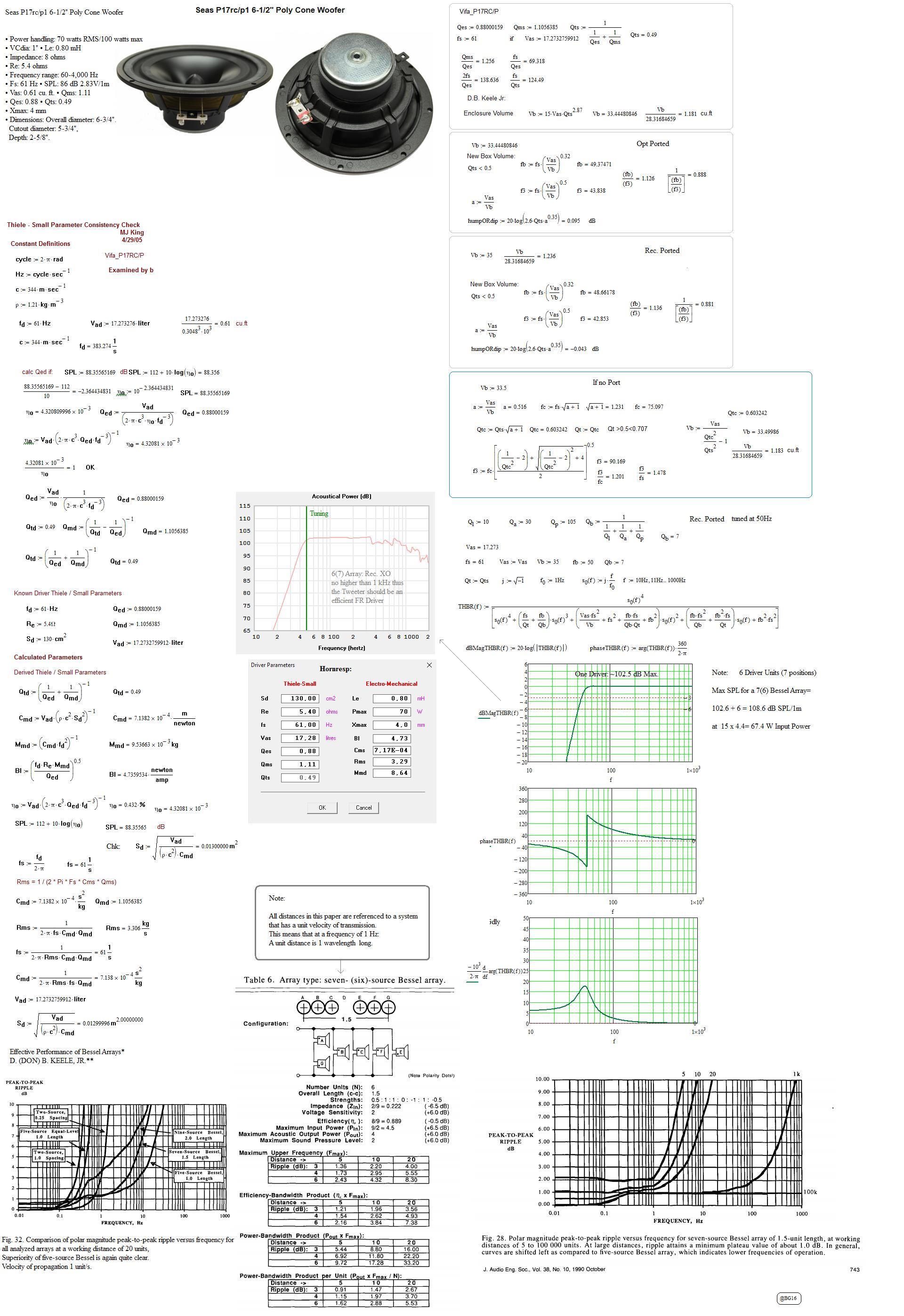

Yes it would work and you can Port the Drivers but you should also consider to add one or two Subs below the Array(s) if SPL below ~100 Hz turns out to be too weak.
See the Picture for Seas P17RC/P Ported Box calc:

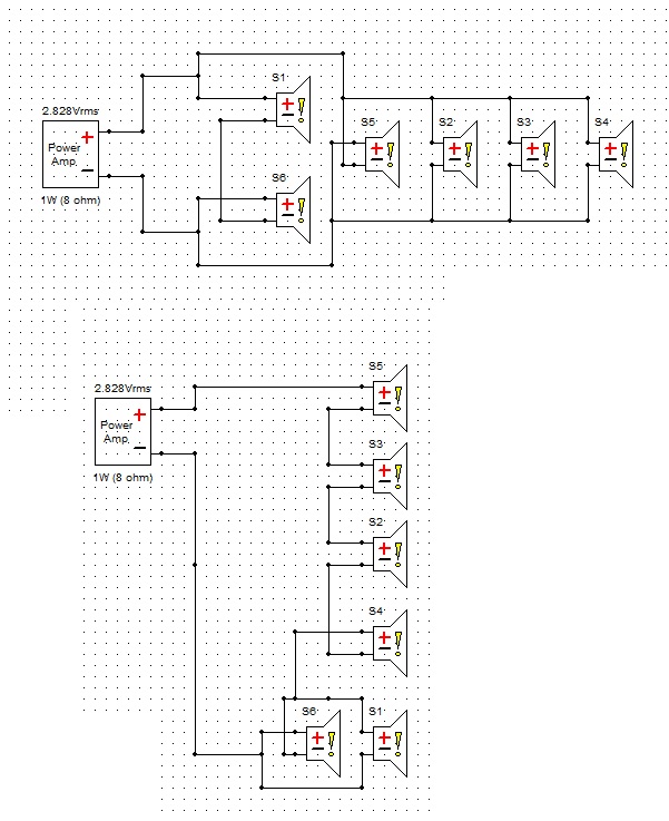

The issue I'm having now is working out how I'm going to wire it for any sort of decent load. With a 7 driver array (6 speakers), I'm looking at 1.8ohms in the 'standard' wiring guise. With 9 (7), this is down to 1.1 ohm - definitely too low. I could series run these for 36 or 44 ohms - not ideal. I noticed the amplifier can run bridged mono at 8 ohms, but I have no idea about what sort of power output I will get (there's next to no information about bridged mono output on my amplifier, Crown XLS402, aside from the fact it can do bridged mono at 4 ohms).
Suggestions?

wiring - (3 in parallel) in series with (3 in parallel) ?
With an Re of 5.7 that would give you 3.8 ohms total
The issue is for the 6 or 7 speaker array, 4 or 6 have to be given equal power and 2 need to receive half power. I've only seen 4 in parallel + 2 in series, or 4 in series + 2 in parallel.
