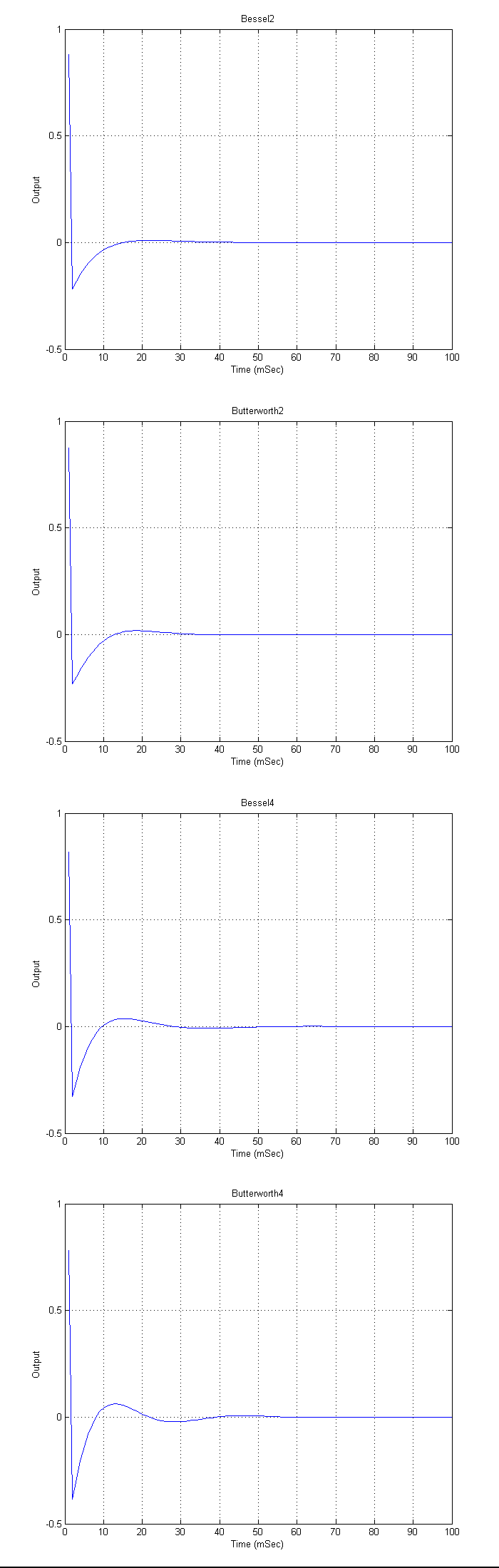

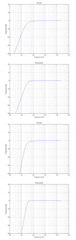

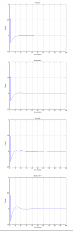

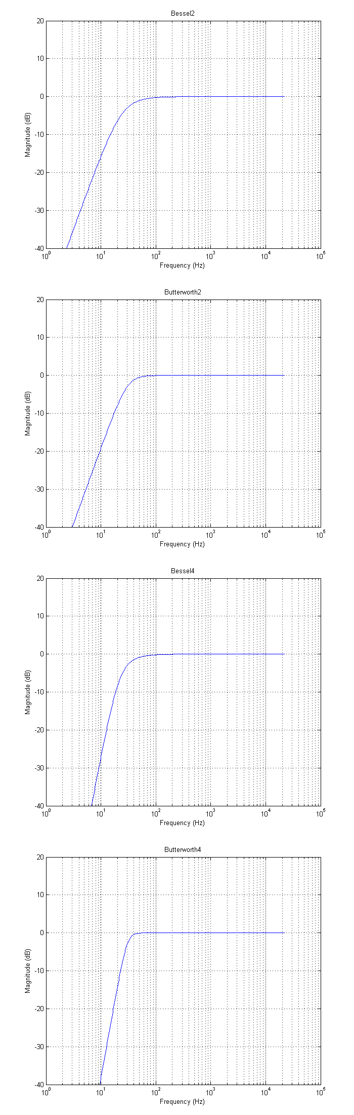

The denominator polynomial of a 2nd-order Bessel filter is
s^2 + 3.00000000000000s + 3.00000000000000 (Q = 0.57735)
The denominator polynomial of a 2nd-order Butterworth filter is
s^2 + 1.414214s + 1.000000 (Q = 0.70711)
The denominator polynomials of a 4th-order Bessel filter are
s^2 + 4.20757879435926s + 11.4878004768712 (Q = 0.80554)
s^2 + 5.79242120564074s + 9.14013089027793 (Q = 0.52193)
The denominator polynomials of a 4th-order Butterworth filter are
s^2 + 0.76536s + 1.00000 (Q = 1.30657)
s^2 + 1.84776s + 1.00000 (Q = 0.54120)
I've attached graphics showing the frequency and impulse responses of all four, with a -3dB cutoff frequency of 30 Hz.
