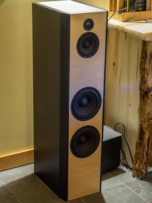

SB26ADC is a top performer, regardless of price. If they ever launch the announced waveguided version, I will definately buy it. DXT motor structure is outdated and it's impossible to get the DXT Beryllium as found in Grimm Audio.
My next build will be MW19, MR13 and a tweeter in a waveguide that matches the DXT's directivity. MR13 and DXT are a perfect combo regarding directivity. I need 4MW19's per side to keep up with the subwoofers. Although I could do with less now I've moved into the tiniest appartment you could imagine.
Will swap the drivers for the new textreme ones, once they come out. The old MW19's will then be used in the surround speakers. I might try coating the MR13's surround inner side partially myself, like in the new Textreme ones alledgedly. So far MR13's biggest flaw is that surround. It is in a more awkward spot than the MW16's.
Regarding Hypex, good choice. So far beats the nested LM3886 amps even in the distortion department. Not so fond of the software interface, but it probably can handle my modified Linkwitsz crossovers unlike the DCX2496's that I'm using right now.
TW29 Be defeats the point if you're asking me, because of the huge surround. It makes it a soft dome/Be hybrid practically. SB26 Be would be welcomed, but BlieSMa has some good options too, especially considering directivity.
In the USA Selah Audio has an attractive design called Essenza which uses two Satori WM19P-8 woofers in a 2cuft ported cabinet for -F3~43Hz -- before room gain effects.
That looks nice indeed. Cabinet size looks the same as envisioned, even the styling is close, color-wise. There are however a lot of critical notes that come to mind. Luckily we're not limited to buying pre-made speakers. Thanks for sharing!
