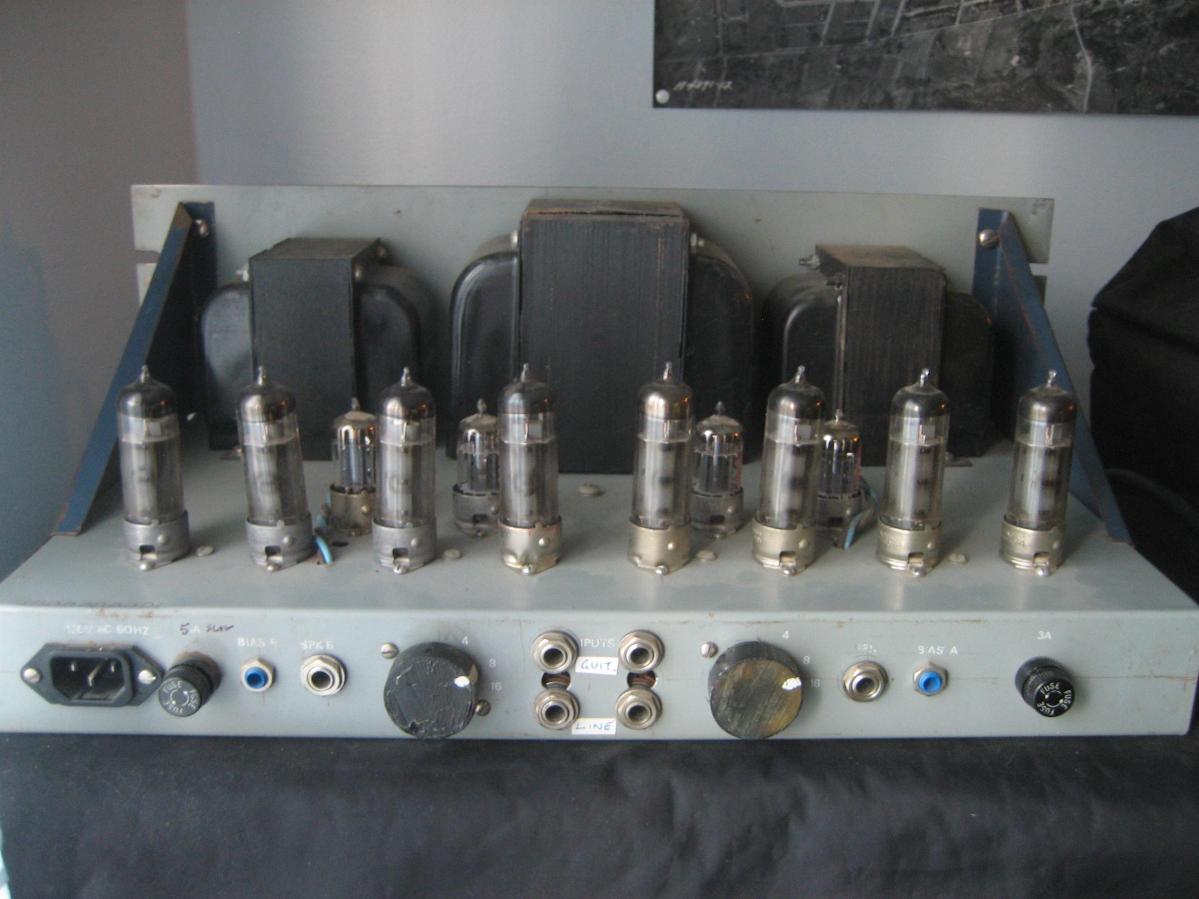

Hey Guys, been a while since I've posted. I've had a Bernie amp sitting collecting dust for a 'no rush' job and I want to finally get it moving. The problem is there is no schematic for this amp and the wiring is completely confusing - neatly done, yes, but all the wiring is the same white colour and tracing any lines have been really infuriating.
Basically, this is a dual amp chassis built in the 80's - one PT, two OT's, two standby switches. Each side has 2x 12AX7 and 4x EL84. I think the basis is a Vox or Hiwatt design, but none of the schematics i've dug up have come close.
There is no output right now. Power On, standbys On, I measure about 500VDC on the output of the ss rectifier, BUT it doesn't jump up right away, it climbs up over about 30 seconds after switching on AC. Then, when I switch off either of the standbys the voltage falls to about 100+VDC. The EL84 plates read about 100+VDC volts too.
I've never had this problem with another amp so I'm stumped. Any ideas what to check out next?

I've pulled the output tubes and the voltage test is the same. Slow climb to 500V, then pulling either of the standbys brings it down to about 180V, or both together, down to 115V.
I removed the 12Ax7s as well and the voltage falls to 260V with both one or two standbys flipped off.
The whole amp is drawing 450mAac without output tubes, 420mA without any tubes. With all tubes installed the current settles at 600mA regardless of standbys.
I'm thinking this must be a PS issue because how can both sides of the amp be exhibiting the exact same problem...this should be an easy amp to diagnose because there are two of everything and if both sides are exhibiting the same issue, the power supply is the only thing left?
OK, so the tubes do not substantially spike the current. From 450ma to 600ma equals about 18 watts more from the mains, which is probably mostly heaters.
Your high voltage crashes, so start at the start. What does the HV AC do before the rectifier? Does it stay up or crash as well? Is your rectifier a four diode bridge or a center tapped winding and two diodes? In any case is there an open CT connection or a bad ground at the bridge? When no current is demanded, a high series resistance won't drop much voltage, so the B+ can climb, but as soon as you load it it crashes.
Pre-rectifier AC does not crash. Standbys ON I have 370vac on each tap, switching off standbys bumps it up to around 380vac.
There are 2 diodes used for a full wave rectifier...meaning there should be a CT ground...

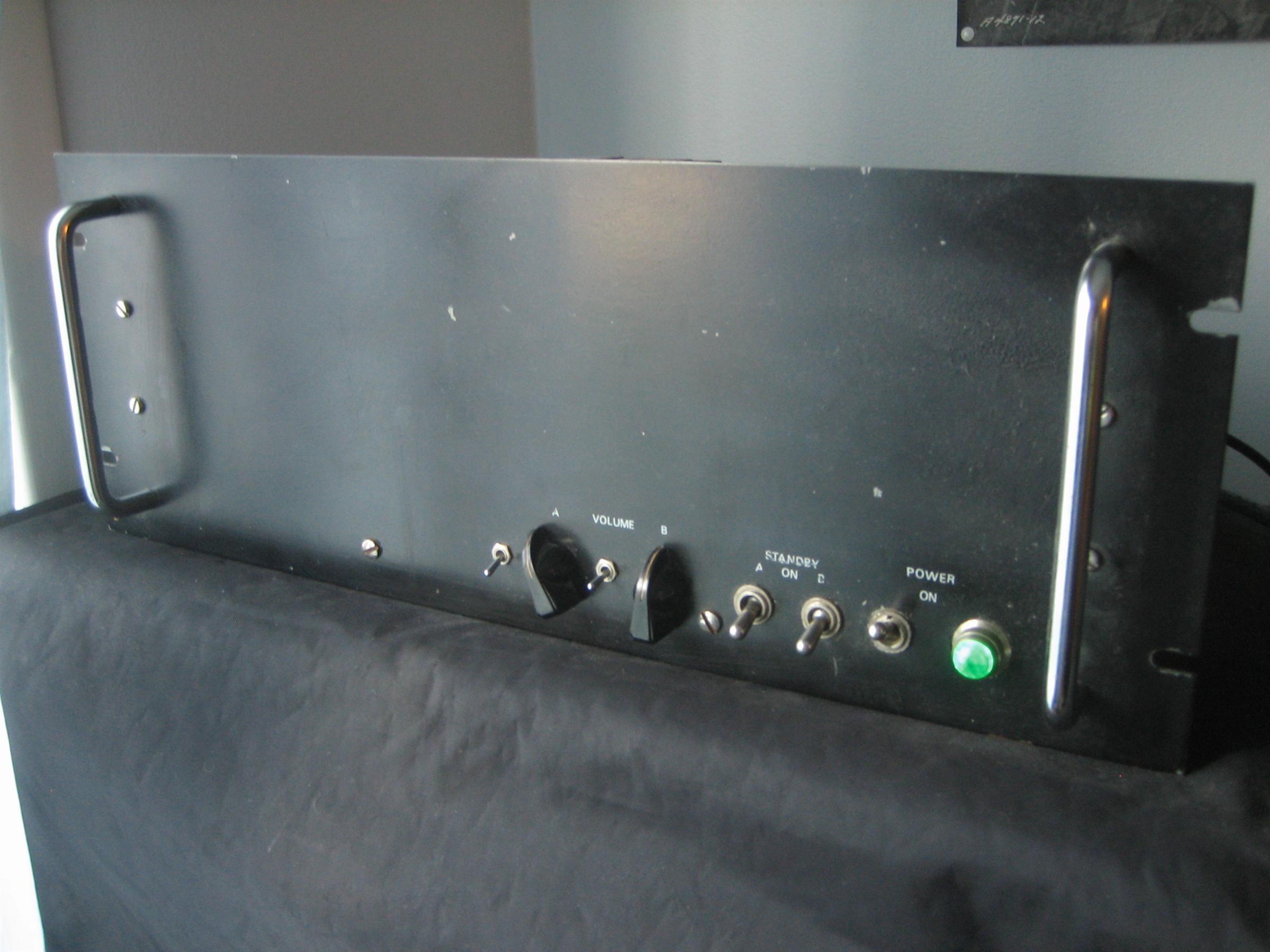

Here are some thank you pictures of this probably one-of-a-kind amp.
Thank you very much as always, you're depth of knowledge for this stuff is humbling.
