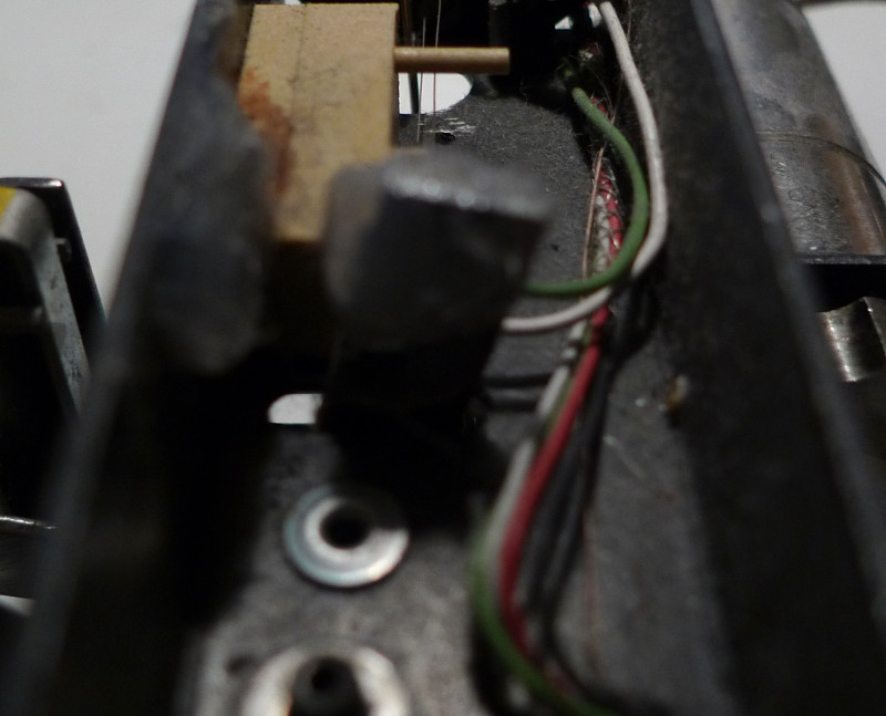

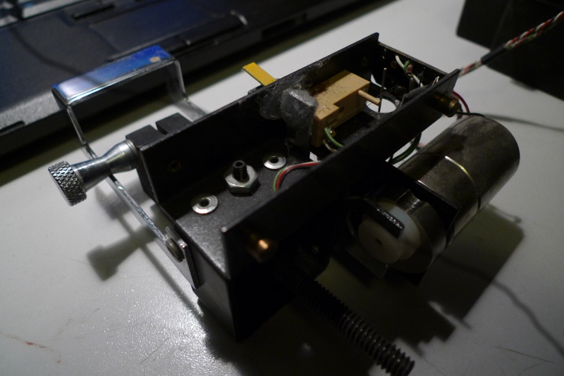

My original SL8E mod has undergone 2 significant improvements in the intervening years. First, it now has a 2 stage cueing linkage that limits the cueing height to about 1/4 inch. Second, and most beneficial, an optoelectronic circuit that drives the carriage motor continuously in a variable speed mode, eliminating the troublesome OEM cat whisker contact on/off control. I have enjoyed using my modified arm for all these years as I read post after post of user frustrations with anti-skate settings, Lofgren/Baerwald/Beethoven alignment wars, sticky bearings, noisy air pumps, and causes of end-of-record IGD.

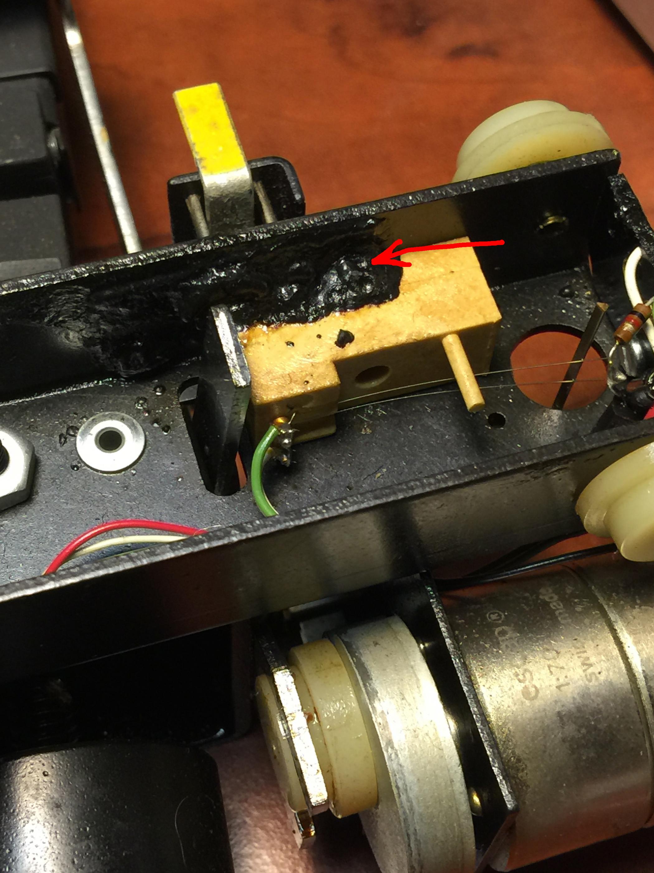

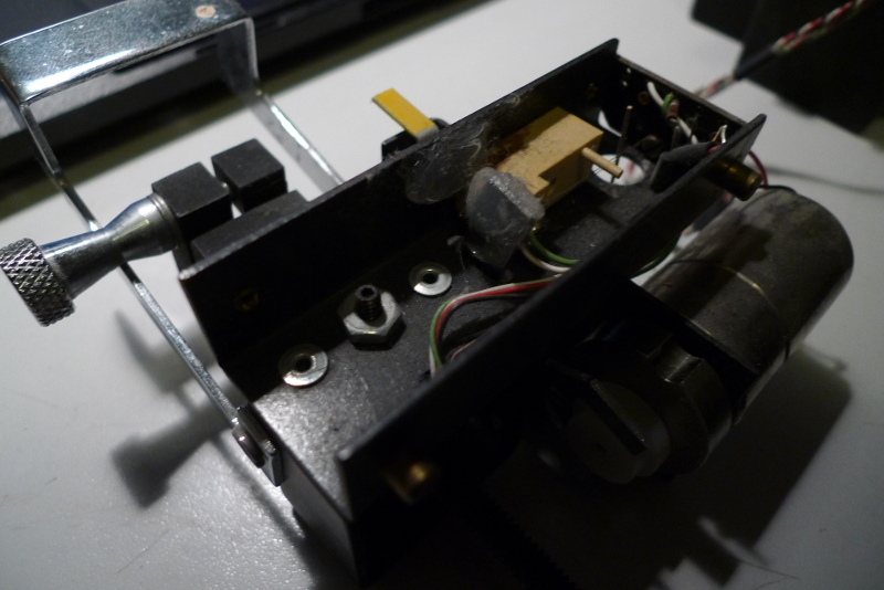

IMO, David's most important changes were:
- tonearm wand solid and made from two different woods
- new gymbal with close to zero bearing friction/torque
- put damping putty on any flat metal surface to prevent ringing
- get the cat whisker contacts reliable

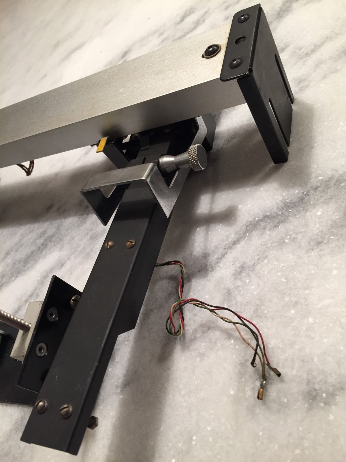

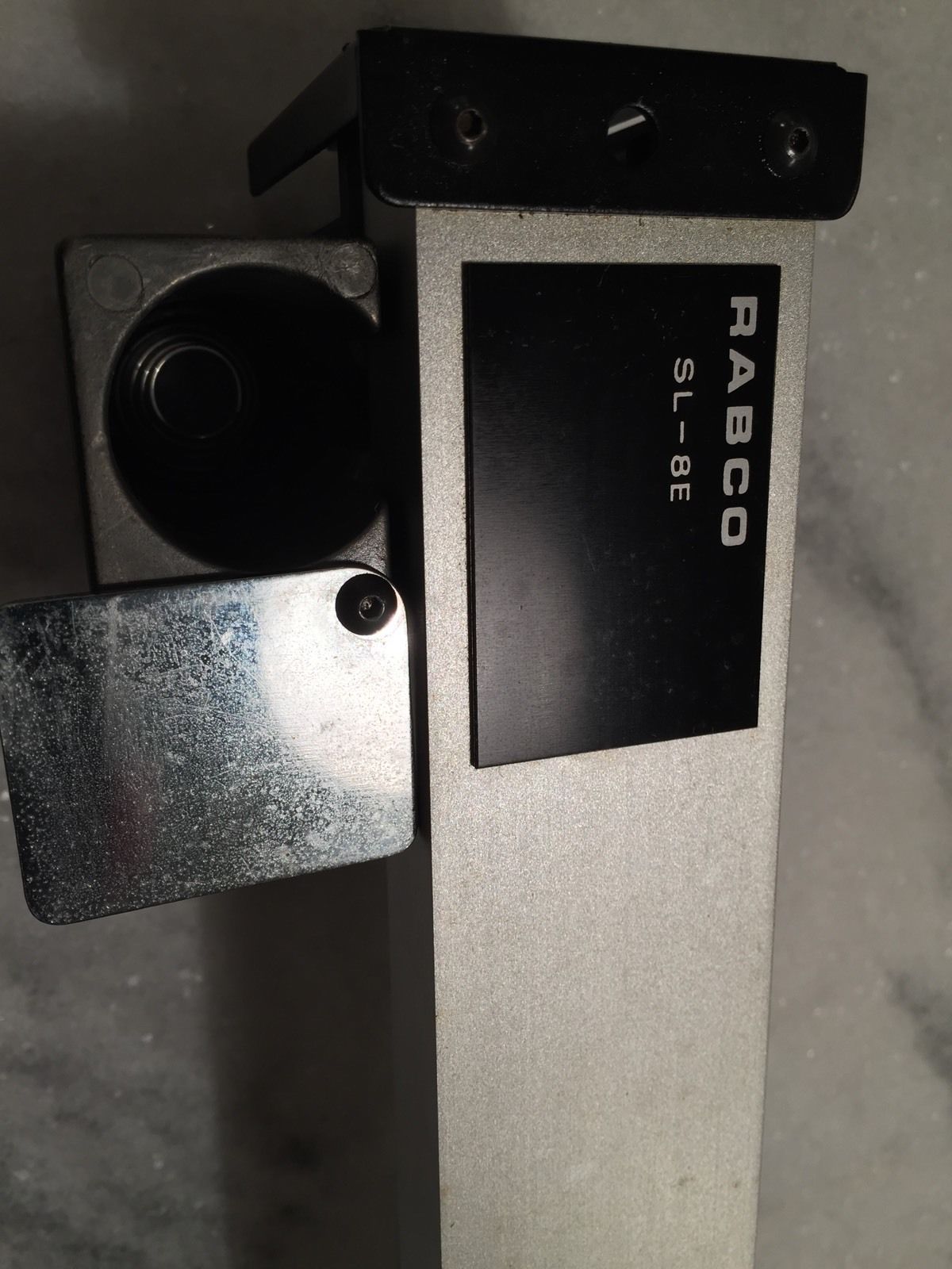

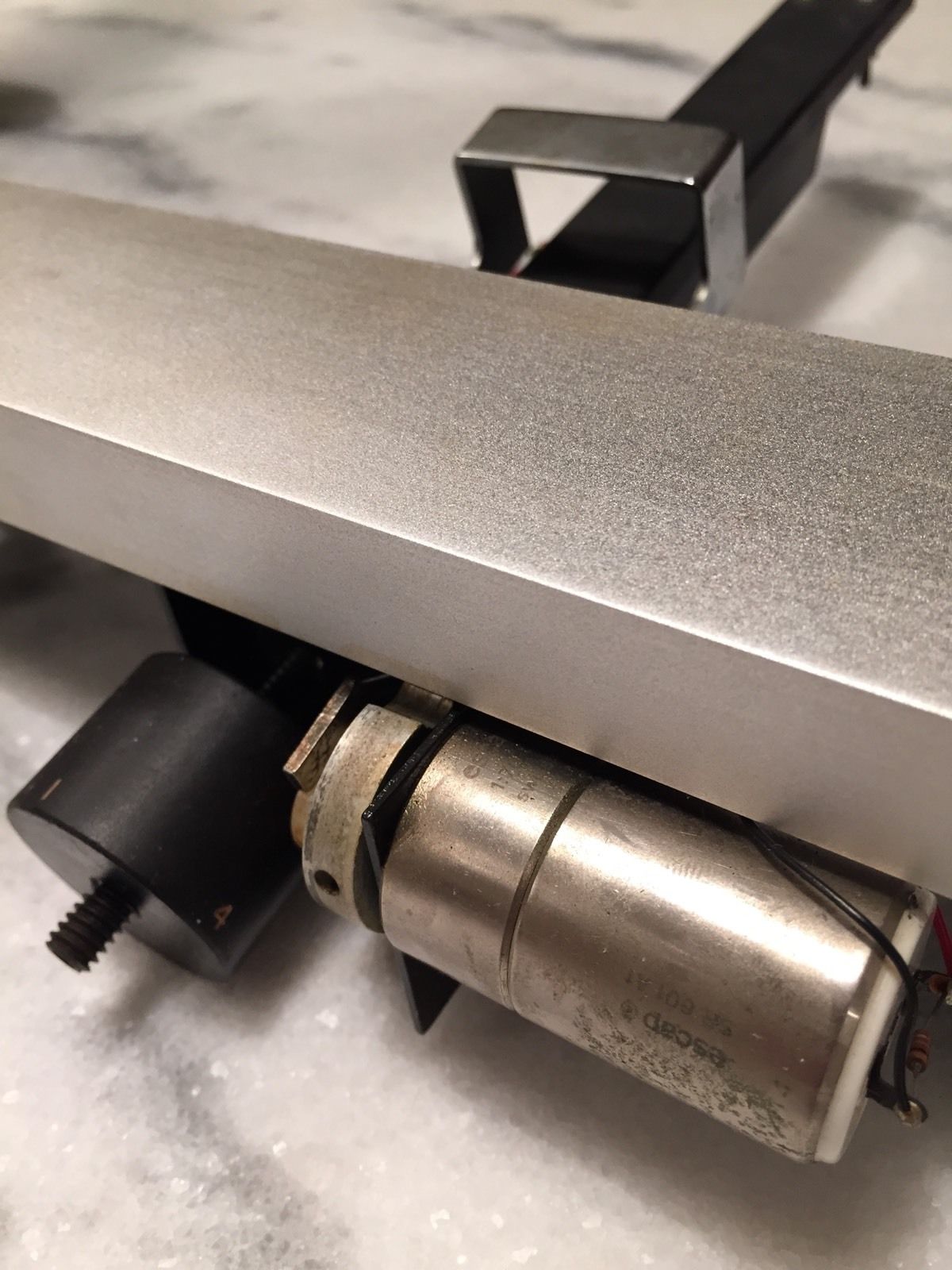

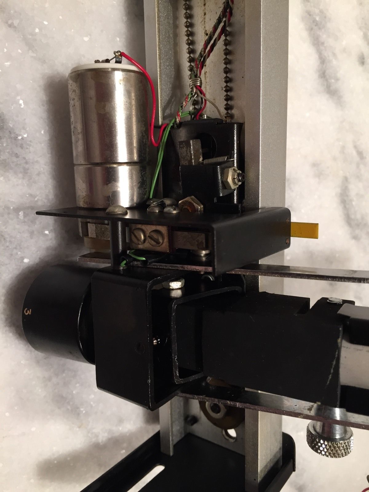

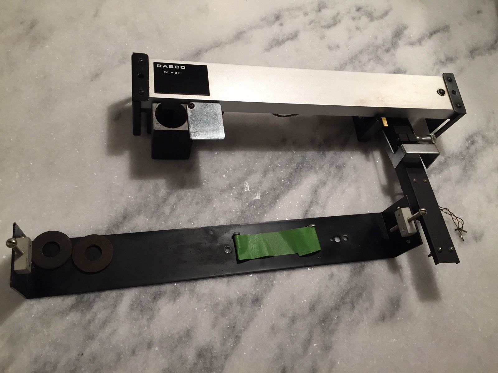

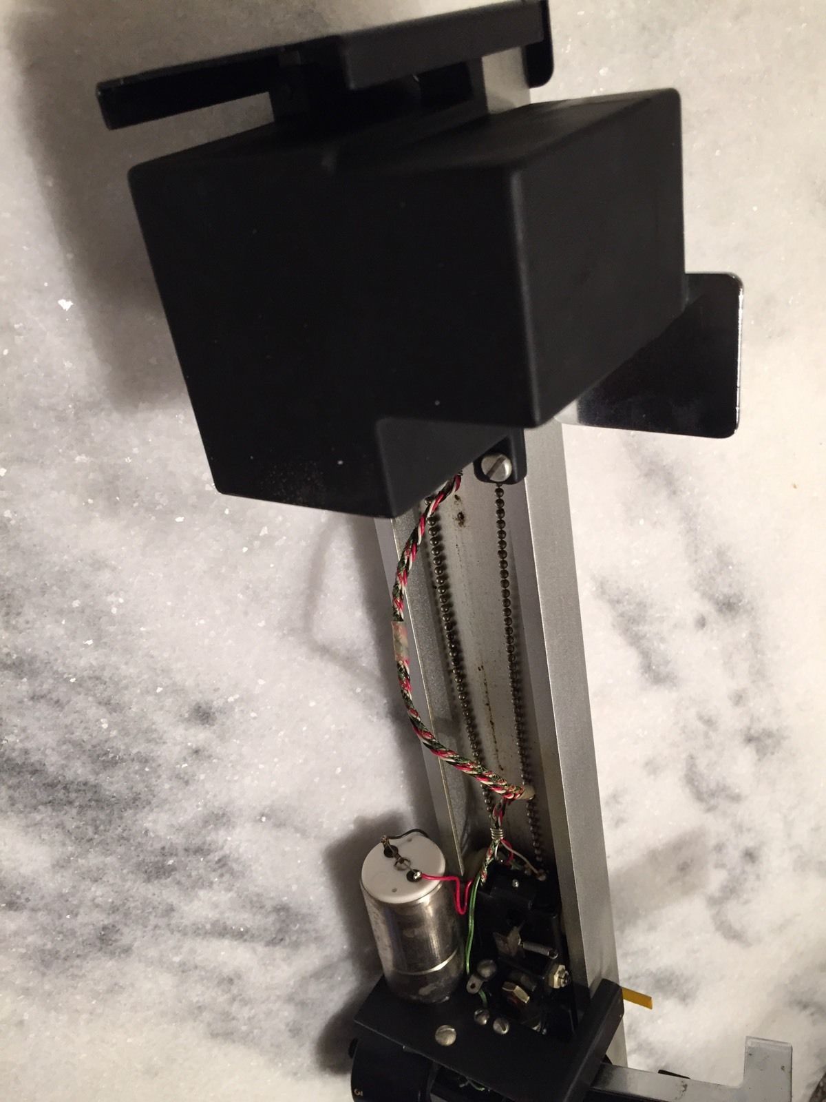

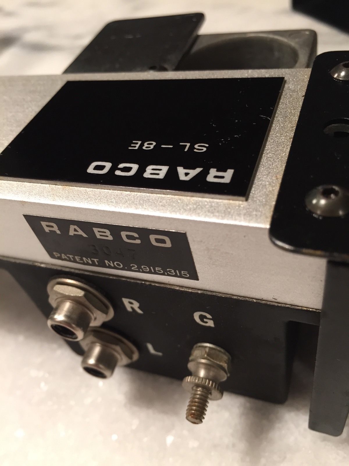

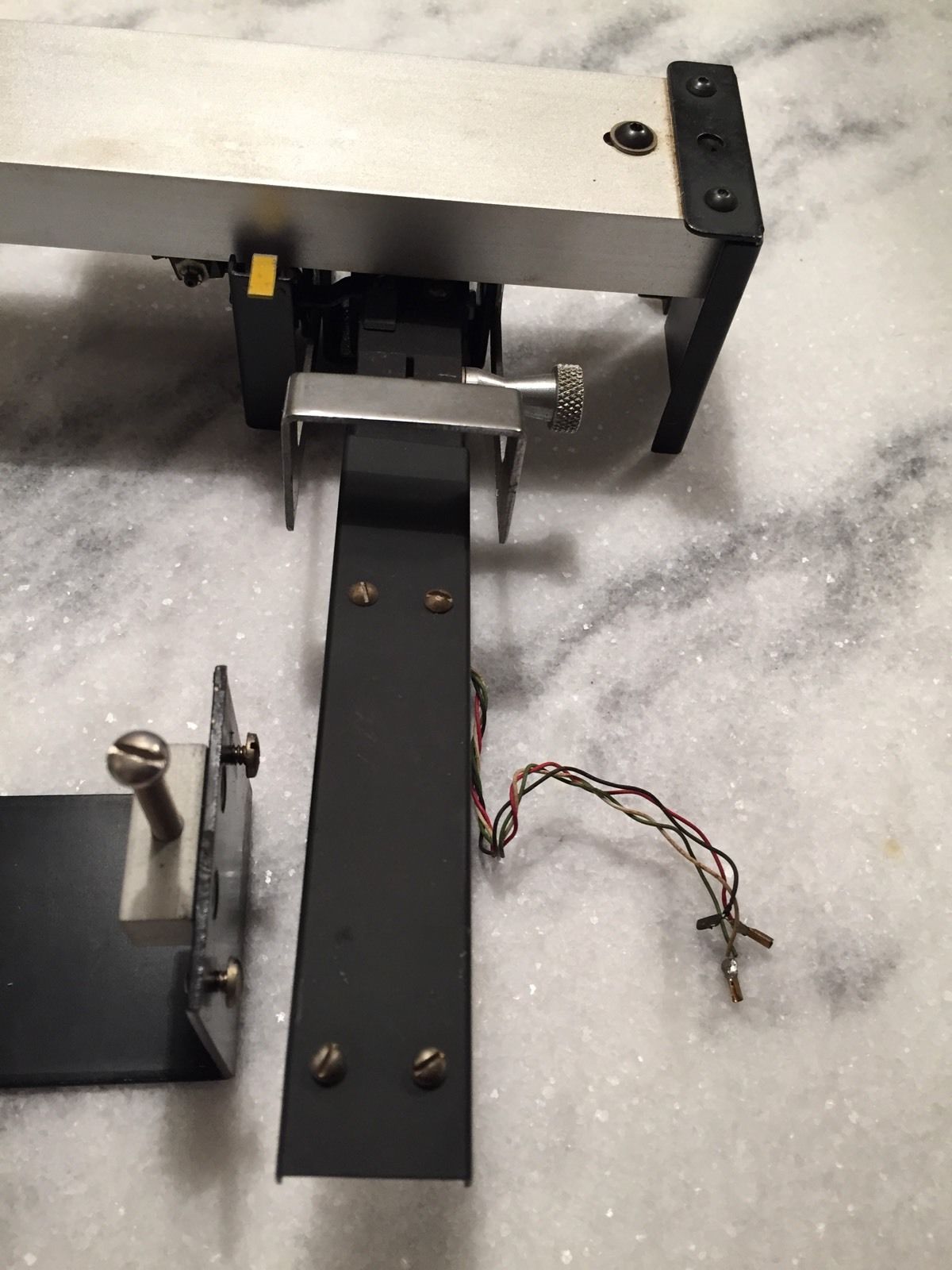

Bernhard, thanks for your reply and suggestions!
I am still waiting the arm now. Once I get it, I will try to test it first and get basic idea how it works. In the meantime, I am working on my 2nd air bearing arm now.
Here are some photos from the seller. It looks in decent condition.

Hello Calvin and all,
1.) Goldmund was intended as a highend product. Was meant to be the best tonearm in the world. Noone takes a worldclass product serios if it does not cost enough. And Goldmund wanted to exploit that.
2.) For any manufacturer of small-batch audio gear, the ratio of end customer selling price to manufacturing cost has to be higher than 4, otherwise he is not earning money. And this is not taking into account that many customers expect large discounts.
3.) The Rabco was never expensive, in its days. Someone else posted that the original street price was US$ 169.- back then, that would be around 1000 $ today.
Look at the build quality on the pixes: it is built as cheap as possible (possibly cheaper). It just works very well (... if it works at all).
And, please, don't confuse the standard Rabco with David Shreve's rebuild. Sonically, it is a different class. I had the opportunity to compare both. With the standard Rabco, the sonic footprint of a well-working servo-driven linear tracker is clearly audible yet due to the cheapocheapo sheet metal construction, it is tonally not the most pleasing thing, you could say, it rings like a group of bells.
David's re-build sounds completely harmonic, musical, dynamic, effortless, undistorted, breathing treble. However, it looks almost as crappy as the standard Rabco, who would agree to spend serious money on that ?!
Not every engineering effort pays, sonically at least. I would not have my delicate unshielded tonearm wiring exposed to a linear motor's magnetic stray fields.
It should be considered that the mentioned designs were meant for large production numbers. under such circumstances, higher engineering effort is economically justifiable.
BTW, Goldmund used an optical sensor and a closed loop position control with PID regulator.
For my current linear tracker design, i also use an optical sensor, with very high resolution, i might add. Just, my sensor is very hidden too, it does not use separate sensor arms like the Goldmund and some of the designs you mentioned (every freely protruding arm/beam is the half of a tuning fork, after all ... and resonates at its own base frequency with just the same enthusiasm).
For driving the carriage i use a miniature timing belt driven by a stepper motor (with some torque-shock-absorber coupling in between).

I received the Rabco arm and did some tests.
Both motors are running fine. But it is on and off randomly. I think it is caused by bad contacts of switches. And the carriage doesn’t move even if the motor was running and the bead chain was moving.
I checked sound fountain web site and service manual. Both state that the carriage is clamped to the bead chain via a rubber pad. Obviously, my arm is missing the rubber pad. But I am not sure how the rubber pad is clamped on the carriage. What kind of rubber pad is it? What is the dimensions of the rubber pad? Does the rubber pad push up against the bridge to move the carriage?
It seems to me that the previous owner tried to glue the rubber pad. Please see attached image.

Hello super10018,
make sure the cat whisker contacts are free of corrosion and/or contamination (gunk, grease, dirt etc.) and maybe you want to have them gold-plated (there are gold plating pens with a small battery inside available)
Clamp:
On your pix, the elastic caulking on the clamping jaw seems to be missing.
See attached pixes of an original Rabco carriage; 1st two pixes are with jaw closed, 2nd two are with jaw open, the jaw being a part of the lift brindge protruding thru a hole of the carriage.
Both the U-shaped carriage and the clamp are thickly coated with some rubbery/silicone caulking putty (opaquely transparent in my case) where the bead chain is meant to be clamped between two rubbery surfaces. Usual bathroom caulking should do. Hope this helps.
[...] but it may not do good job to move the carriage.
hello super10018,
that is exactly what it does: move the carriage.
