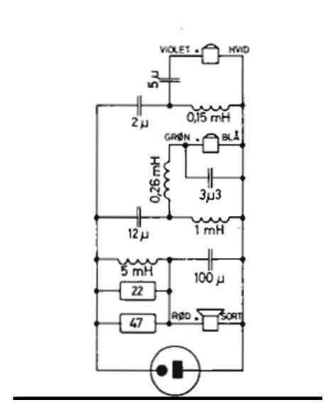

I have a set of beovox 5700 speakers and I believe the capacitors may need changing/ upgrading.. does anyone know the exact ones to purchase they are the beovox 5700 6254 version. I am looking to put speaker ports in the back aswell and replace the old cable hanging out of the back of the speaker. Thanks In advance if anyone can steer me in the right direction.

Have you looked at the crossover boards yet? B&O tended to use bipolar electrolytic capacitors with their values clearly marked on them.
If in doubt, attach some photos of the board.
Look to see how your crossover board compares to this one:
