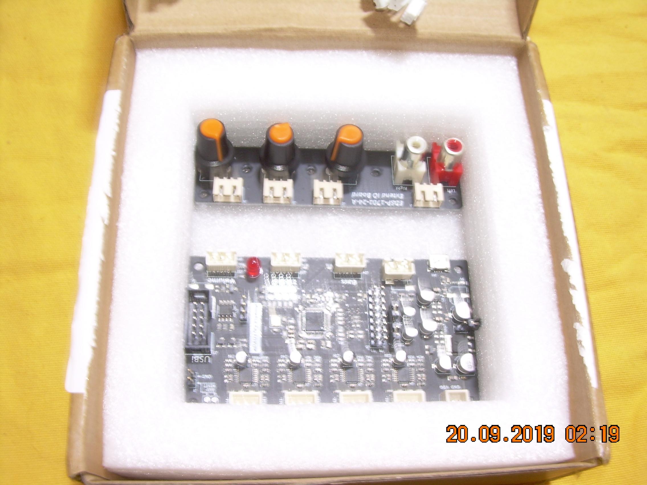

I have a comparable project with an old Yamaha CA-V1 integrated amp.
https://www.hifiengine.com/images/model/yamaha_ca-v1.jpg
The amplifier will be a unity with new build 2-way speakers. In the end I will only use the passive input selector and the power switch from the old amp. It will drive each chassis with a single amp, so 4 channels. No electronics inside the "active" loudspeakers at all.

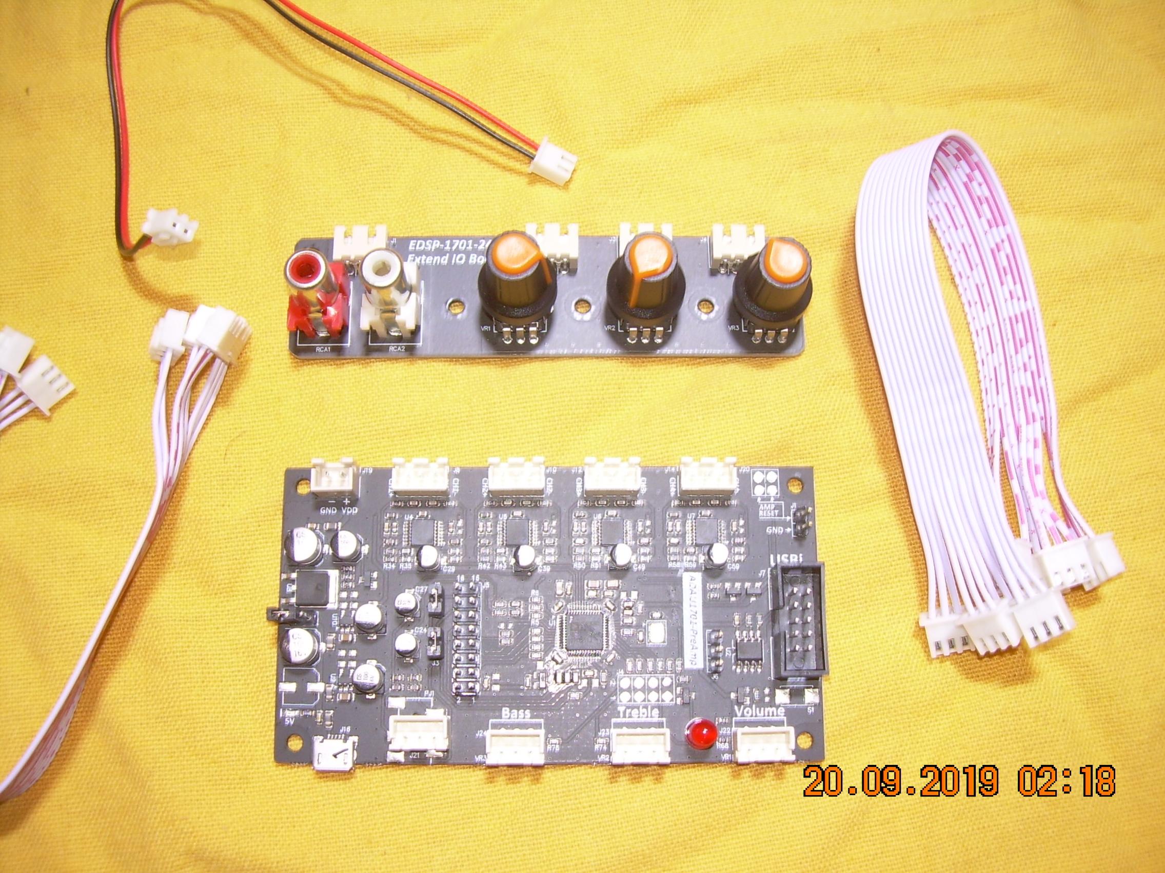

For x-over I found the DSP from 3e-audio in the version with 3 separate pots for bass tremble and volume. Maybe have a look, this could fit for you too.

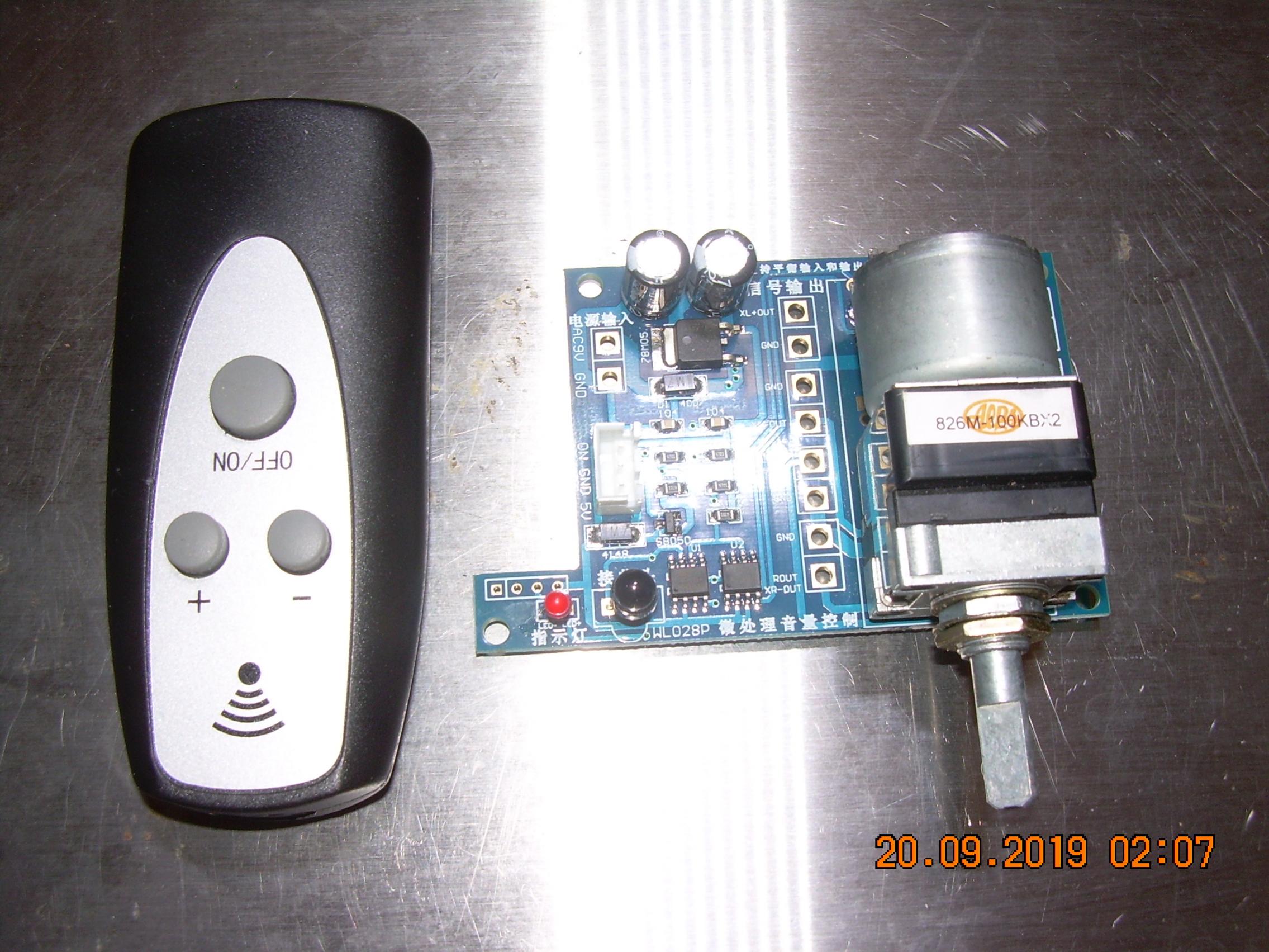

I´m going to combine it with a motorized pot, which will give me on/off and volume control over a remote. I don´t need more (old man).
I will see how to match these parts...
Maybe use the DSP as a volume /tremble /bass control if this is an option for you. You can program at which frequency it will work, a huge advantage over a fixed version and even fix room related problems. No need to use all 4 outputs.
It has symmetrical outputs and you can easily convert any cheap D-amp for such an input. Just look for the two input capacitors each channel has, lift one leg of each and you are there, symmetrical in. I will use two TDA7498e modules, one per side, which sound very good, even unmodified, with two out of the box SMPS.
ADAU1701-2In4Out | 3e Audio
The quality of the DSP is very good and 4 times the value of the Sure DSP at least. 38US$ inc. P&P fast delivery, took about a week China-Germany.
The programming is not that comfortable as expensive DSP´s, but since the ADAU 1701 is used so much, there is help to be found anywhere. Need a 4$ programmer to make it complete.

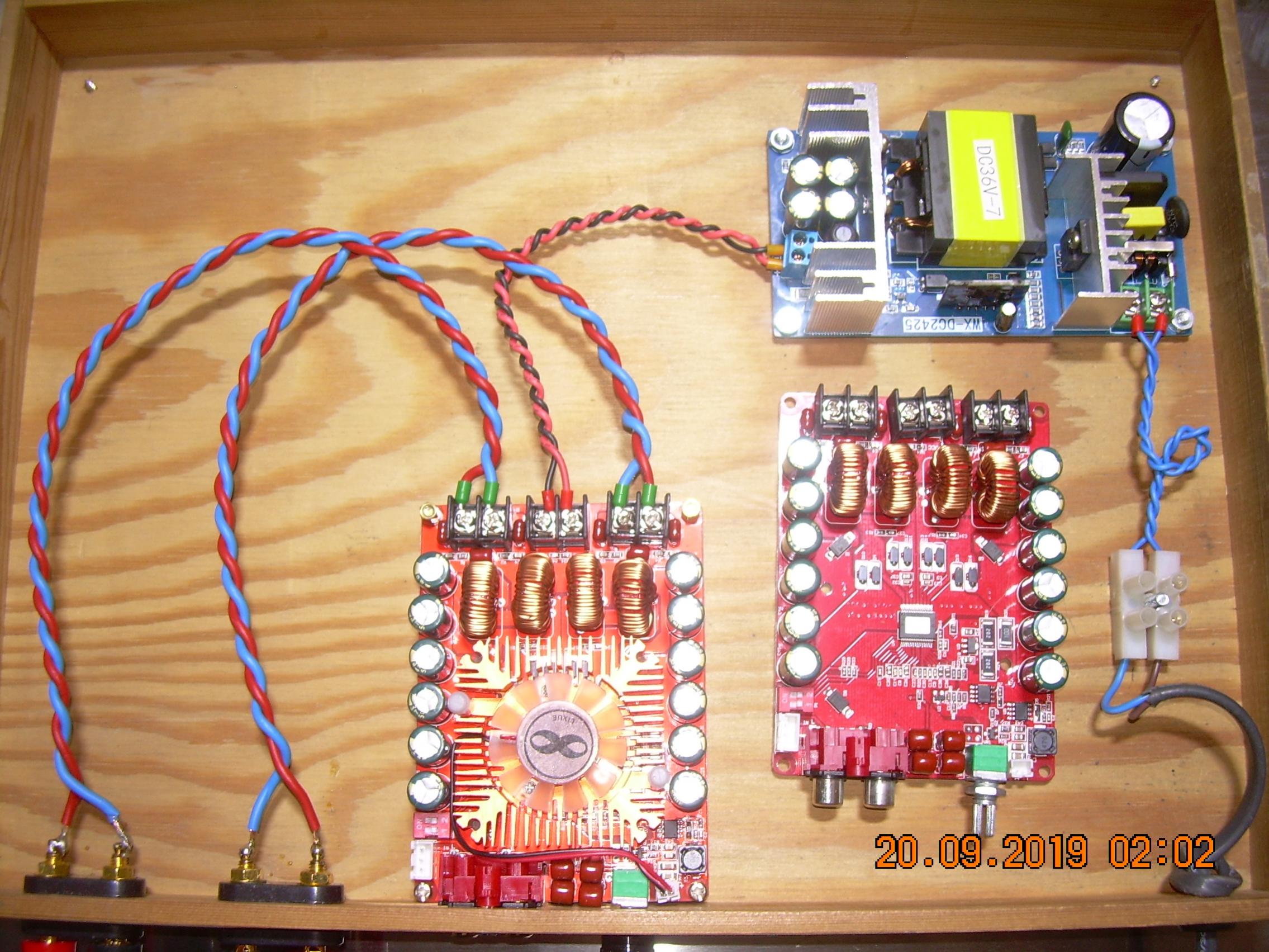

The amp:
Usually the cheap D-amp modules we use are finished with asymmetric inputs.
The chips hardly all have symmetrical input in native form.
On most modules you can access the "pure" input by tapping into the input caps, directly before the Chip, ignoring the other parts on the board. This will be an advantage in most cases, I think.
If you take, as an example, this board with the TDA7498e, you see 4 red caps in a row betwwen the RCA and volume pot. One side goes to the input circuit and the other one to the legs of the D-chip. You need the caps connected to the chip only. Just removing the caps and re-positioning them, gives you the input you need for the symmetric output of the 3e-audio DSP.
An advantage is the broken ground connection, preventing hum.
If you are still unsure which amp to use, the pictured board is really nice. Two points: 1. the fan did never start while using it, even at 34°C in summer.
2. be sure to get the "e" version, the quite similar looking 7498 is not made for the lower, usual 4 ohm loads, so it will not drive any speaker.
It sounds quite as nice as the TDA3116, but while, with larger speakers, the smaller one lacks some authority with bass, while the 7498e deliveres. Something like 10US$ more might not make a difference for most here.

The amp in the above configuration is 100% dead silent. It is only a test build up. Use a cordless drill to do the wires like that. It is really important, as it keeps a lot of noise in the wire and away from the amp. Dont´s use left overs from the garbage can. For final installation I use simple house installation, solid copper wires, stripped of the outer insulation and drilled. It will stay the way you put it and has quite some serious diameter. Signal connections may be screened 2-pole wire with the screen only connected at one side (the sending device) or drilled, wire of smaller diameter, as well.
DSP
As you can see it is fresh from the box. I have to figure out if you can program any pot to act as signal source for the DSP. I hope so, as it is programmable 🙂
If not I have to do some serious modding to the remote.

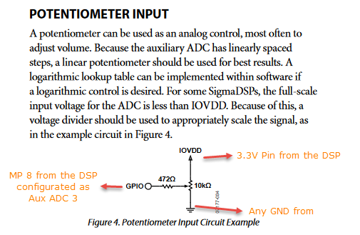

Found this at Sure Adau 1701 external Potentiometer - Q&A - SigmaDSP Processors and SigmaStudio Development Tool - EngineerZone
You might get an idea how this DSP stuff works. As I wrote, you do not need to use it more than once...

Your question is a bit tricky. In theory you can do as you wrote, but this would degrade the sound quality.
See, if you play a CD, at the output you get full resolution audio and can control it analog. No problem. But here things are different: You take analog and convert it to digital, which is done best with full signal strength, just a little before clipping. If you lower volume, you take less steps on the digital ladder. So your analog stages should always run at full distortion free level, like 2 volt rms, to stay near to the 100dB dynamic of the analog to digital converter.
What you can do best:
Remove the volume pot from the new board and connect your pot (slider). This slider will in most cases be logarithmic, not linear.
I would, maybe, parallel both sliders or use the one in best condition. Now they control an AD converter, not the signal!
Then, you have to change the pot-block in the Sigma Studio software, so it accepts a table for the sliders values. Should have been done before by someone, maybe we find an example somewhere.
No problem to measure the slider.
As far as I have seen, you can cut the PCB with the pots in parts, which makes installation more convenient.
This digital level volume control has the huge advantage you do not loose resolution of the ADC which take your 2 volt signal to process it in digital form.

If you become more comfortable with the DSP software, you could use some of the switches the B&O has for their original functions, but in the digital domain, if they are not too complicated, as the CPU and memory of the DSP have limits.

PS the 3e-audio amp that goes with the DSP for most is the best high end D-amp chip at time.

Thanks Turbowatch. The preamp module in the B&O was noisy and had distortion problems.. probably the transistors... But the radio section is good and I have worked out how to power it, so I am keeping that in (there was a full schematic in an envelope taped inside the case). The little bear makes no noise, even inside the B&O so I will keep it in there, inside its metal case. I was thinking of adapting some of the switches and the DSP will give a lot of options.. so all the switches will work.
I'm not sure I understand your answer to the pot question.. The power amp pot wil be replaced by my volume slider? But I don't understand what to do with the DSP volume pot.
