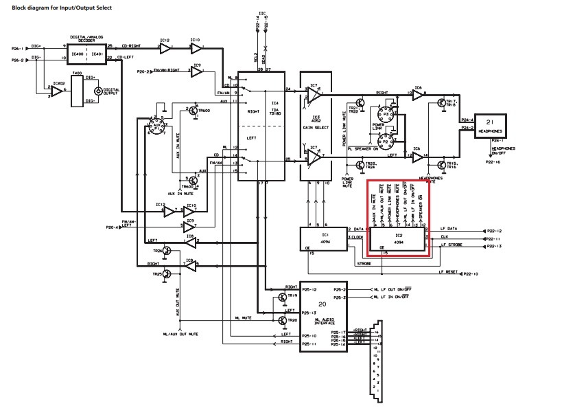

I have some experience repairing CD player and amplifiers, also Beo Sound 9000 service manual available out there. Based on my troubleshooting, the problem may be in PCB32 Input/output select & Digital/analog decoder board. I have enclosed manual and schematic for your ready reference. All electronics components are SMDs.
I was suspect PCB32 mute circuit problem there are Aux mute/ Power link Mute (delaying sound issue) /headphone mute (delaying sounds issues) /Master Link Mute.
I had checked power link mute transistors 2SC4213 as per schematic location PCB32 RH channel TR21/22 - LH channel TR23/24 find good no abnormalities. Also check headphone mute transistors 2SC4213 location TR15/16/17/18 found good no abnormalities. Measured resister value around transistors found within values.
Digital/Analog Decoder circuit location IC1 & 2 HEF4094BT pin 6 (Power link Mute) connected TR601 - PUMT1 & R608/R609/610 all found normal. Now I have suspect only IC2 - HEF4094BT?

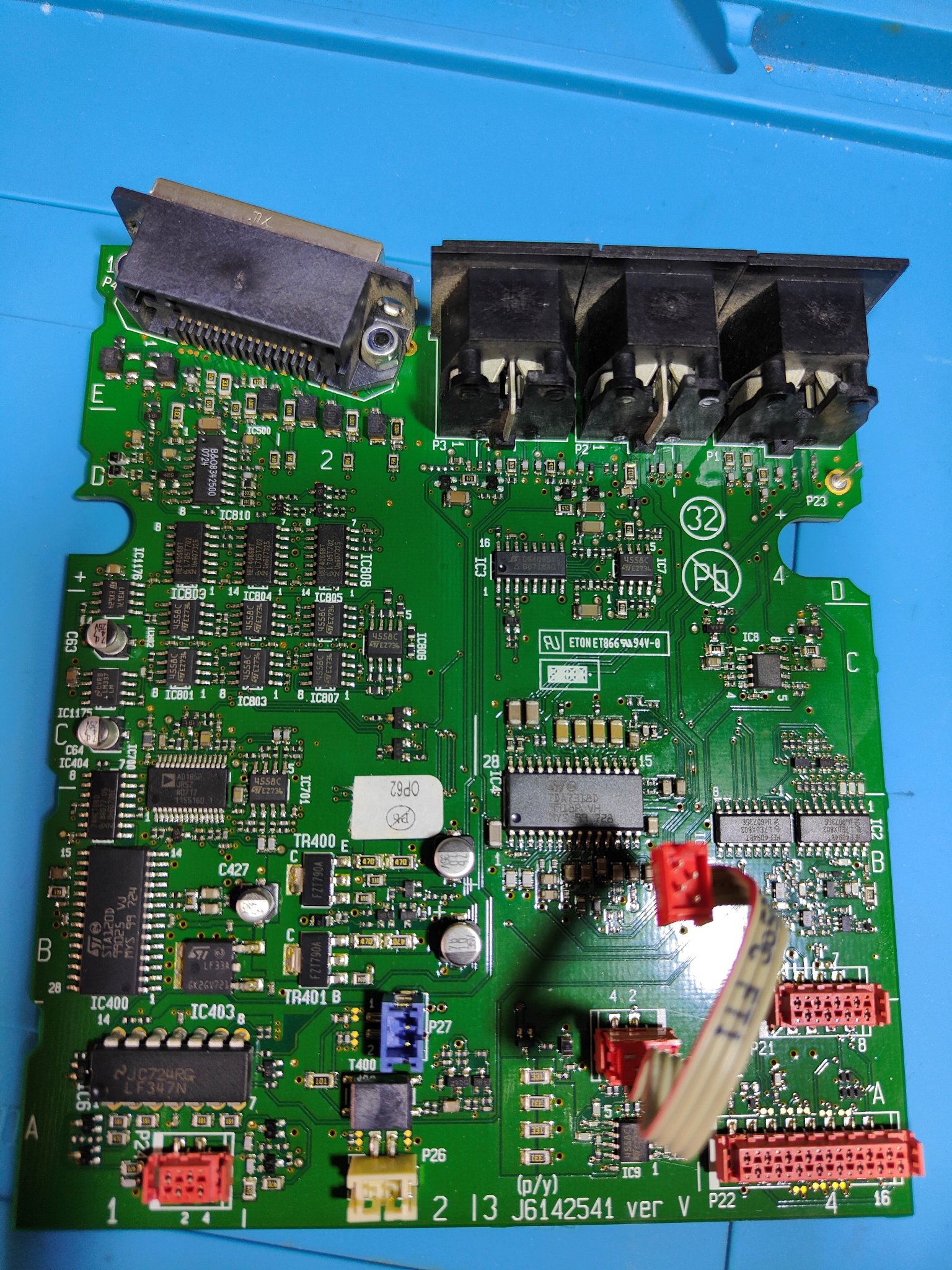

Hi Naresh thanks, this BS9000 Mk3 last new version (2010) all SMD parts, very few 5nos electrolytic caps but used in amplifier section, however I will check those caps and update. I have enclosed PCB32 picture

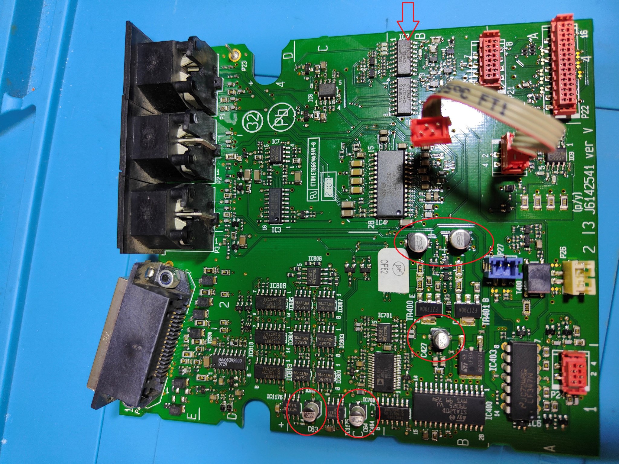

I had suspected PCB32 Input & output select, and sound adjust – IC 2 (shift & store register) HEF4094BT this IC control PL mutes. I have found in my local market D4094B (Chinese?) replaced, then I have more problems, now sounds distorted, intermittent no sounds in CD, FM & Aux in sound. I have ordered HEF4094BT (original) from element 14m and removed D4094B and replaced HEF4094BT, also replace 5nos SMD aluminum electrolytic caps 4.7uf 25V 3nos & 10uf 35V 2nos. My PCB32 different from Mk3 service manuals. As per Mk3 manual PCB32 Rev-N have lot of aluminum electrolytic caps, mine have version Rev- V has 5nos only. Then all problems gone. Rajkumar
