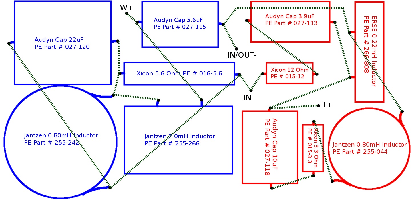

Good/bad?
I was thinking of wiring the crossover on top of the board like this, of course it limits inductor placement:
In addition to the parts list on the prior page I went ahead and ordered the Audyn Q4 caps for all remaining positions (just the 10uf and 22uf) per Wolf's advice. (I know he said the 10uf NPE were OK but better safe than sorry.)
Audyn Cap Q4 10uF 400V MKP Metalized Polypropylene Foil Crossover Capacitor Part # 027-118 2 $4.31 $8.62
Audyn Cap Q4 22uF 400V MKP Metalized Polypropylene Foil Crossover Capacitor Part # 027-120 2 $8.57 $17.14
Once these arrive late this week possibly, I'll cut up a standard hardboard-backed clipboard in order to make two bases for the crossovers. These will fit inside the Hammond project boxes. A clipboard is the cheapest thing I could find. 2 bucks. Better than buying a 2x4' sheet at Home Depot. 🙂 I'll hot glue everything and use zip ties on most parts except the resistors. I'm pretty good with a soldering iron so it'll be a fairly neat affair.
Any input about my crossover layout above is appreciated.

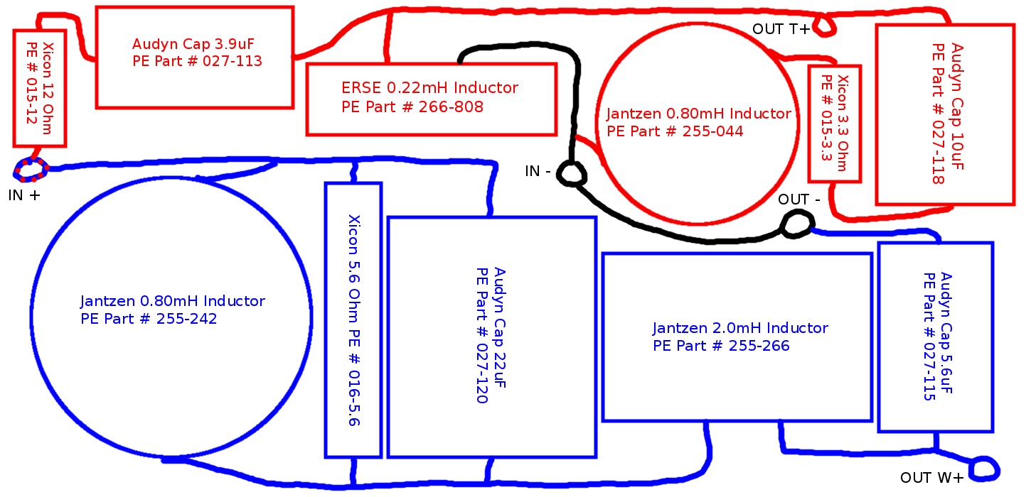

laying out the parts in reality now it looks more crowded than it did on paper so I probably should wire this crossover on the bottom side of the board after all. That means I should take another look at the layout to get the inductors more optimally positioned.
Finally an update.
I drilled the holes in a piece of thin Masonite (I cut up a clip board) and mounted the crossover pieces for one crossover board. I used zip ties on the heavier parts but the smaller parts I felt would hold on fine with just the soldering on the back.
Here is a picture of the top:
I then turned the board over and following the schematic posted on the first page of this thread I soldered the leads of all components together.
Here is a picture of the bottom:
Next step will be to use alligator clips to attach the crossover to the speaker binding posts and take some quick measurements to make sure it was put together more or less correctly.
If it measures more or less as expected based on the simulations posted on page one I'll build the second board and then work on drilling the holes for the binding posts in the project boxes wherein these will reside.
