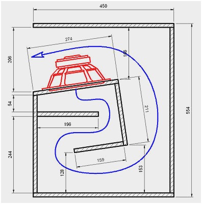

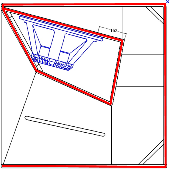

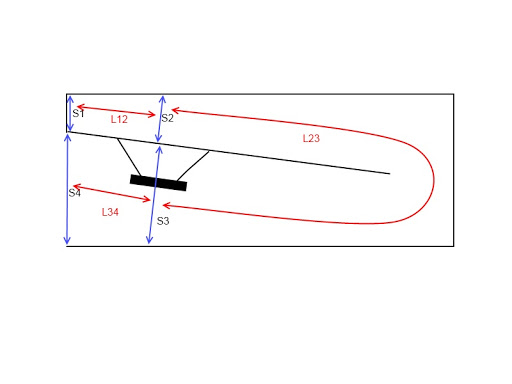

Front Loaded Horns (BP4) and Tapped Horns (BP6) are bandpass designs.
FLH is a BP4 with a positive flared port.
TH is a BP6 where the whole enclosure is 2 positive, 2 straight, or 2 negative flare ports.
Pic 1 is a FLH. Pic 2 is a single fold TH. Pic 3 is a double fold TH.
Notice the single fold TH is only 7 panels like a ported, vented, or bass reflex box.
