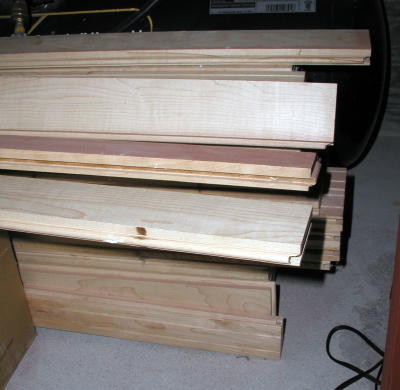

One other solution would be to do it like the real thing (Sonus Faber). They build it out of maple boards and I believe that material has something to do with the sound of the speakers. You could use maple plank they use for hardwood flooring. It comes in 3/4" thicknes and different widths (3" would be probably still easy to bend). You would have to soak the boards and then bend them on some kind of frame to required shape (that's what Sonus Faber is doing I guess). The boards are tongue and groove so putting them together is not a problem. You might even use 4mm MDF as a base or for even better result put another layer of boards over the first one. In my understanding that would make the ultimate walls for the speaker.
I don't think you'll find maple in Nevin's country
the maple sold down here for flooring (tongue and groove) is about 3/8" -- if you ever see an old house being torn down, grab the flooring! (you might just as well grab whatever other woods are in good shape from old houses -- like hardwood moldings. further, pine was used instead of fir in a lot of applications and you just won't find pine with the density in today's lumber-yards.) Down here in the states, at least in NJ, people gut houses entirely, right to the studs -- if you can believe it, they knock out the plaster walls and replace them with gypsum sheetrock.

Here is the pic of what I was talking about.
Hi Peter,
If I remeber correctly, the Beveridge ribbons speaker had a large cylindrical enclosure with a finish that looked as if it were made from that type of tongue-and-groove board. At over $20kUSD a pair, I would expect there was some sort of substrate supporting them.
Rodd Yamas***a
