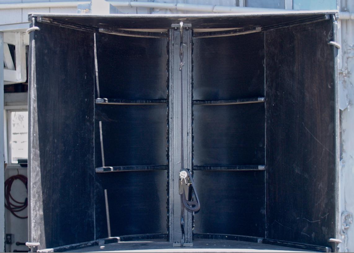

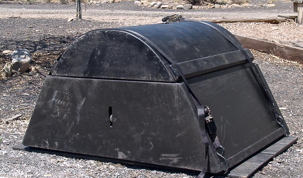

Pano,
Using basically the same approach as Mrk7 described in post #25 I also have laminated two pieces of 1/8" tempered hardboard for the Hyperboline hyperbolic curve:
https://soundforums.net/threads/7268-HyperboLine-%99-new-Player-in-the-Old-Game#post
The bent hardboard really makes for a stiff enclosure, and is pretty easy to get a consistent paint job, as there is no grain to hide.
Art
