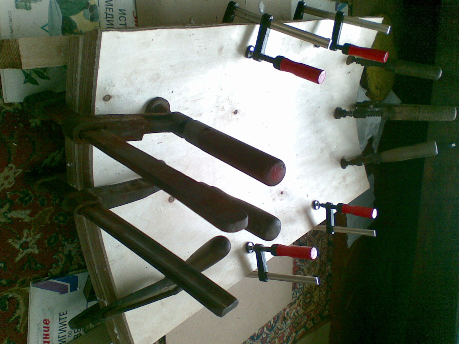

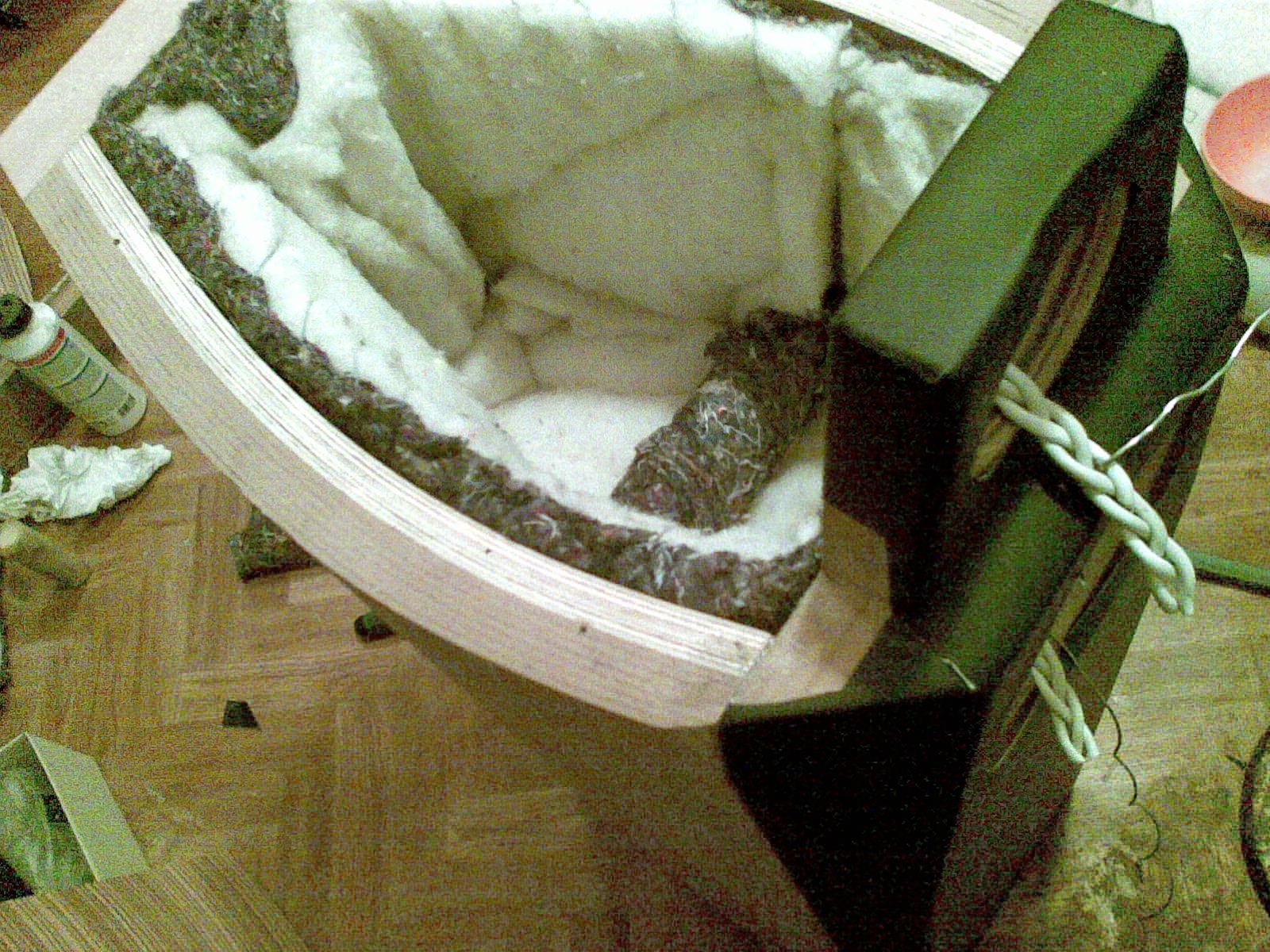

Why not make it of layers of 6mm ply? That's what I do.
I`ve done it in a project - used a gym bar to bend the plywood and warm water. Problems you`d encounter unless you use extra screw pressure as on the first pic:
- Glue will not disperse even inside the two bent planes leaving cavities
- No matter how you do it, if no restricting form is used, you will not have the panels match perfectly on the x-axis. I knew this would happen and made them larger than needed, then had them cut with a saw which also clears problem 3 ( next one )
- When you bend them, the edges of the speaker panel would be made of varying 90 degree forms ( toothed as the plane is warped ). To later attach the front and rear baffles, you`d need these cut.
The easiest way to accomplish this is to first build a bending press that would keep the material tight and would allow for greater pressure. Do not underestimate plywood - a 900mm/40mm/8mm sheet would support your own weight without bending that much ( fulcrums at the very corners ).
Second easiest way is to use thin sheets of mdf - I used 4mm on this one, and glue them together, then bend to the desired shape. Once polymerised, the glue would keep them from returning to their original, straight, shape.
