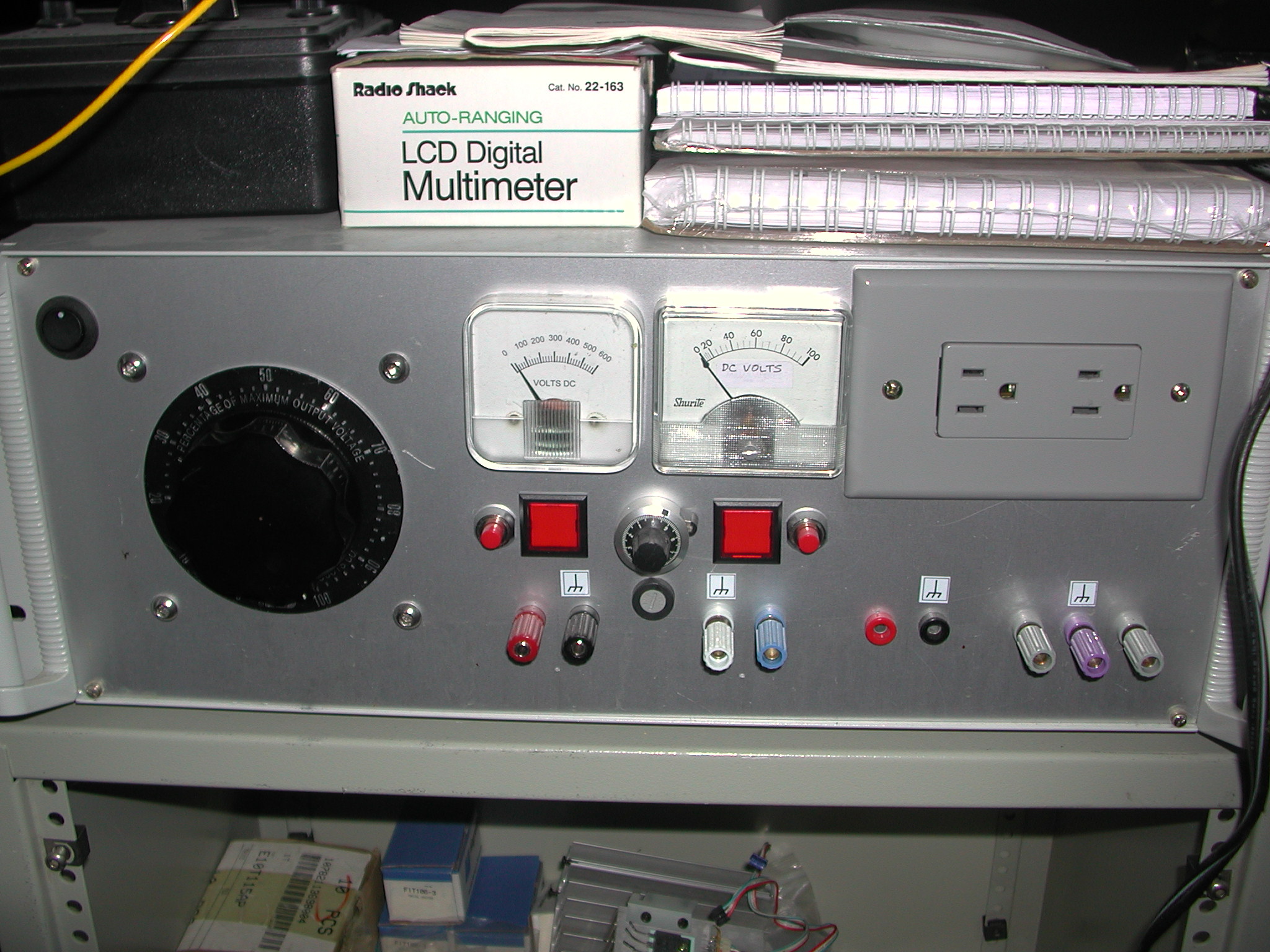

As for requirement, I need two plate voltages (one for output tube and one for driver tube), 2 or 3 low voltage sources for the heaters.
If you want to play with fixed bias, you'll need a -ve supply also.
I made my own basic setup out of leftover/scrap parts.
HV is a variac connected to an old 360-0-360 tube TV transformer through a CLC with 500V rated caps. IIRC it's good for around 150ma and around 450V.
-ve bias is a small transformer (around 44V I think) with a CRC filter and a simple pot to give up to about -60VDC bias.
The two square illuminated buttons turn on the HV or bias supplies.
A filament transformer that is 12.6V-0-12.6V with all 3 taps on the front panel to provide either 6.3 or 12.6VDC.
The variac also controls the mains VAC on the receptacle for powering up stuff slowly. That feature is used the most by far........
Low-Tech, but works fine for my needs.
EDIT: Here is a fancier one by Pete Millett.....tube regulated
http://www.pmillett.com/HV_bench_supply.htm

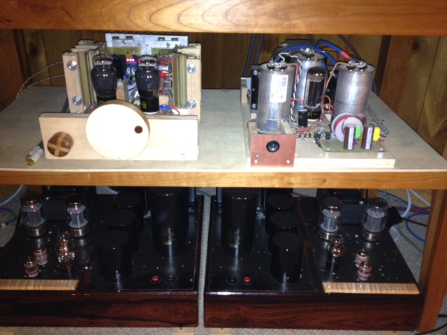

Let's say I build an amp circuit with bench PS.
When I am ready to build the PS for that amp, should I build the PS outside first (on plywood) or I can just mount all the PS parts in the final chassis then wire everything up ?
How do you guys approach from start to finish when building a tube amp ?

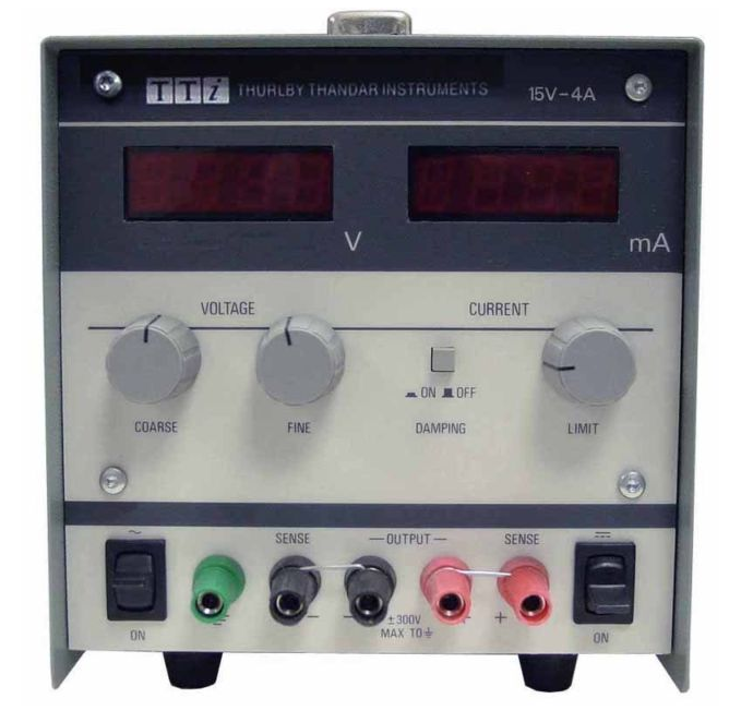

I have a few Thurlby bench power supplies - really like them. Big digital readouts for volts and amps. I use them all the time. I have a couple supplying my DHT output stages (4P1L PSE) right now, and they also sound good. They commonly come in 30v 2A, or 15v 4A so I have some of both. Bought them off ebay and they've been ultra reliable.

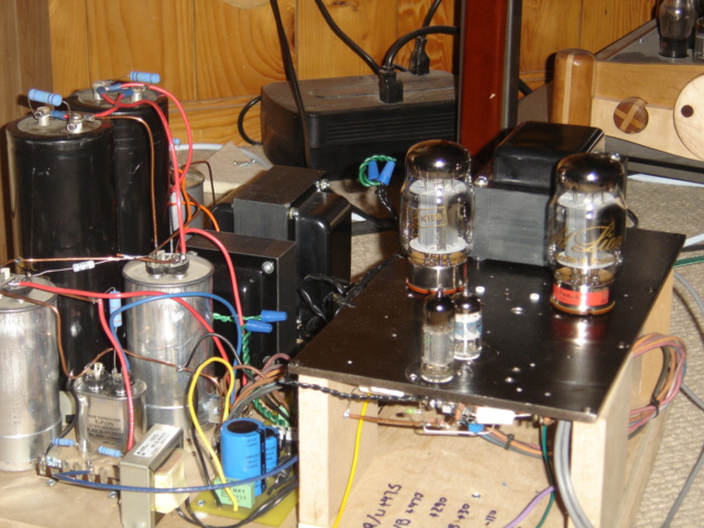

I build on a piece of plywood, tweek till I get it where I want it and then put it in a case. Simulations are good up to a point. The top shelf is a 6v6 bootstrapped preamp and its power supply sitting next to it. Underneath are my Modern Mullards or OPUS's. (initially built the same way. as seen in the second photo.
Not a good technique with kids and pets. But works well in a lab as it is easier to get measurements and change parts.

You can build it out on a piece of plywood and use a resistor for the load of both channels (if you are using one supply for both channels). Adjust until you get your voltage right and then rebuild it into whatever chassis that you want, either wiht the amp or in a separate case.
The thing to remember is if you have to add dropping resistors for your PS on one channel, then you have to change your PS before it will work supplying two channels.
For instance if the resistance of your circuit for one channel is 5k and you design your PS to deliver voltage at that resistance (or current draw), then you would need to change it before using it to power two circuits like that. Make sense?
