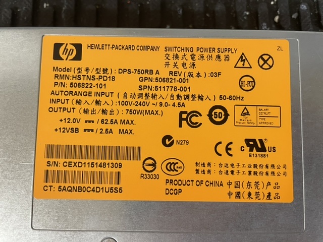

I'm looking for any information/help, or even a schematic for HP HSTNA-PD18 power supplies. Hewlett Packard doesn't seem to offer. I did find a schematic for the HP HSTNA-PL11 (PL11 version) supply but it is quite a bit different. I'm trying to raise OVP over volt protection so that I can run the supply at 14.5~15v. On the PL11 version PS, there is a way to do this, but PL11 supplies are about 4x the cost of PD18 supplies.

I've moved to testing HP HSTNS-PD05 supplies which should hopefully be stable up to 15vDC without recapping them. Each supply also has 2 cooling fans which is a good idea. They're rated for 1000w too, which should put out about 65A at 15vDC if this all works out. In parallel I'm aiming for 500A. I've got 8x units on order. I'll post photos of the build and how this all works out.

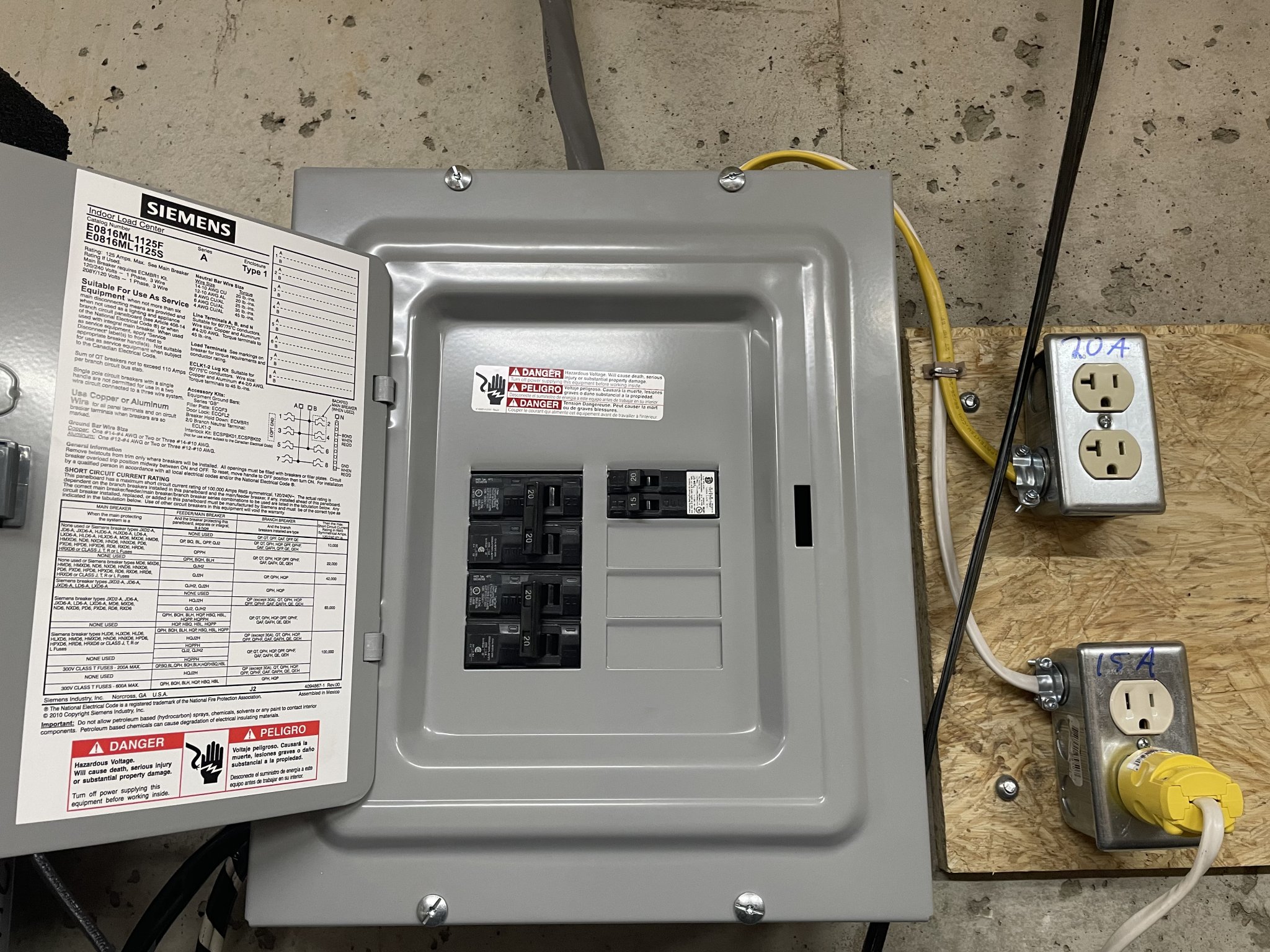

For supporting power, I'll run a 50/55A breaker from the main to an 8/16 block subpanel. 50A breaker supported by 6-3 Romex which I already have (Saves cost, should support 500A@15vDC). Future maybe upgrade to 4-4-4-6 SER or 4ga THHN wire (~100A service). House has 200A service.
In that secondary panel I'll have another main, or main breaker, or main shutoff latch/lever. Inside the box about 4x 15a 220v breakers.
Each breaker will support two power supplies at 220vAC. The PSs are rated for 6.7A 220v, so two will draw about 14A in tandem. Space for adding supplies later on.
For the connections from breaker to supplies, I'll use 1-to-2 220v 'PC' style power splitter power cables. Chop off the male end and tie straight to the breaker and ground busbar (3 wire).

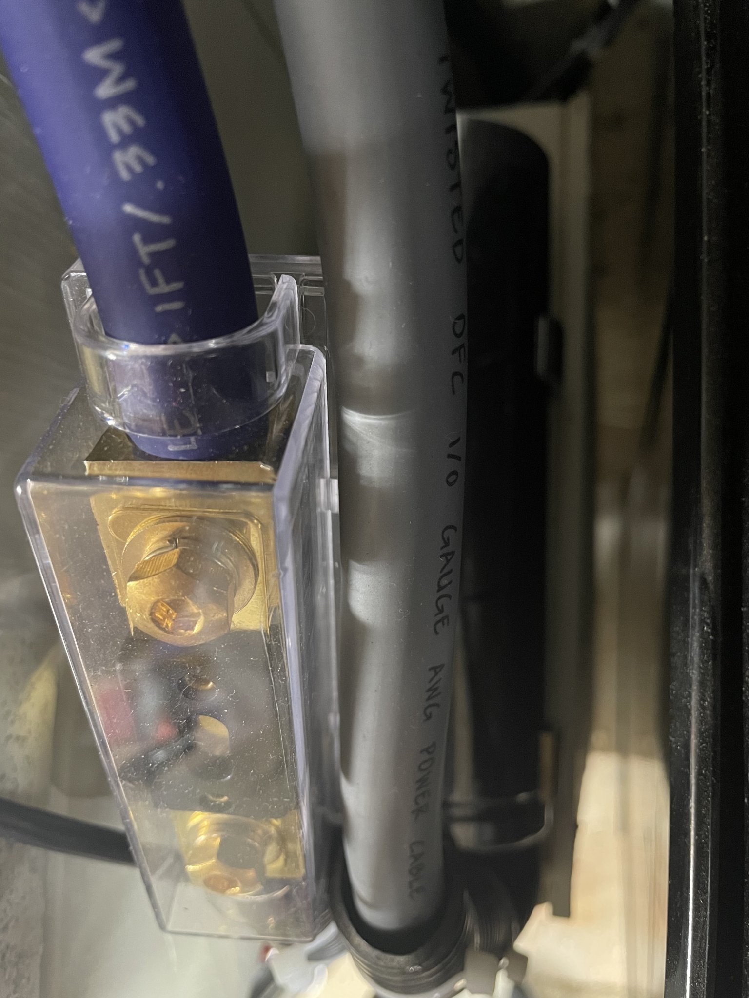

DC output pins of the PS; I'll likely mount terminal screws tied to 8-Ga wiring, short run through 60A fusing for each PS, connecting to a collective busbar, then crossing that busbar to a secondary bar over much larger fusing, say 2x250A fuses. I'll make my own bars probably out of 5/8" mild steel. I'll also install a spare 2Farad cap I have, on the PS side of the positive and negative busbars. The 2Farad cap should actually help the PSs with spikes and overcurrent jolts; as I'm understanding these supplies fair poorly with fast instantaneous changes (They can shut down as way of protect based on instantaneous demands).
From the secondary/collective busbar I'll run 2/0 or 3/0 to the bench terminal blocks. From the bench terminal blocks I'll have smaller breakers/fusing ratings for final amplifier testing (Provide max rated/suggested fusing for amp, and then out to the amplifiers I'm testing, with rated fusing.

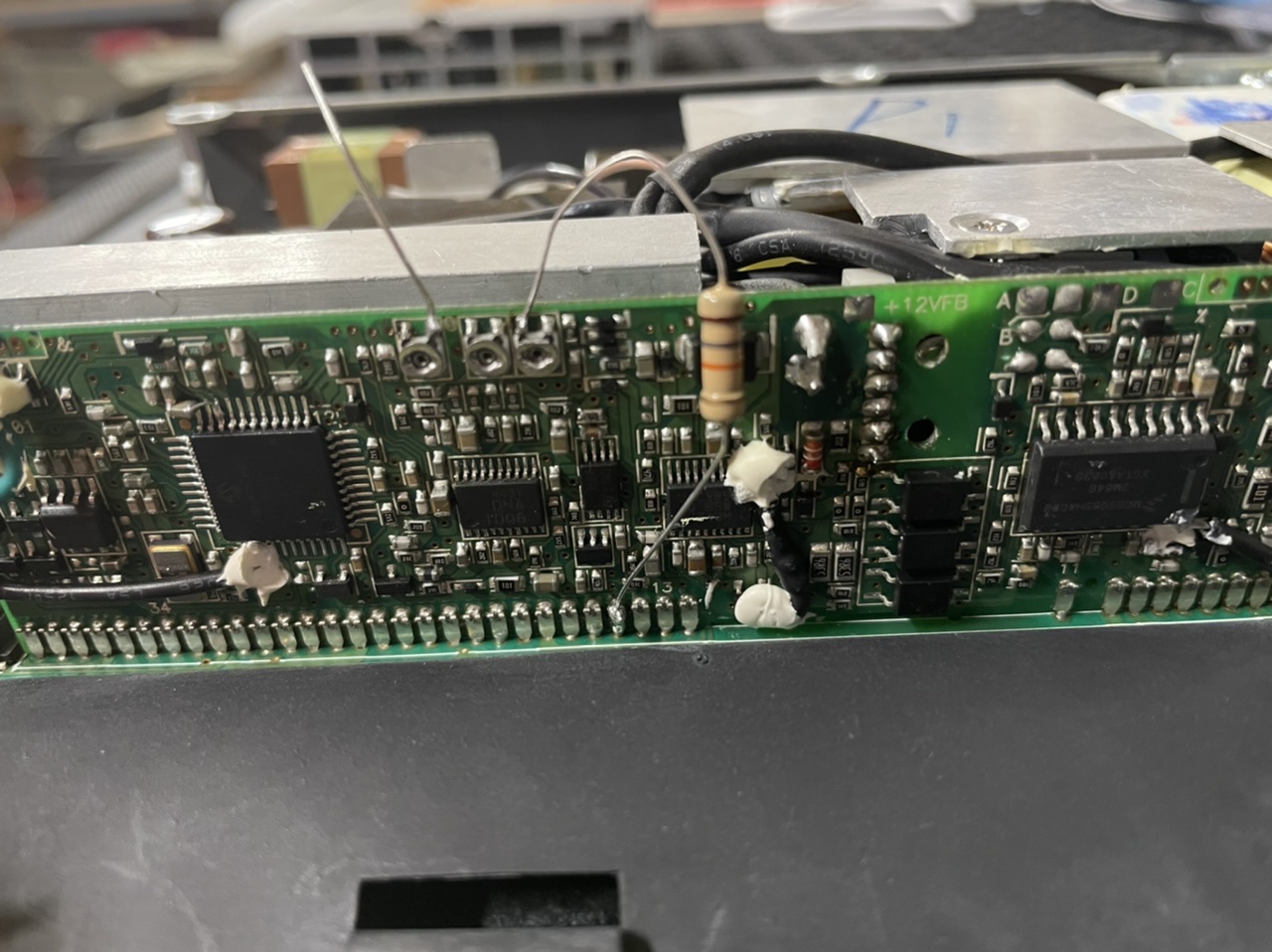

The first DPS-800GB PS has been modified! After disabling over voltage protection, I then put a 2k pot between ground and pin 32. I was then able to adjust output voltage to about 14.7vDC. I then did load testing; and found the PS only dropped .5v at 50A draw on 110vAC main. Thats with 4-gauge wire at terminals, and measured at the load.

I bought 2-2-2-4 SER wire, breakers, new breaker box, etc. Plan on hooking these up to 220vAC still with 2~3 per breaker. Will see. If these PSs dont work out I'll have to get something else.

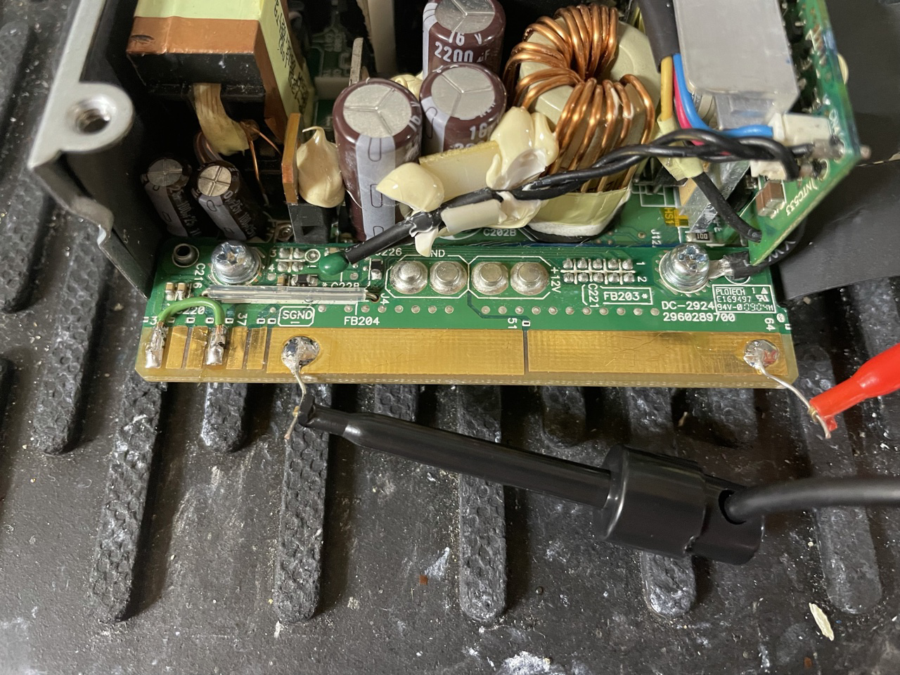

Here is a photo of two DPS-800GB PSs showing external modifications.
1. 4ga wire soldered to positive and negative output
2. Jumped pin 31 to pin 34 (Tricks PS to turning on)
3. 2k Pot between ground and pin 32 (Adjustable output voltage, I set mine to 14.5 on all PSs)
4. LED on pin 36, connected to a 1k resistor to ground (This is part of the PS's internal 5V circuit, and just lets you know the PS is running and outputting across the 5V circuit) -Optional.
5. Final step - tie all tandem PSs together at Pin 30. This is for load sharing. ***STILL NEED TO TEST FOR MORE THAN 2 IN TANDEM***
For internal modification, follow the first half of this video found on youtube: DPS-800GB Full Hack Including OVP Hack - YouTube
- Essentially, one of the legs of the OVP IC needs to be clipped off the board. Takes about 5 minutes to do.

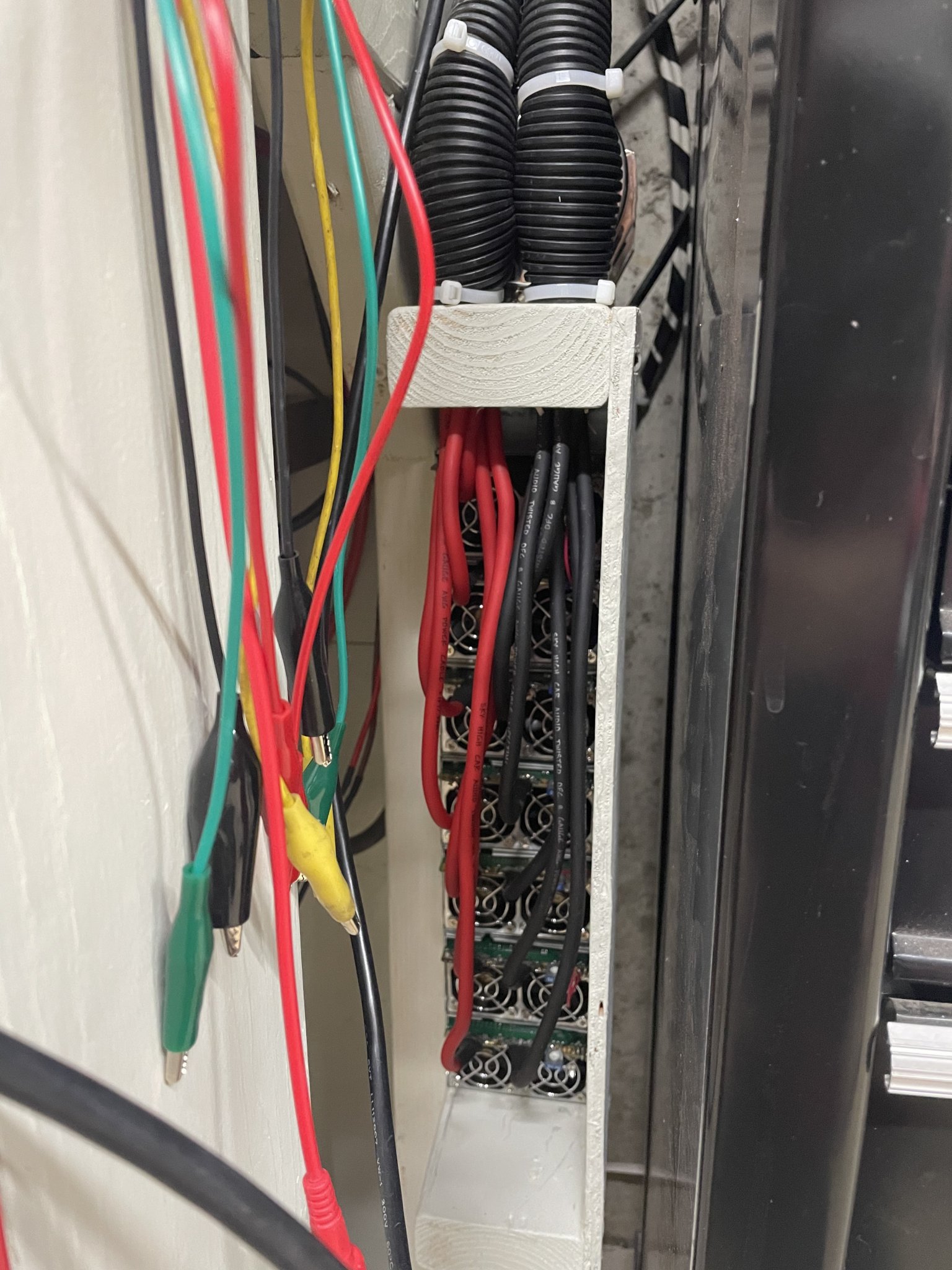

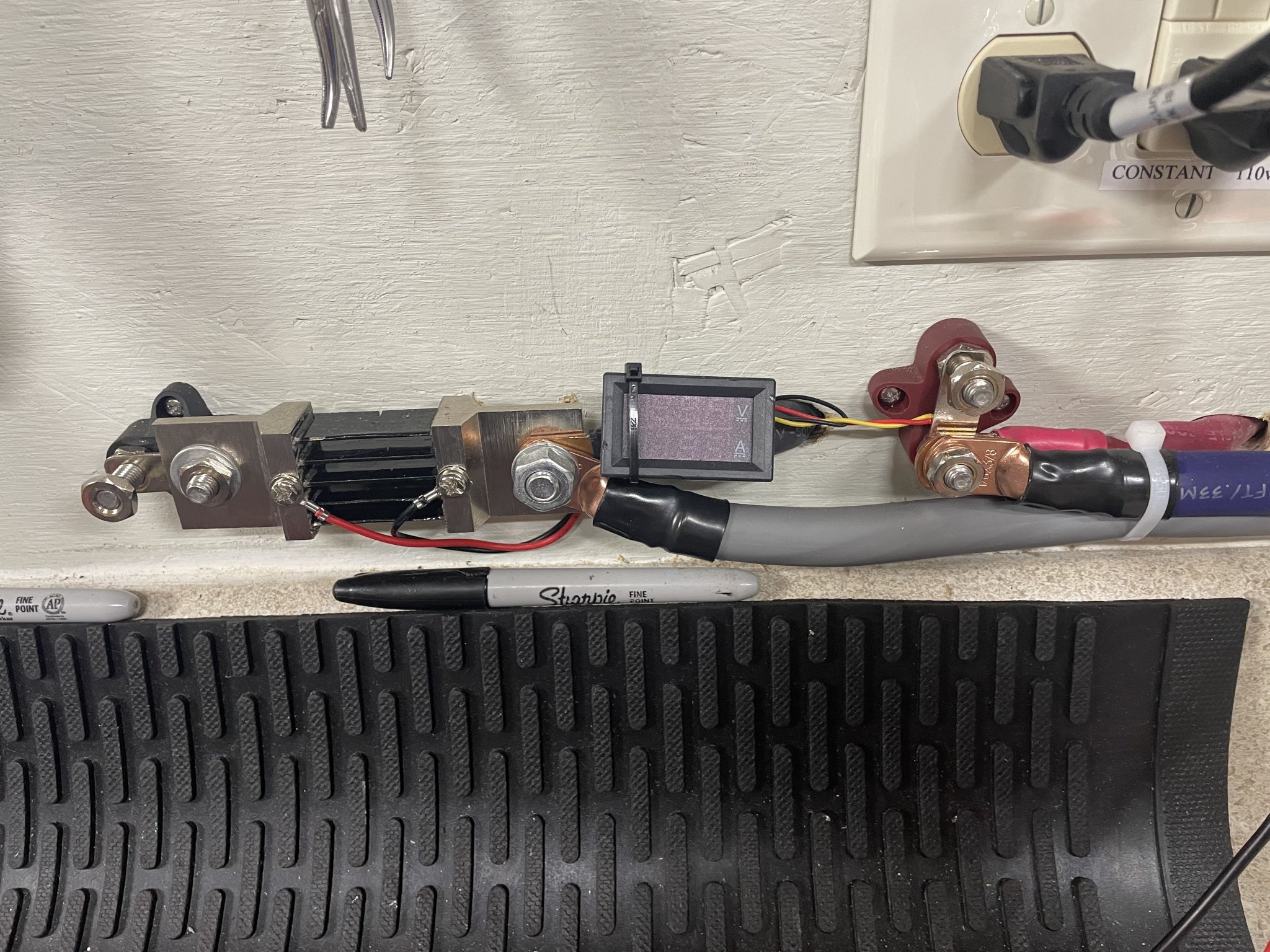

~1 month update. I was able to wire-in all 7x DPS-800 supplies at 220vAC. 3 PSs are connected to one 20A breaker, and 4 PSs to a second 20A breaker. 14.4vDC output is carried across 8ga wire, which I believe is instrumental in creating a slight voltage drop. The supplies are hooked up in tandem where I can, but only 1-to-1 monitoring. The rest is handled by voltage drop. Just after the PSs, I installed a 1.5Farad cap I had on hand. This cap is ALSO instrumental as it provides quite a buffer as the PSs are switching/balancing around. Also at the bench I have an 800cca Pb battery also backing it all up. When ramping up, I can hear the PSs switching about as they do their balancing acts. They dont come up cleanly all-together but its the best I can do (For the money!)
On the downside, the setup will faulter/fail if I ask the bench to burst out ~200~300A. The PSs are not fast enough to switch/balance really. What I have to do is turn my knobs a bit more gradually invoking a steady increase in pull. I tested the setup out to 400 Amps of draw, and it works! I could have gone more but I currently dont have a device to load it down further.
I ran short 0/1 gauge through a 300A fuse then through a 500A shunt resistor which displays vDC and amperage. It works too.
Total spend ended up at about $300 which includes the breaker box, 2-2-2-4 SER wire, and everything else. Some stuff I had on hand. Not bad considering the next option was going to MUCH more expensive.
