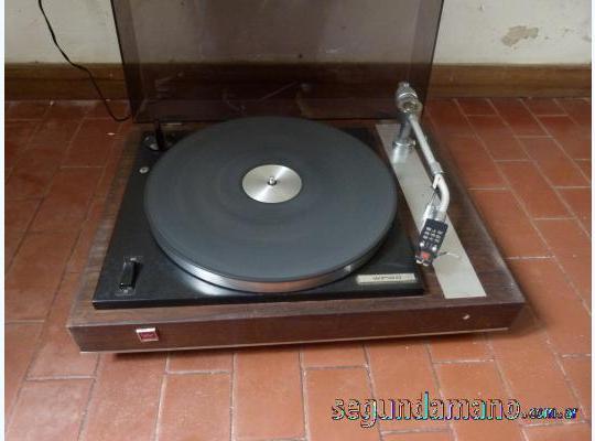

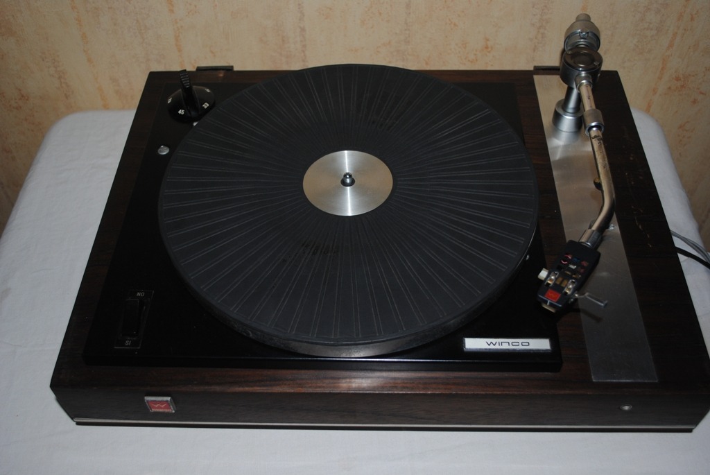

My father has an old Winco turntable, and uses asychronous AC motor, and still works pretty fine, including the strobo test.
