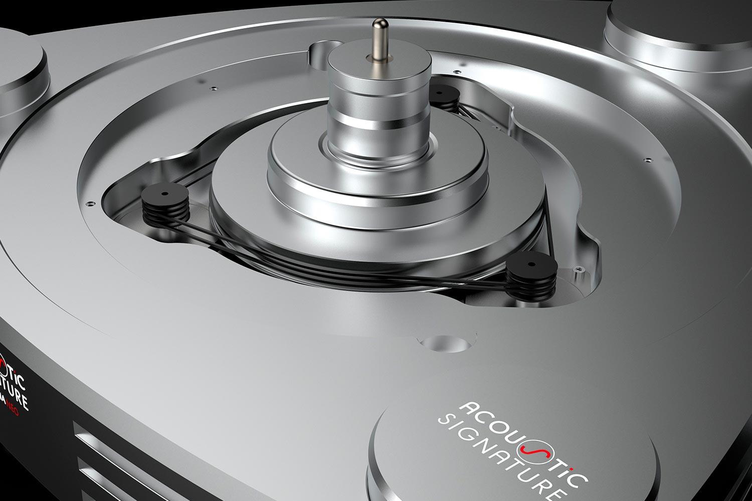

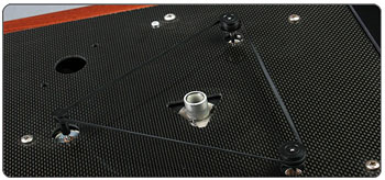

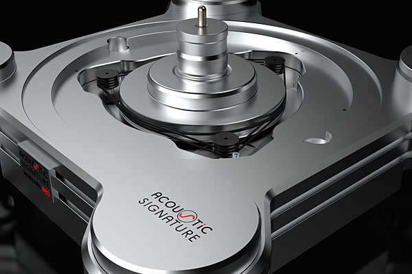

By accident I discover on the web this 3-pulley belt drive turntable - a good approach to avoid a general disadvantage of belt drive turntables:
Funk Vector Link Turntable:
https://www.enjoythemusic.com/superioraudio/equipment/0808/funk_vector_link.htm
under
https://web.archive.org/web/20080216232158/http://www.thefunkfirm.co.uk/V_Link.htm
I read this:
The VECTOR is the ultimate solution to the problem of motor pull. It is a 3-pullley drive system that is fed by an ironless rotor (low mass to you and me) DC motor that is mounted on the sub-chassis with the belt tension force then distributed about the sub-platter via 2 passively driven slave pulleys. These patented innovations are unique to Funk.
A similar approach was realized by an other brand which I have seen several years ago (maybe VPI industries - but I am not sure) - but the slave pulleys at this belt drive device are located outside from the platter.
check out more images (Linn SONDEK LP-12 mod to a 3-pulley drive system) in post 160 under
https://www.diyaudio.com/community/threads/linn-sondek-diy-mods-that-work.272570/page-8
more URLs:
https://www.hifinext.com/acoustic-signature-unveils-new-generation-of-neo-turntables/
https://www.stereophile.com/content/acoustic-signature-montana-neo-turntable
https://www.acoustic-signature.com/products/turntables/invictus-neo/

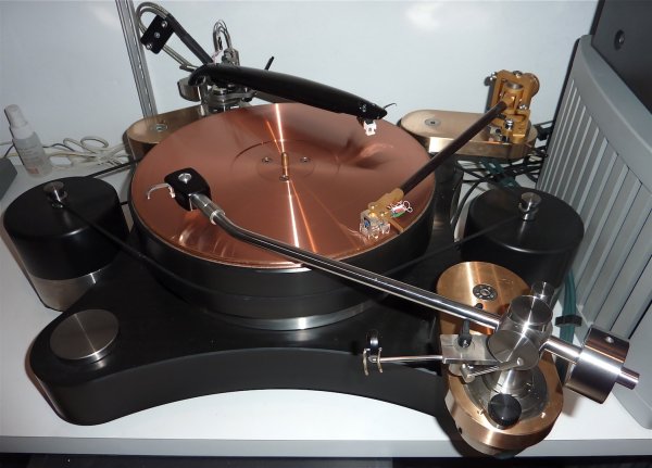

Hi, It's all about trying to overcome the stretch and slack of of the belt system. So here it will happen 3 times, but to a much lesser exstent than on a conventual system.
I prefer using a known none or shall we say greatly reduced belt stretch of Mylar tape to drive the outer perimeter of my T/T. There are many means to an end.
Cheers
Cheers
