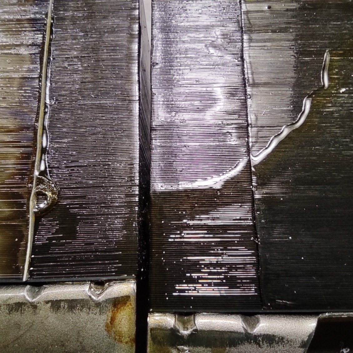

i fund defects on these transformers, some have no sheet gap, so wen pushed become magnetised nothing else
so open it put a shim gap reassemble and for demagnetise thems the best its to send 6V3 from one power transformer (mains 50/60Hz)
by +- 1ohm 10W resistor to reduce current on bel canto secondary 8ohms , take a drink , its done
transformer back alive

yes the last time i've got one bel canto output transformer loose power and start hyger primary current just wen i was checking the amp, on oscilloscope i see the transformer to said BYE BYE !!!
so i repace bothand sell the amplifier
but i start co check waths goin on ,so i unscrew both transformers , the one bad working was without shim gap
afther put a gap was working but poorly, so i demagnetise , firs by 240VAC on primary and secondary loaded, still low inductance,
so i do it in the other way, 6V3 on secondary by 1 ohm resistor, at first current was hight but rapidly decreased
the end, transformer works perfectly
