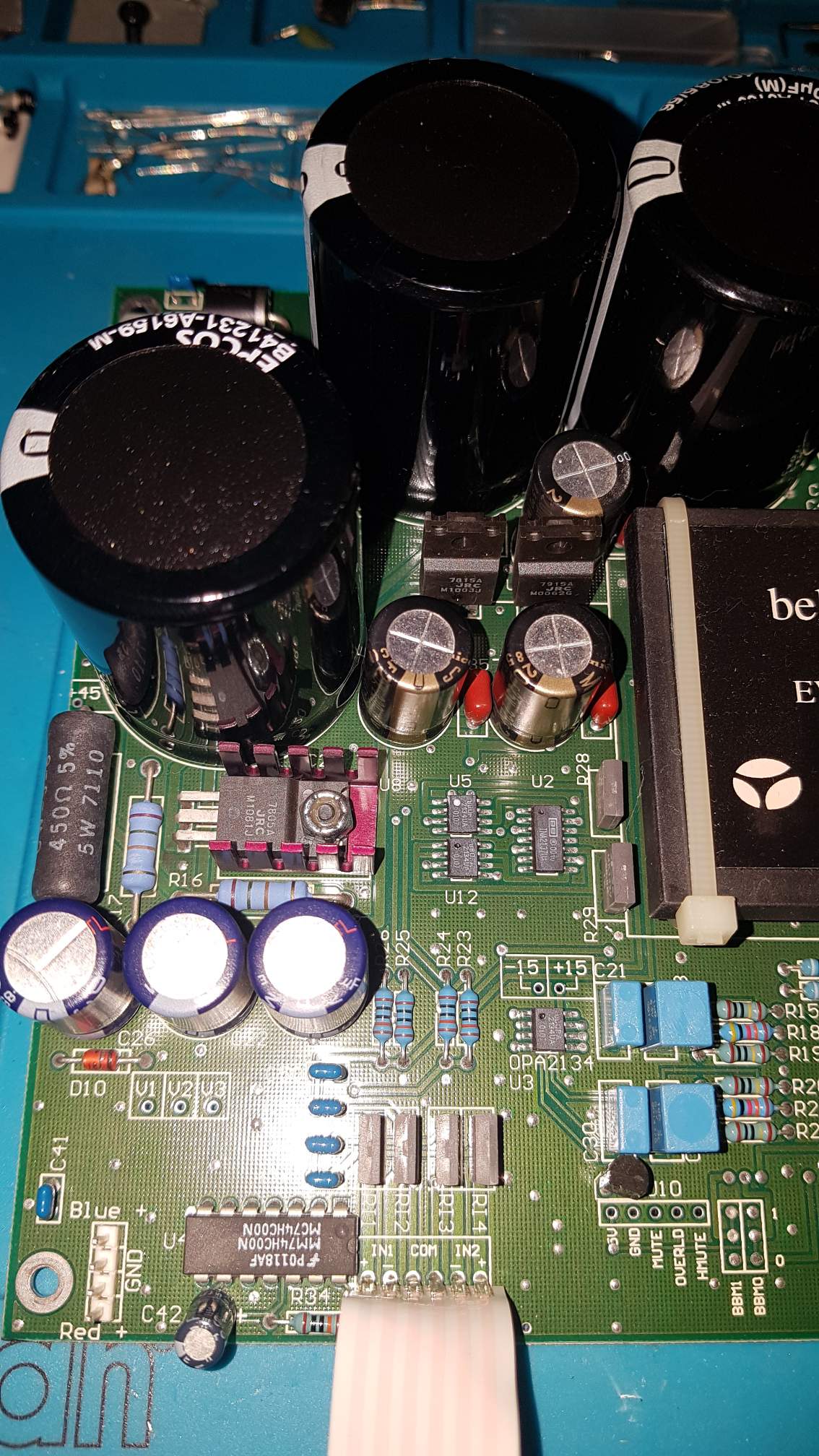

Under the bel canto sticker it's say TA0103A. Dc can be stable for some time, and suddenly it makes a very short increase in dc and makes small popping sound i the speaker.

You just replaced caps, and was working fine before? I would resolder those caps. One bank of caps on your bad channel could be culprit ... Or a bad cap.
I didn't try it very long after recap. I measured all caps before soldering. Can try resolder the caps first.You just replaced caps, and was working fine before? I would resolder those caps. One bank of caps on your bad channel could be culprit ... Or a bad cap.
Xmas holiday over😁. And time to do some soldering. I have resolder all big power caps, and still the same popping from the leftboard, ch1 and 2. I don't have dual scope right now, and used my single. Channel 2-4 shows 5 too 5,5 mV dc under testing.
But ch1 shows 0.000 on the dmm, soon as i hookup signalgenerator and scope it shows 2.2 Vdc. Not good at all.

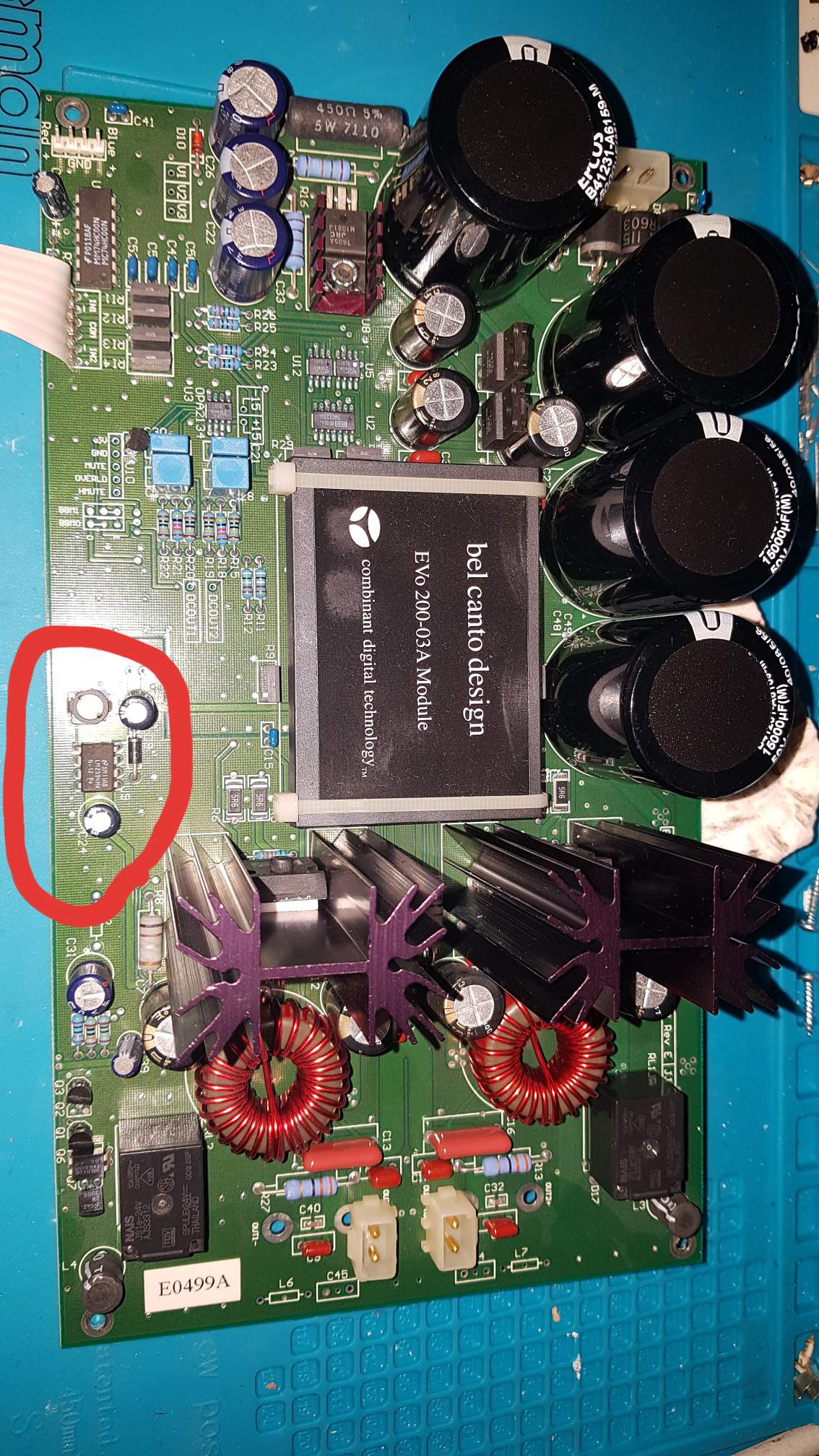

There is now adj pot on this board, but in the red circle there is a lm2594hvn-12 voltage regulator. The output pin are connected to the speaker + terminal. I think this one has something to do with the dc offset.On one of my ta2022, to adjust the offset it looks like a blue rectangle with a brass screw on the top ... Variable resistance.

Theese 3 220uf caps, next too the transistors are way out of specs. The are between 65uf and 82uf. So full recap of the whole board is now done.
Other caps was also low uf, og high esr. Hopefully the Tripath chip and other chips has survived theese poor condition.
