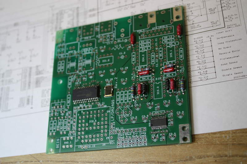

I've finally begun to stuff the board. So far so good. After I got the SMD bits on I put in the resistors for the output section. I used PRP's where I could find the right values, an then cheap metal films otherwise.
I'm perhaps getting a bit carried away with the snakeoil, but I picked up a pair of Blackgate F's and then I realized I needed four. :xeye: Too pricey to buy just another two, so I ordered a whole set of Elna Certifine caps, and a set of Similic II's. I'll use them all, but I'm not sure where yet. I also got a bunch of Nichicon ES's for other places on the board.

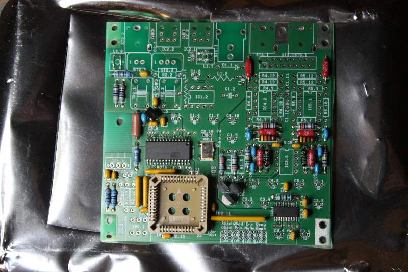

Made some significant progress this weekend. I miscalculated the value for the 100n capacitors as 0.01uf when it should have been 0.1uF. Luckily I had a bunch, but I also ran out so I need to order more. Also I forgot to order L1.2 (100uH) and L2.1 (47uH). They're Common Mode Inductors FYI.
I don't know if the small transistors I got have the right pinout. I know they're the right model, but I guess I'll have to learn the hard way. :xeye:

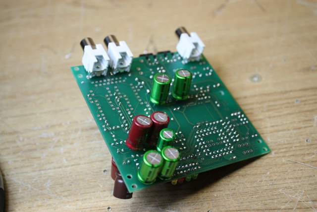

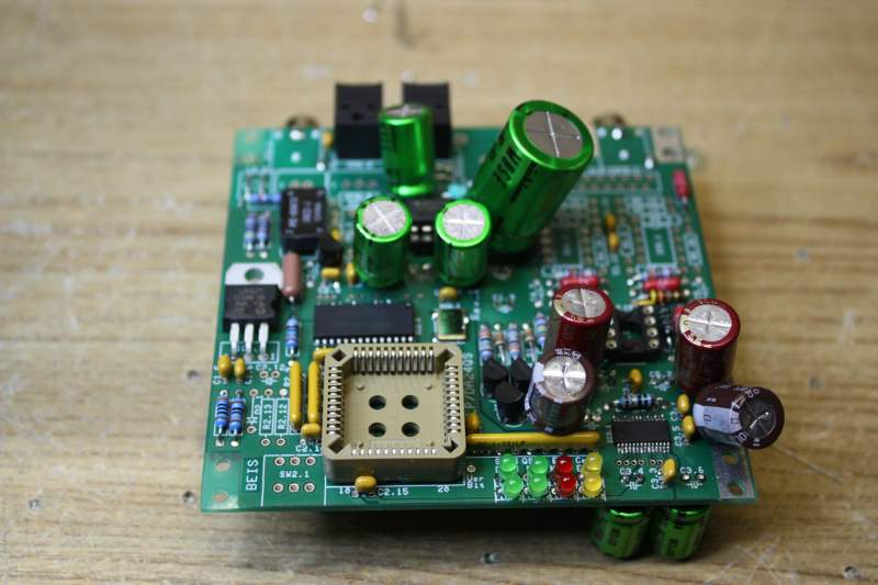

Almost done. I'm just waiting on the metalized polypropylene caps to arrive. Obviously the caps are way too big for the board. I used Elna Certafine's for the output coupling caps for the pre-opamp filter. The RCA jacks I used had to be under mounted in order to fit. Otherwise they are a cheap solution. I don't have a jack for the power supply, so I think I'll just rig up something. I'm not sure what is + or - though.

I got it all stuffed and was able to do a smoke test this evening. I used a 12v 500ma wall-wart that was putting out about 13.5v under load. A couple of the LEDs came on. The Single Speed, Pro, Copy, and Emph lights came up. That doesn't seem right.
I don't have the Elma swith spec'd in the BOM so I used a jumper to select channels. I tried all the inputs. No sound.
I've been troubleshooting with some help and I think 2 problems have been identified.
I had a solder bridge on IC3.1 that I fixed today. It was in essence dumping the ouput of IC3.2 to the ground.
IC2.5 seems cooked. I've got an unprogrammed spare, but that won't do me any good.
